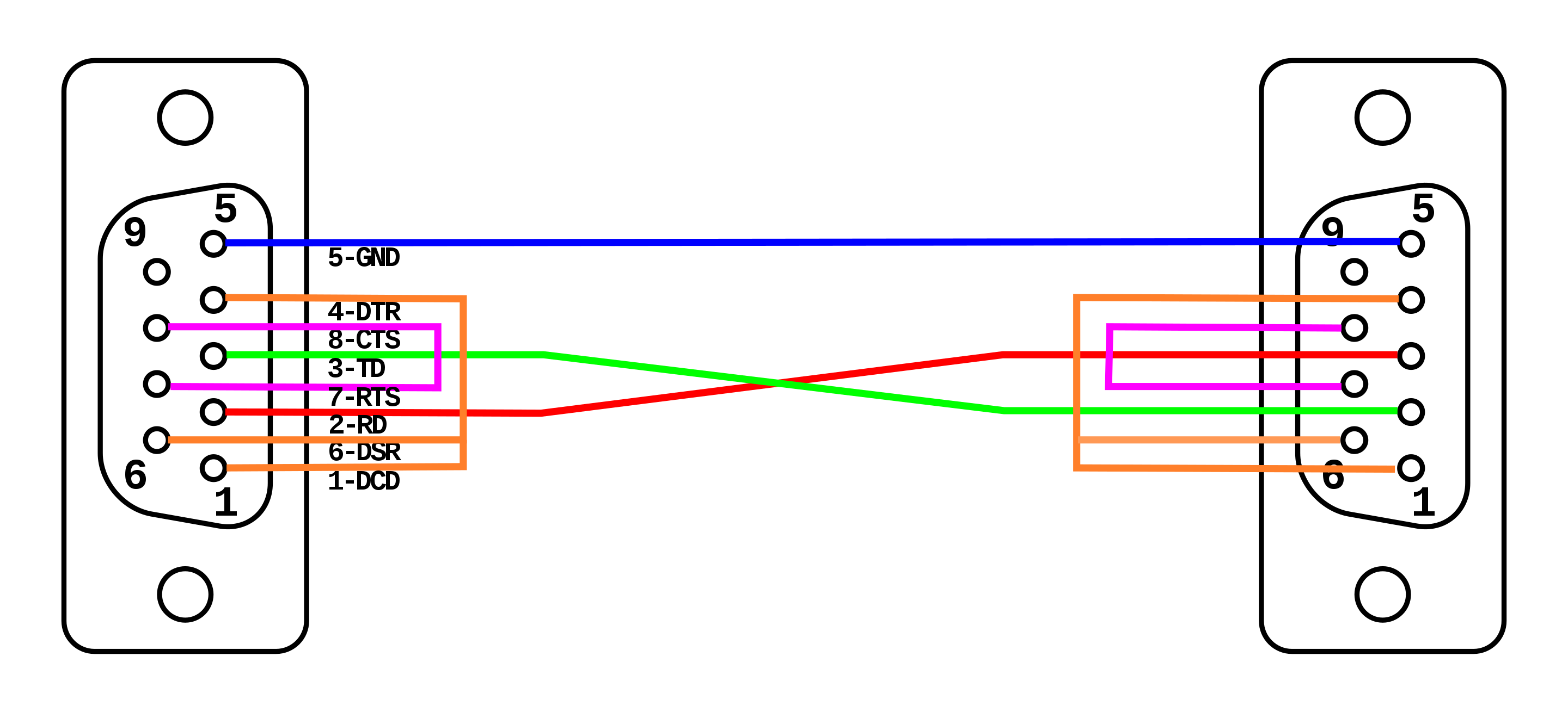

To use a terminal emulator to figure out what is really going on, you'll either need to provision two serial ports on your PC, one for the amp, the other for the terminal emulator, or you'll need to get another computer with a serial port. There is also a third choice involving virtual serial ports but I'm not sure you want to go there, but we can if you like.
The two serial ports will need to be connected using a null modem cable. Here's a wiring diagram. You probably only need to support the red, blue and green connections:
You will need to install a terminal emulator app. I very much like MobaXterm, but there are many choices.
Configure the terminal emulator with the same baud rate and other parameters you are using with the amp. Then you'll be able to see what Thetis is sending to the amp when you click the buttons in question.
