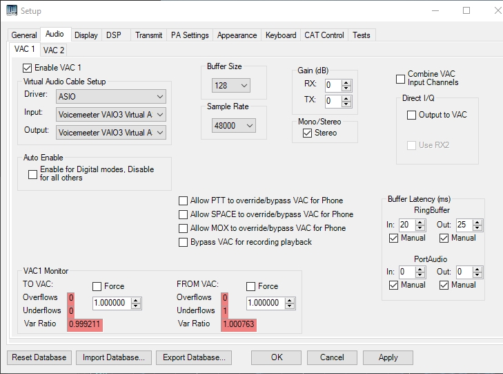

I am using VAC. Setup see screenshot.
I experimented already with Ringbuffers, but with no success.

Whenever you change any setting in the VAC control panel it will reset all VAC operations. This is why changing the sample rate works. However that is an ugly way of performing a reset. It is better to cycle any of the four manual checkboxes so that the rest of your audio system does not have to deal with changing sample rates.
So now the question is: why do you have to reset VAC after a TX profile change?
This begs another question: are all VAC settings identical in all TX profiles you are using? If not, then they need to be, and they need to be correct, too. This is because VAC settings are saved as part of each TX profile.
I did notice that in your earlier thread you said you were using a buffer of 256 with the Presonus. In this thread your screen shot shows 128. With luck this is the problem and the solution will be simple: just clean up the settings and resave each profile.

re Buffersize: I have 128 in presonus, VMP and Thetis.. so all at the same buffersize.
I have now adjusted all VAC settings in all profiles. In the FT8 profile I had different settings for the ring buffer size.
Since the problem is sporadic, it is difficult to determine what exactly is causing it. I can switch profiles 10-20 times without a problem. But sometimes the problem just arises.

I also see this sporadic problem here. It is a problem with VAC initialization. Other than going to a much larger buffer size across the board it is likely that you will not be able to solve the problem, i.e. it is not anything you are doing wrong, or can fix, it is a bug in Thetis.
