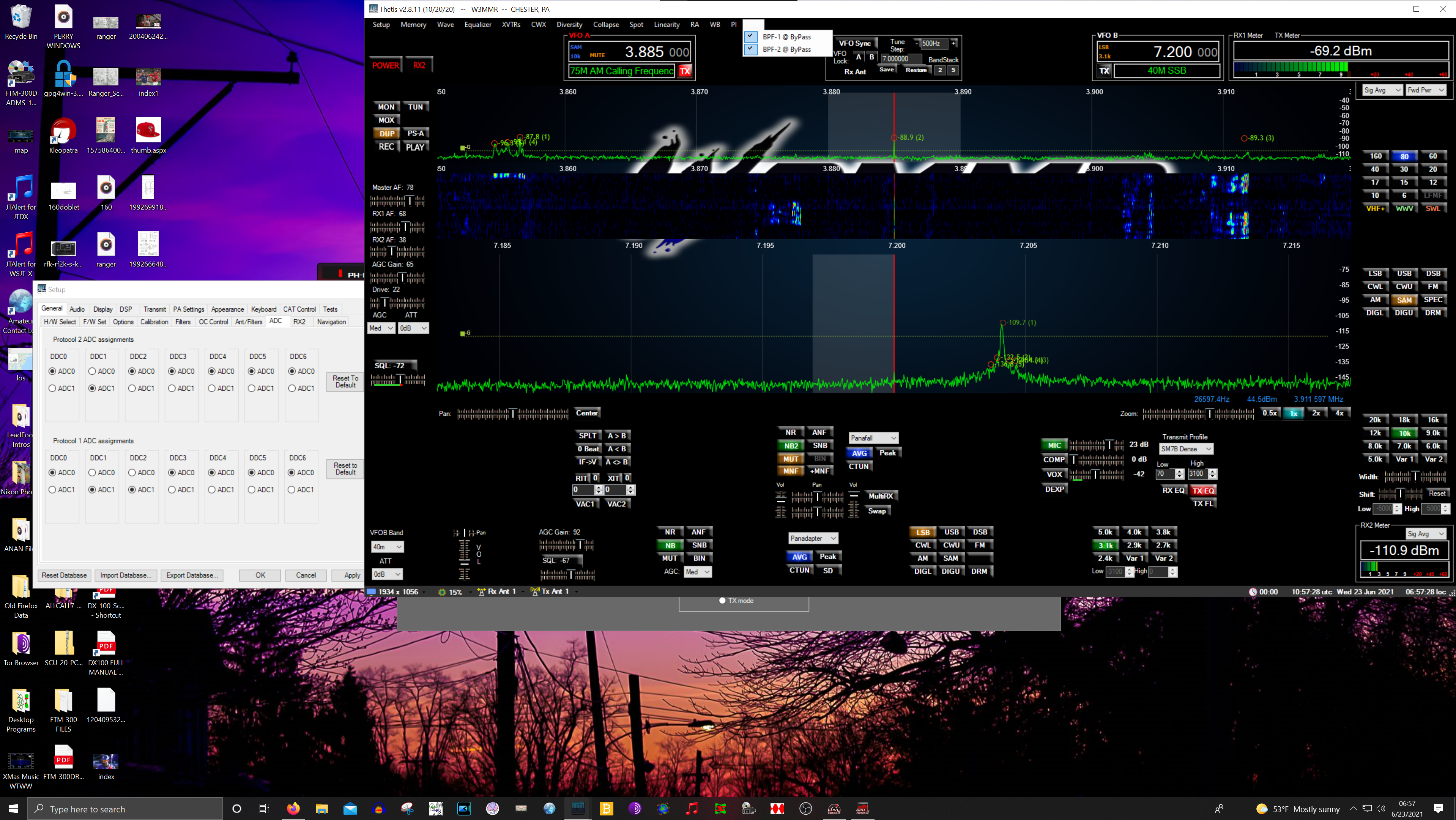

I know you said that you put all filters into bypass, but please post a screen shot of your filter settings when in the RX1:80M and RX2:40M with both on ADC0. Please also post a screen shot of your ADC settings under those same conditions. This is just to see if there's anything missing/left unsaid, as unlikely as that might be.

Here ya go.
Screenshot 2021-06-23 065829.png (4.48 MiB) Viewed 7568 times

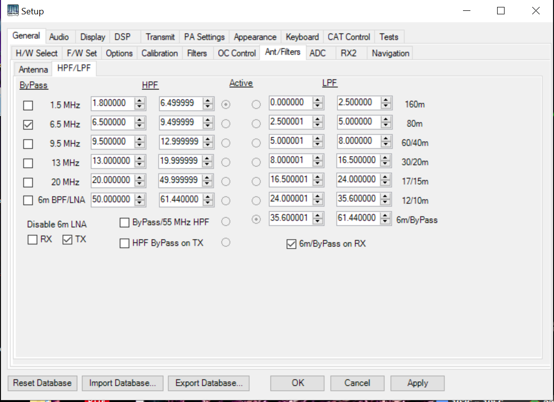

I figured it out Scott. In the HPF/LPF tab, I did NOT have 6m/bypass On RX checked. I do now, and things are normal under the same band conditions on VFOa and VFOb. Here are my current settings...

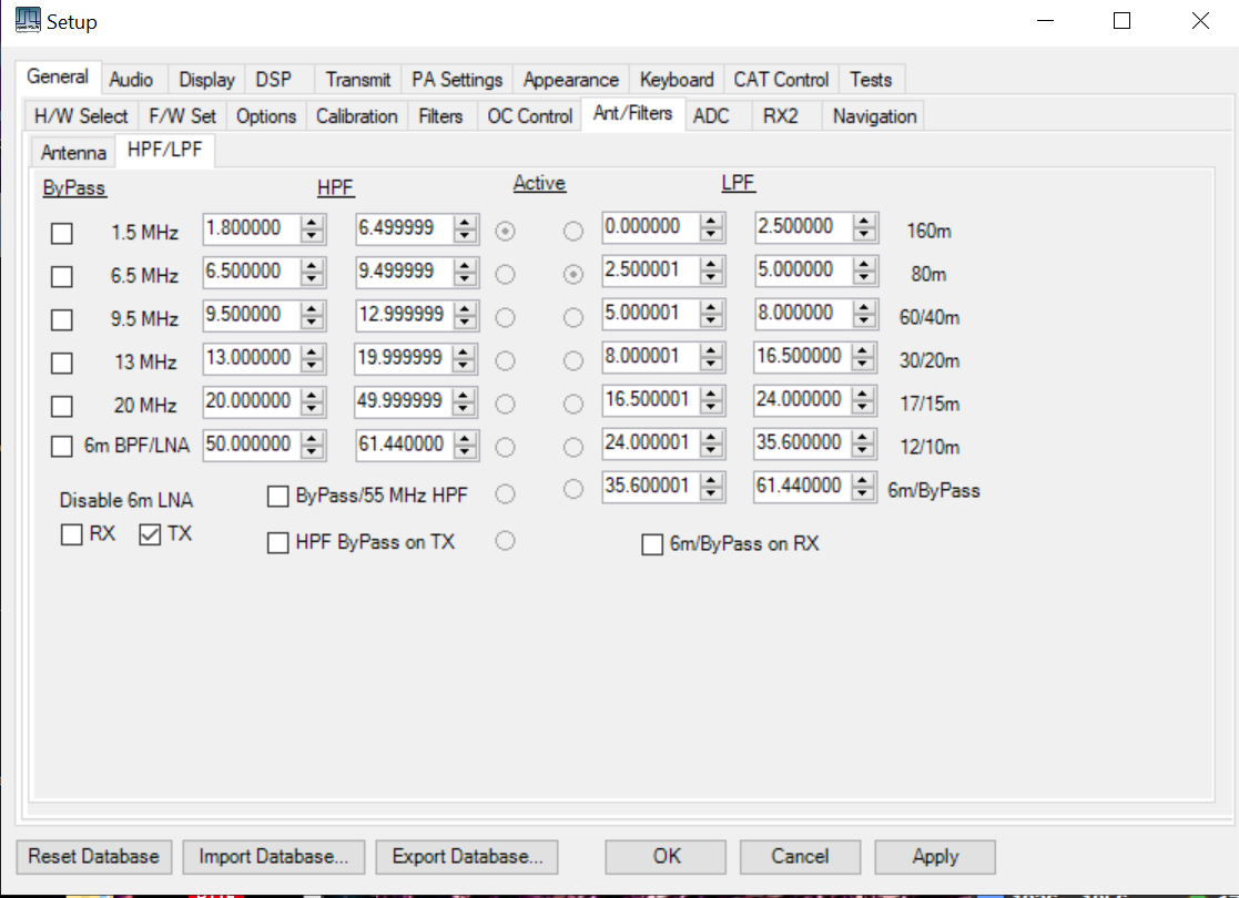

Heres what they were originally, when I was having this issue...

thats because you have to check "6m/Bypass On RX". It will disable the LPF on 80m.

Since both RX are running off of ADC0 I'd also recommend you check "Bypass/55MHz LPF" and "HPF Bypass on TX". This will eliminate the preselector from interfering with reception on RX2 when the RX2 band is higher in frequency.
The preselection filtering is only third order and does very little to improve reception under any conditions. I run with mine bypassed all the time.
