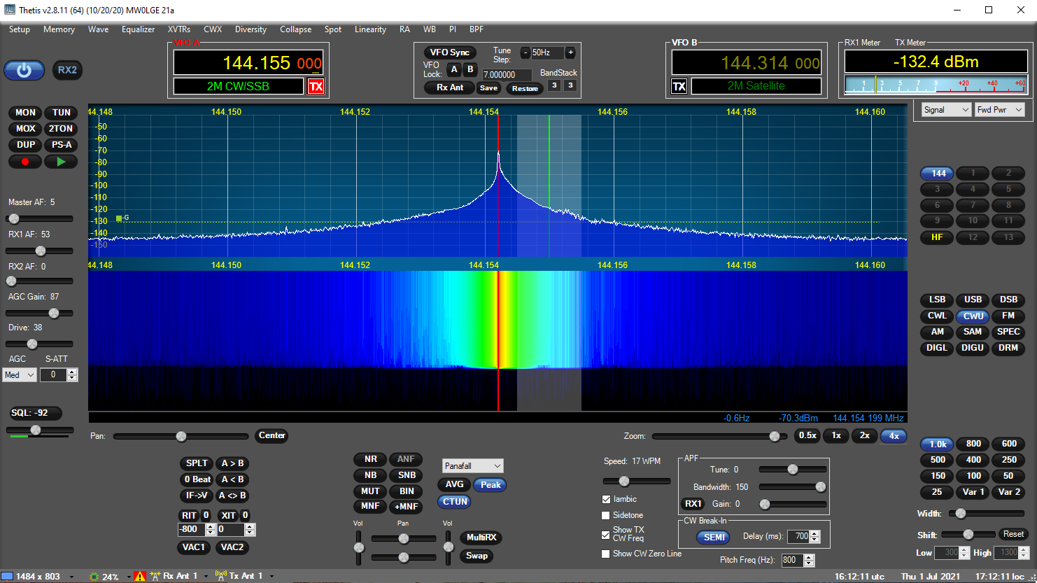

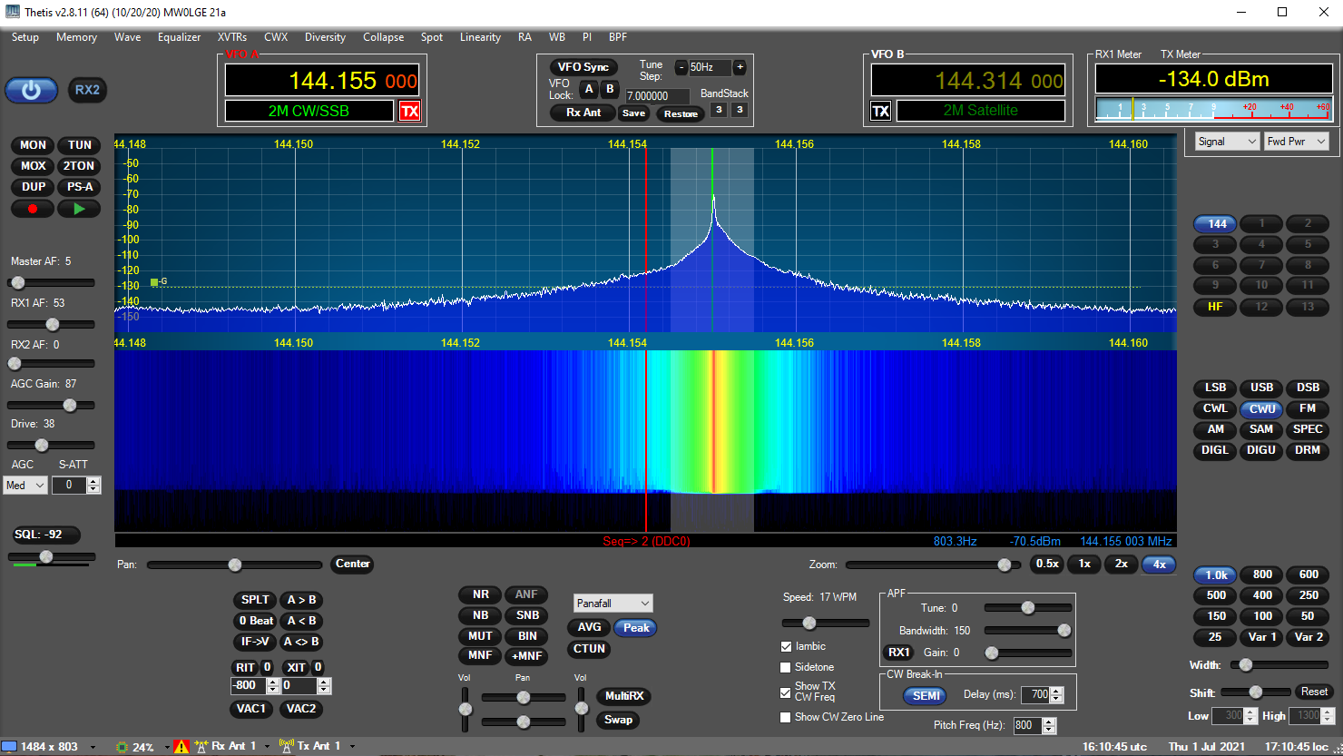

I have spotted a problem with CTUN and cw modes. In cw mode you get a shift between tx and rx frequencies so that if you tune in to a station at a beat note of 800Hz and you have set the cw pitch frequency setting also to 800Hz, you will transmit with an 800Hz offset so the other station will hear you at 800Hz also, all fine.
If you toggle the CTUN mode on, the tx to rx shift is lost so that the other station will now hear you at zero beat, the qso is then probably lost as you might be out of the rx passband at the other end!
This happened to me the other night and chatting in ssb after the qso they told me I was way off frequency, we all got rather confused until I did some tests on dummy load later!!
I think this problem may have been in the code for a while, I'm not sure, it may be that my regular qso partners may have been very politely using their rit to compensate!!! The work-round it to permanently set the rit to 800Hz, or not use CTUN, neither is very convenient.
If its possible to look into it, it would be much appreciated.
If you need more explanations, don't hesitate to ask.
Andrew
G4XZL

The comments from Yevgeni made me have a think....
I have checked further and found that actually it is occurring when using a transverter with details of LO and gain set in the 'XVTR' menu.
I did not mention this in my original post as I did not realise it would make a difference, apologies I should have.
So to clarify:
When using a transverter with CTUN on and cw mode the tx/rx offset is lost as described in my previous posting.
When just on HF, with CTUN on and cw mode the tx/rx offset is working correctly!
This probably explains why it has not been noticed before as I guess most cw will be direct on HF?
Yevgeni, maybe you could double-check if you see the same with a transverter setting?
I am using a 28-144MHz transverter so the LO setting in the 'XVTR' window is 116MHz.
Andrew
G4XZL

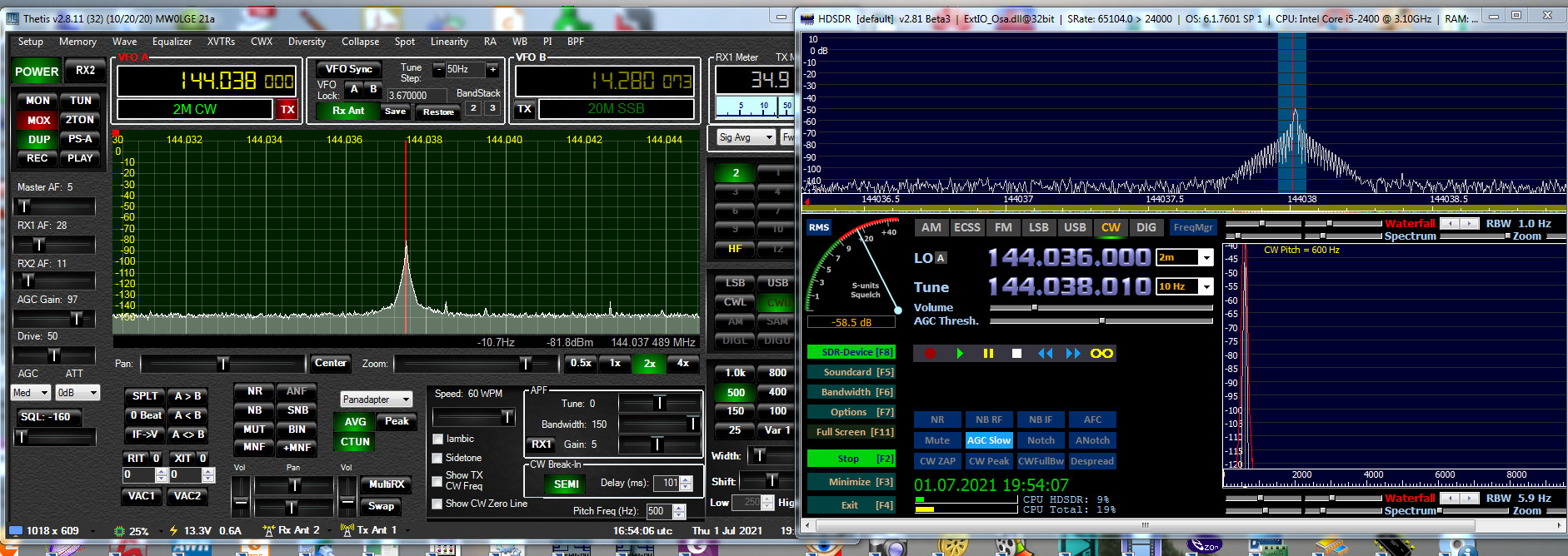

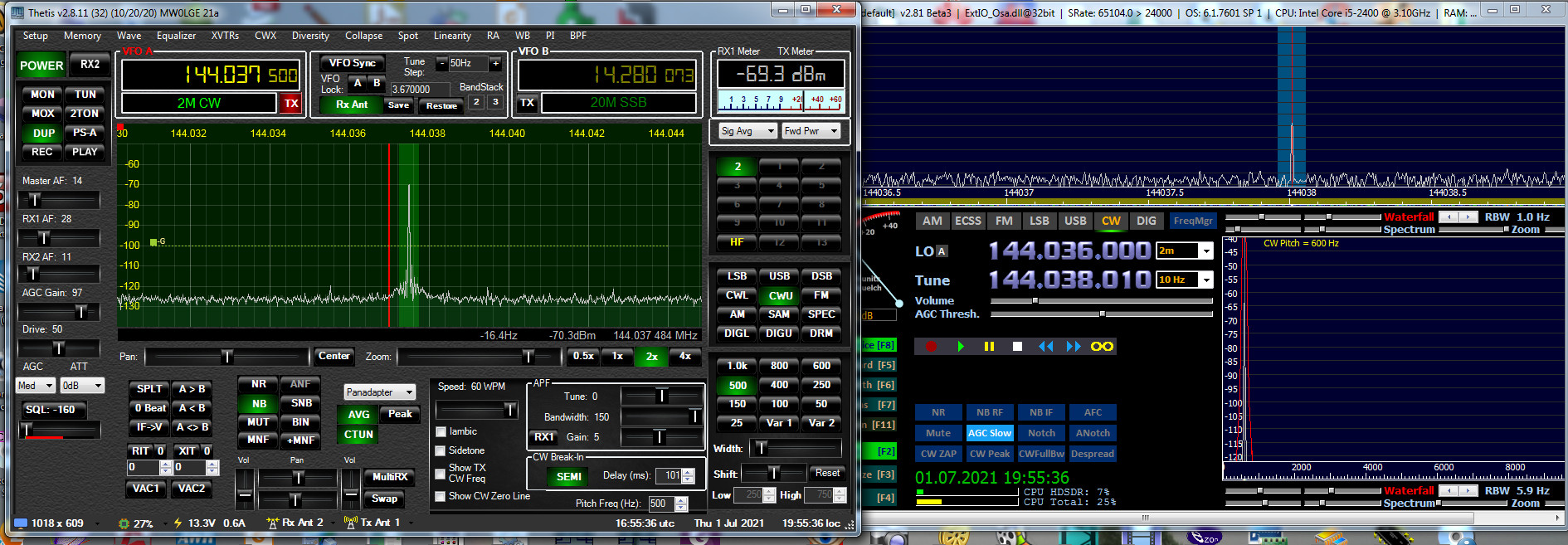

Yes, sorry, I missed your video, just watched it now.
Just doing a bit more testing, it seems to transmit on the correct frequency, but not receive. So probably easier to notice if you can transmit between the two radios.
The sdr here is a Hermes board.
Attached a couple of pictures of a second radio transmitting to the Hermes. One if with CTUN off and the other with CTUN on, nothing else changed. I set the Panadpter to peak mode so it was easier to see the signal and take a screenshot. Transmitting back to the second radio is fine, CTUN on or off has no effect.
If you pretend you have a transverter and transmit on the frequency I used it will really be 28.155 so you can still test with your sunsdr I think?
Andrew
