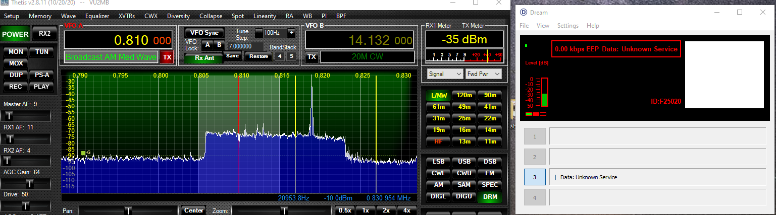

Lately, I am decoding DRM broadcast on Shortwave and also MW.

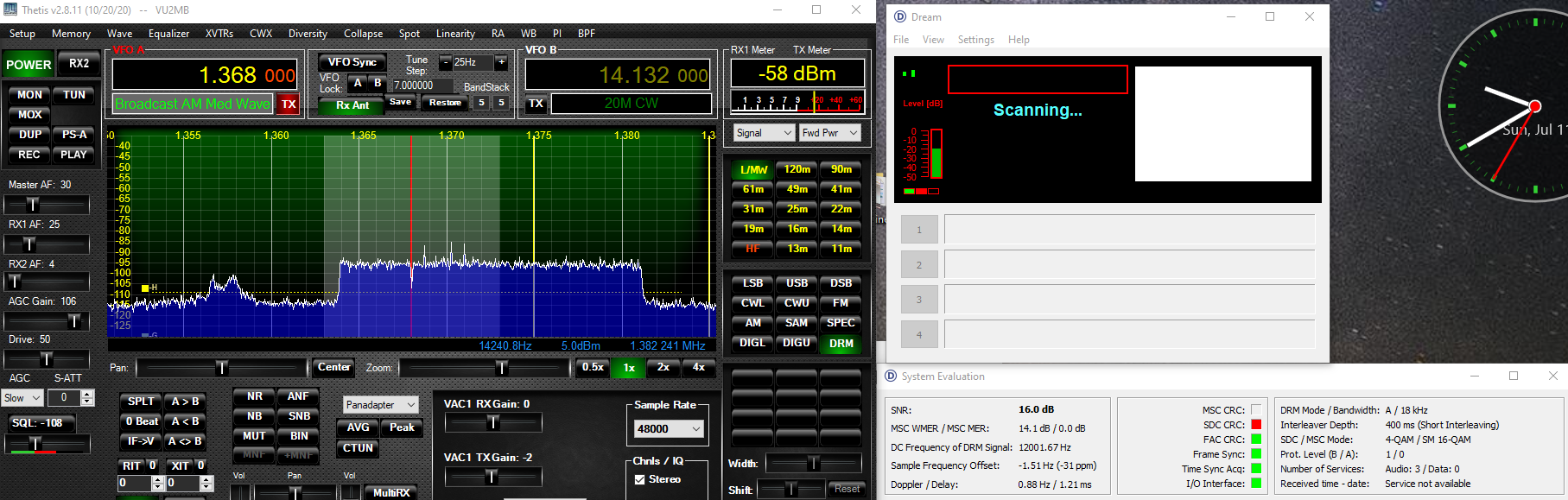

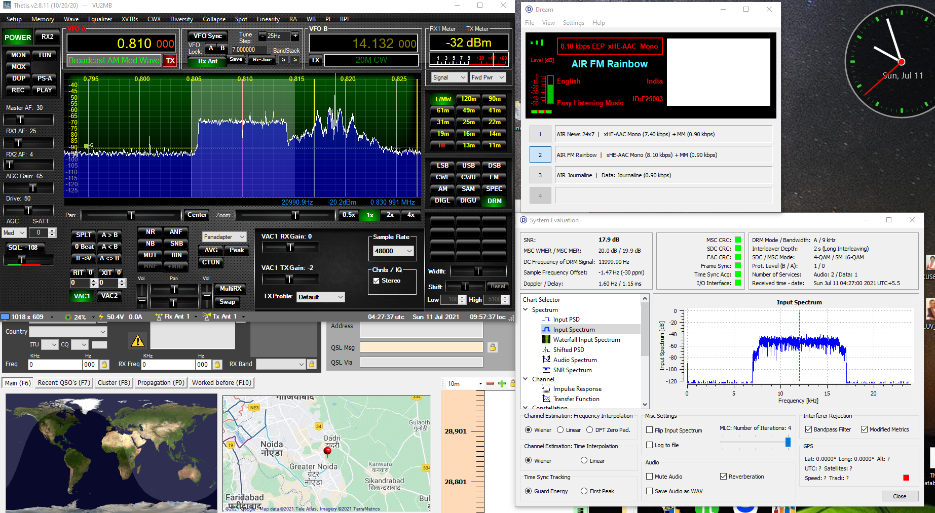

I have found out that India like few other countries broadcast on few frequencies a Full DRM
that is 18khz wide and can not be decoded by PowerSdr and Thetis unless they have an 18 khz filter.
So we need now DRM 9 kHz and 18 kHz wide filters.
9 kHz DRM signals using the latest codec xHE-AAC working perfectly. Screenshot attached. ( 1st picture)
May I request the Thetis designers to look into it and provide the required filters?
Attached, Please find the screenshots of the broadcast. (2nd and 3rd pictures)
