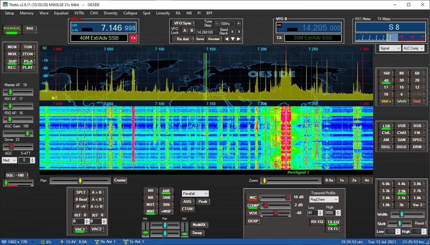

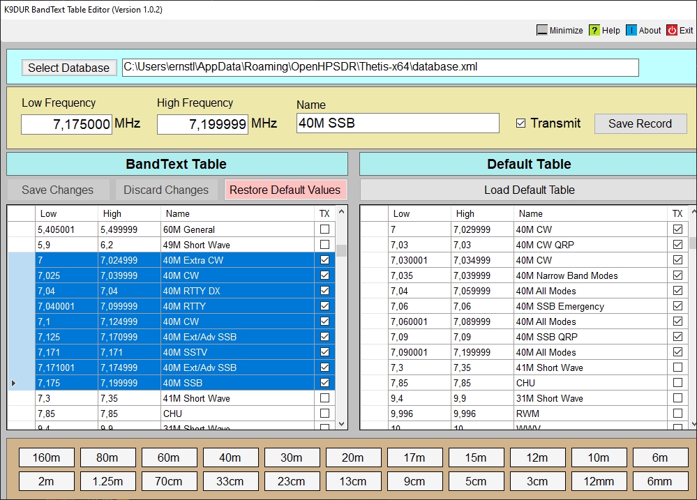

just noticed on the 40m band, that the band edges (red vertical lines) are not corresponding with the values in the database.xml.
Selected region in setup is "Europe".
Same on 80m. IARU 1 ends at 3.8 Mhz. Red band-edge line is at 4 Mhz.
Any ideas?
See screenshots...

Nope, they are hard coded into the display class. I remember having to update them in there at some point a couple of years ago now. All needs a re-work sorry to say :/
Re: band edges
Ok, thanks Richie for the info. I thought I am doing something wrong..

Hi Ernst and Ritchie,
here at my Side all is ok, 80 m 3,5 -- 3,8 Mhz, 40 m also 7,000 -- 7,200
Using 21c Prot. 2 EDIT: Region is set to Germany
Greetings
Erwin
Re: band edges
Ok, just set the region to "Region 1" ... all perfect now.
Thank you Erwin, for the tip!
