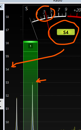

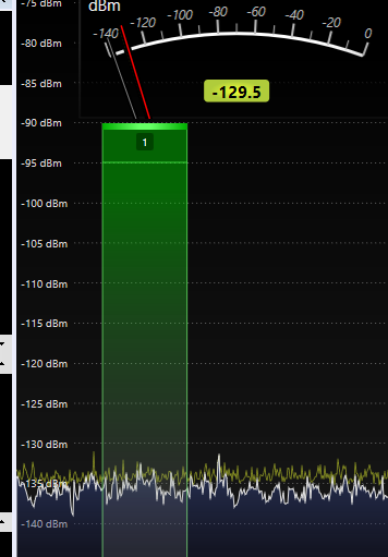

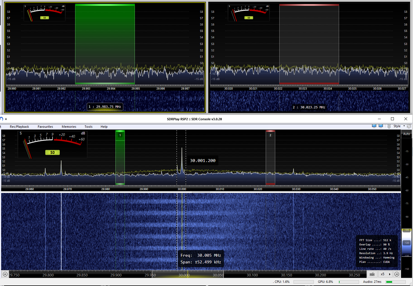

Not for me it doesn't, it is all over the place. The following image is a 4k (0-4000) lsb filter, peak hold on (the yellow line) and there is nothing in the panadapter filter area that is anywhere near -129.5dBmK1LSB wrote: Btw, his meter always agrees with the edge scale in the panadapter!![]()
It is all over the place. I thought you said it was the same on the left?
.... and nothing at all being done at 30MHz
EDIT: ok i could get everything to align if I turned off smoothing to NONE (which is not default btw). That has a massive impact, but still no changes around 30MHz.

Re: Power measurement theory and practice, and S-meter operation
Yes I know about the three needles, but if you look at the images the panadapter does not match the Smeter. I had a fresh install, in fact I had to use the reset tool to get it running.K1LSB wrote: Given that I have no idea what smoothing or Windowing options you have selected (or what options are set as default in SDRC), I should probably revise my previous post to say "Simon's S-meter usually closely agrees with the edge scales".
The only way I could get the scales to match was to turn smoothing off which is not default. Actually you can move that panadapter data all over the place with the smoothing stuff. He even mentions it not lining up in his info you linked :
So unless he actively moves the scale to match the trace (which it doesn't look like he is) then it will be out of line if using any form of smoothing, he even acknowledges that.Signal Level
This is the peak spectrum FFT bin (output value) which is within the current filter. Note: This value will probably differ from the actual spectrum trace as the spectrum trace uses smoothing to make the display more aesthetically pleasing and less tiring on the eyes.
