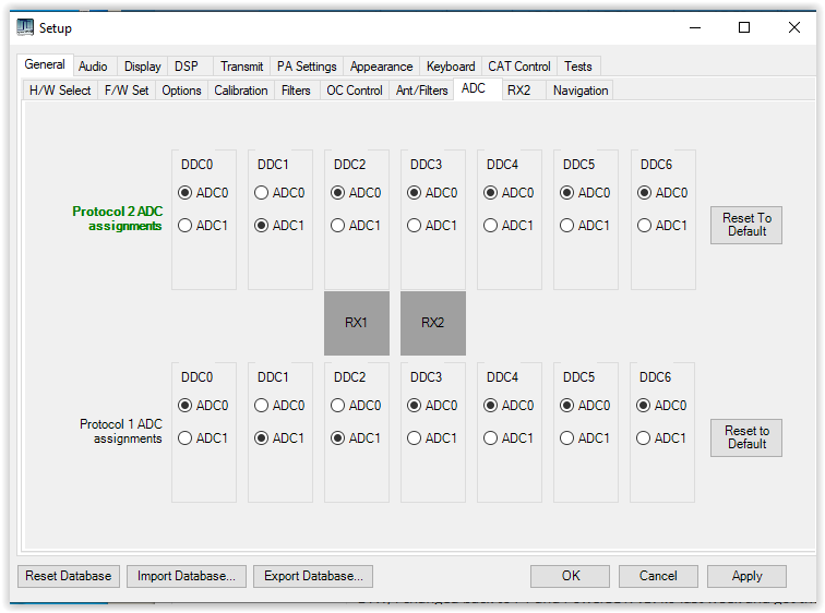

ADC2 = ADC1 in setup is only connected to DDC1 = RX2. RX BNC is open, or terminated with 50 Ohm or shortcut - all the same result.

Re: ADC2 overload
I'm coming up dry on this one.
We know it's not a P1 vs. P2 problem.
Did you try a fresh database?
If that fails, maybe a hardware problem?
