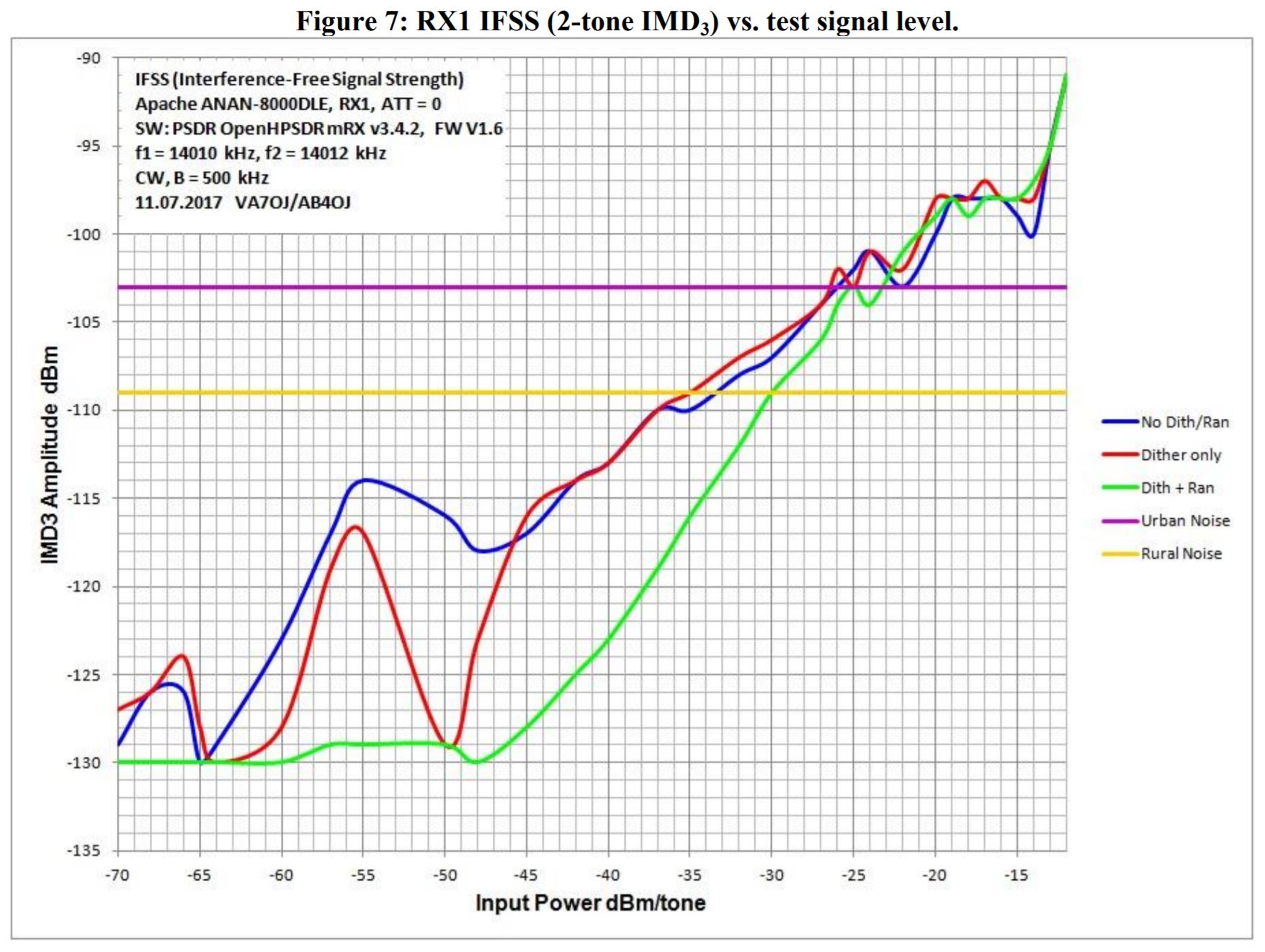

You always want dither and random turned on. Those are the defaults for a fresh Thetis installation. Here's more information on why this is so:
https://apache-labs.com/community/viewt ... 736&p=5026

From Sherwood's opinion, on SDR radios ADC dither and random ON make difference only on a lab measure and it is better to leave them normally OFF on the field (better sensitivity).
Posts: 753
Re: ADC1 overload when monitoring on ANAN 7000 DLE MKII
I2NOY wrote:From Sherwood's opinion, on SDR radios ADC dither and random ON make difference only on a lab measure and it is better to leave them normally OFF on the field (better sensitivity).
The chart in Scott's link suggests otherwise..
Yes, just as Mark writes, take a look at the link both Gary and I posted almost simultaneously (but he did beat me by a few minutes :D )
First and foremost, the Orion MK II SDR board in the 7000 and 8000 series hardware was specifically designed to avoid any degradation in noise floor or sensitivity with dither and random activated. Indeed, if you look at the famous (infamous to some!) Sherwood receiver test data tabulation, you'll see no difference in sensitivity on the 7000 Rob tested. So this is a non-issue on most of our radios, and degradation is very small, maybe 2dB on the older ANAN designs.
I have not seen where Rob mentioned his preference for having dither and random turned off. As far as I know there's no option for this on Flex radios. Perhaps his comments stem from the degradation seen in the ICOM direct sampling radios (7300, 7610) when the IP+ function is activated. IP+ is a fancy marketing term for dither and random in those radios.
Nevertheless, as the link Gary, Mark and I are all referencing discusses, for all but the quietest environments the difference in sensitivity is going to be unnoticeable. Looking at the degradation on the Icom radios that Rob measured, unless you are truly (and we know Icom S meters are anything but "true") seeing an S3 or lower noise floor, you'll never notice the loss of sensitivity.
At any rate, it is a user controllable setting. If you are on an uncrowded, unnoisy band and you are looking for that 2dB on your 200D, or the 6dB on your 7300, by all means turn those settings off. If you are in a busy FT8 band, or in a contest, you might want it on! And if you are using Orion MKII based hardware, there's no need to do anything but leave it on.

Well, you convinced me to try to put ON these functions. :)
