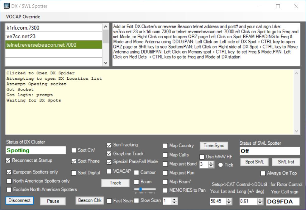

Since a few days the spotter stopped working. I deleted the database with no joy. I installed Thetis from scratch with no joy. I installed Thetis on second computer with no joy. I dried to connect via an mobile hot spot instead of may FritzBox7490 via fiber with no joy.
Please help with some hints where to look at. Thanks.
73 de Georg, DG9FDA
Anan 100D first edition, Thetis v2.10.3.6 x64, Protocol 2 Version 12.1.8

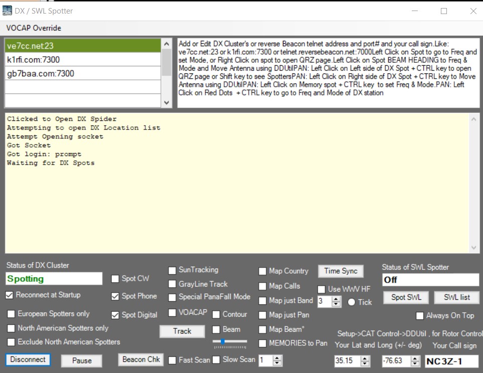

You left a lot of info out. What exactly is not working, the Spotter window, is it not connecting, not seeing spots?
Or is it not displaying on the spectrum?
Does it show connecting:
Screenshot 2021-11-14 114751.jpg (146.23 KiB) Viewed 3975 times

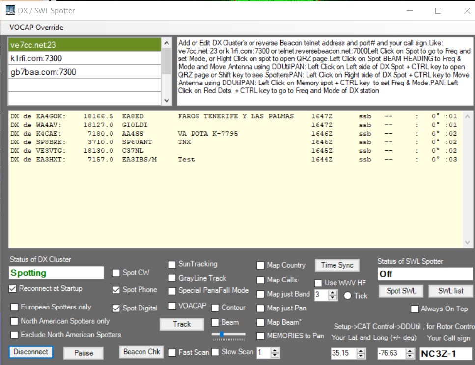

Will it show spots after a bit:
Screenshot 2021-11-14 114817.jpg (164.18 KiB) Viewed 3975 times

Dear Gary, thank you very much for your reply. I am very sorry but I could not find the way to include pictures. And excuse me for my late respond. I was on a business trip and after that I was a little bit "down".
What I can see is exactly the first picture you posted.
I see no spots and there are no spots in the spectrum.
I would be very glad if someone can point me to the solution.
73 de Georg, DG9FDA.
