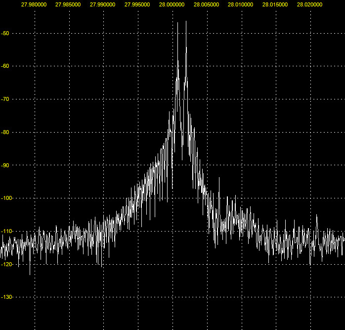

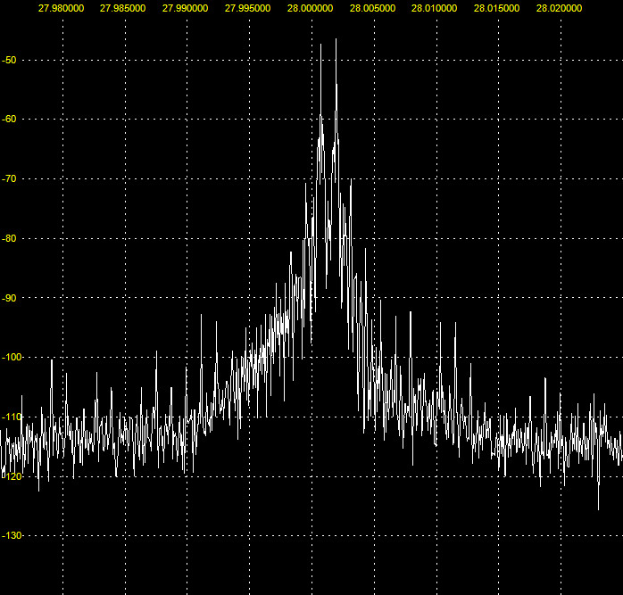

Looks like we have the same budget spectrum analyzer. I checked my 200D running Thetis v21g with v1.9.15 P2 firmware loaded and as can be seen in the screenshots below it looks very clean with a carrier and also with the 2 tone test using Pure Signal. During both sweeps below the ANAN was running at my amplifier driving power of 50 watts.
I have not yet checked v1.9.17 but I suspect that I will have identical results with what Phil observed since it appears that our Orion boards are identical twins.
Orion v1.9.15
Orion v1.9.15
n1gp
Posts: 204
Re: New 200D Orion Protocol 2 Firmware Topic
Post by n1gp »
Rob,
Tnx for the update. It's looking good on your budget analyzer :)
-Rick / N1GP
