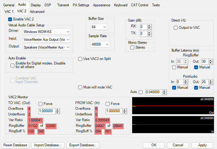

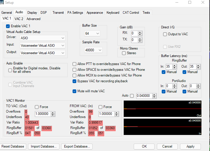

I am pulling my hairs being able pump VAC2 for RX2 into my audio device through voicemeter banana. I have been using VoiceMeter Banana for some time now with success for my MAIN. Now that I have that fully configured and working wonderfully I am having a hell of a time to get it working for VAC2. Any advice for either Thetis or VM Banana?
See screen shots.

However the only way I could sync the audio (ie remove the echo) was to add a a fair amount of latency to vac1 (adjusting the various parameters)
Any other suggestions?

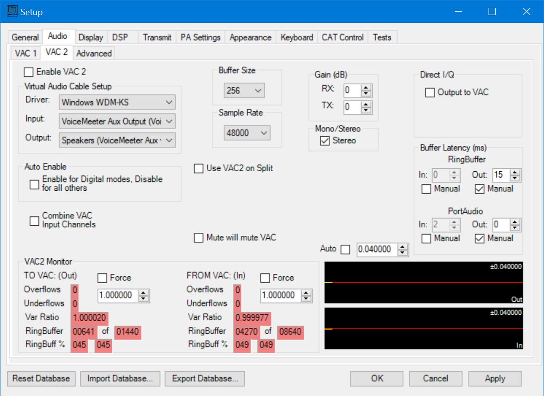

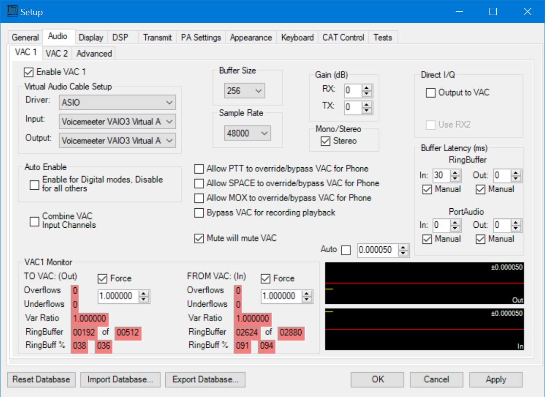

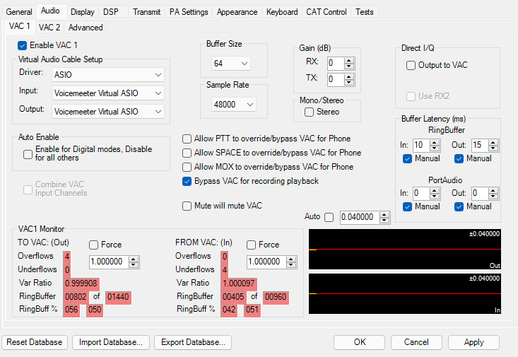

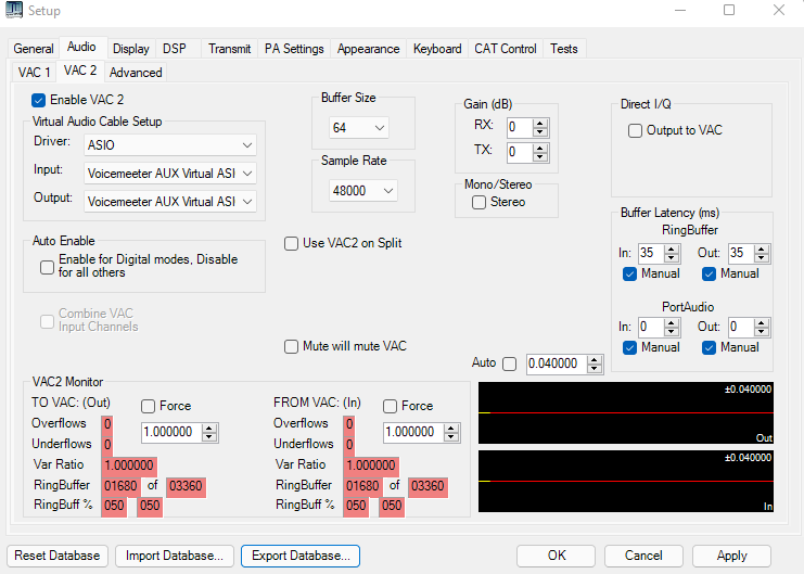

There are not really any good solutions at this time. You could run both VAC1 and VAC2 with WDM-KS, but then you don't get the low latency advantages of ASIO. And those advantages are quite significant. Out of morbid curiosity, I just went through an exercise of optimizing my VAC2 configuration (VAC1 was already optimized) and compared the two using an oscilloscope by putting the same signal on both RX and having RX1 output on the left audio channel and RX2 output on the right channel. The result was that ASIO beat WDM by approx. 78ms!
Here are my current, as optimized as I can make them, settings for VAC1 and VAC2. Obviously YMMV, every system is different, you can't just blindly copy what I did, you have to find the minimum settings that provide unambiguously stable audio for you.

Thanks for investigating. I played around and here is the best I could get from VAC2. My VAC1 is VERY lower latency as you can see (MOTU Audio device is fantastic!)... T0 equalize voice I would need to raise VAC1 Buffer to 2048 AND increase some of the other latency settings. :lol:
Unfortunately without sacrificing VAC1 nothing I could do to get rid of the echo.
