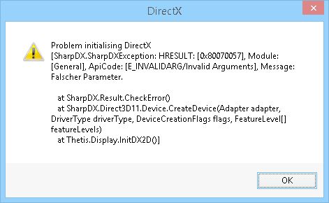

Post by DL2XY »
Thetis v2.8.11 21k9(pre);
Exception at startup (splash screen)
Program starts, but no panadapter display at all.
Both on Win7 SP1 x64 and Win8 Pro x64.
73 Walter

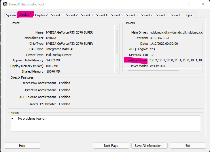

Thanks for this. I had a sneaky feeling that some issues with the change to the swapchain may cause some issues.
After reading up on it there are some limitations on the SwapEffect based on operating systems. Win8 and lower will need special case. I will look into making a fix later today.
Posts: 1588
@Walter,
can you test this please. The zip only includes Thetis.exe replacement.
Download x64 [md5:82573E1D10D70DEE313E21D434D73A09] - test failed
- added DX feature level support from 10_0 all the way up to 12_1. Will use the highest available on the default adaptor
- swapchain flip only used when supported (win10+)

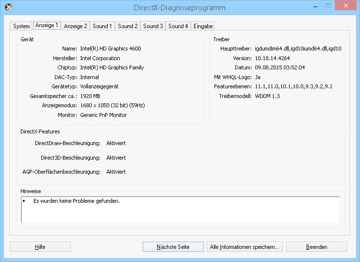

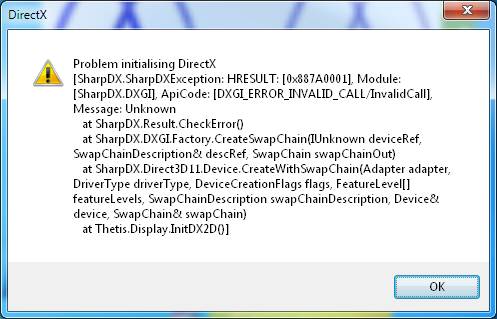

DL2XY
Post by DL2XY »
ramdor wrote:@Walter,
Download x64 [md5:82573E1D10D70DEE313E21D434D73A09] - https://bit.ly/3rn6KMc
WIN 8.1:
WIN7 SP1 to follow this evening.
Walter

Posts: 1588
@walter, another build to test, however, fixing this could be futile until I get win7/8 running here later this evening.
Download x64 [md5:738D64D2DC8C2957EF66E673A518A83B] - test complete
Everything in this zip this time.
- dx feature levels adjusted based on OS

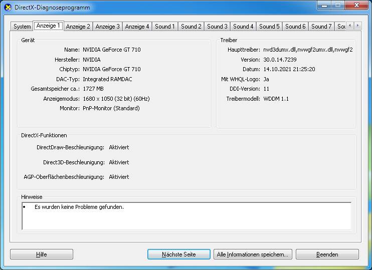

DL2XY
Post by DL2XY »
ramdor wrote:@walter, another build to test, however, fixing this could be futile until I get win7/8 running here later this evening.
Download x64 [md5:738D64D2DC8C2957EF66E673A518A83B] - https://bit.ly/3Hpb2sb
Good job, last one is running at least on WIN7 Ultimate SP1. Can test on WIN8.1 tomorrow morning .
These are the requested Diags:
DXDIAG WIN8.1.jpg (55.79 KiB) Viewed 26871 times
DXDIAG WIN7.jpg (52.64 KiB) Viewed 26871 times
cheers Walter
