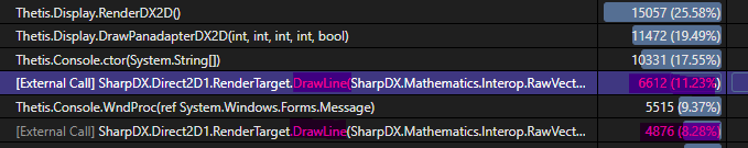

3) Screen display width is always the issue for Thetis. Some performance might be gained by me splitting the calculations over a number of cores, and then combining the data to send to the gpu, but I am not sure a whole lot will be gained. When I profile Thetis at around 2500 pixels wide with a single RX and leave it running for about 30 seconds, we can see that ~20% of its total cpu time is spent calling directX2d DrawLine. We can go down the route of multi threading those DrawLine calls, say building the frame up in 4 thread, but man, so much work !

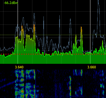

I am adding that decimation stuff Bob, so may be a solution. It actually looks really good.
This is showing a decimation of 8. I have not yet finished the waterfall pixel increase so the image looks odd. Notice how the fill doesn't quite fill the outer line, this is due to the vertical lines now being 8 pixels wide. For those wanting high frame rates, the decimation can be increased.

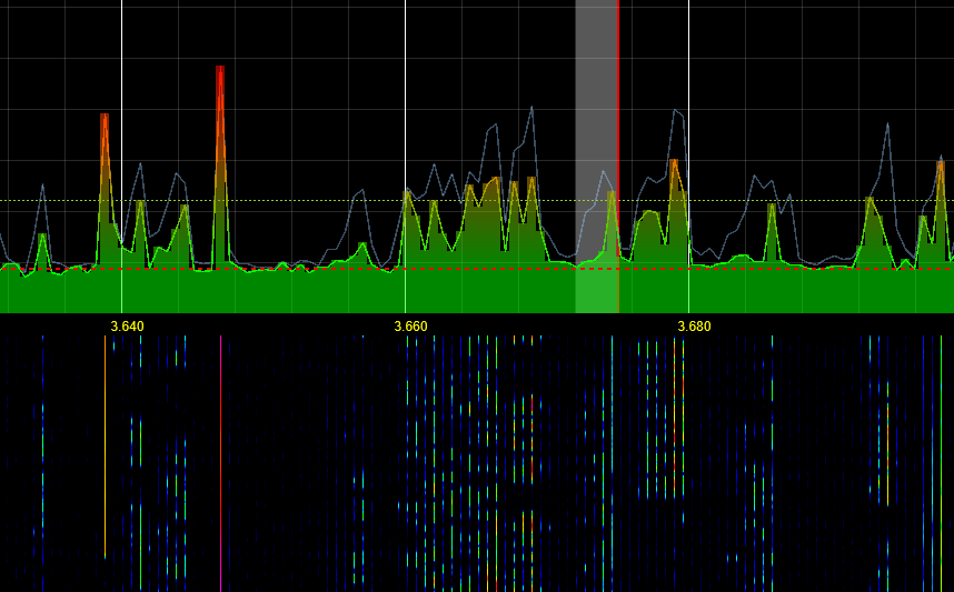

and with a decimation of 2

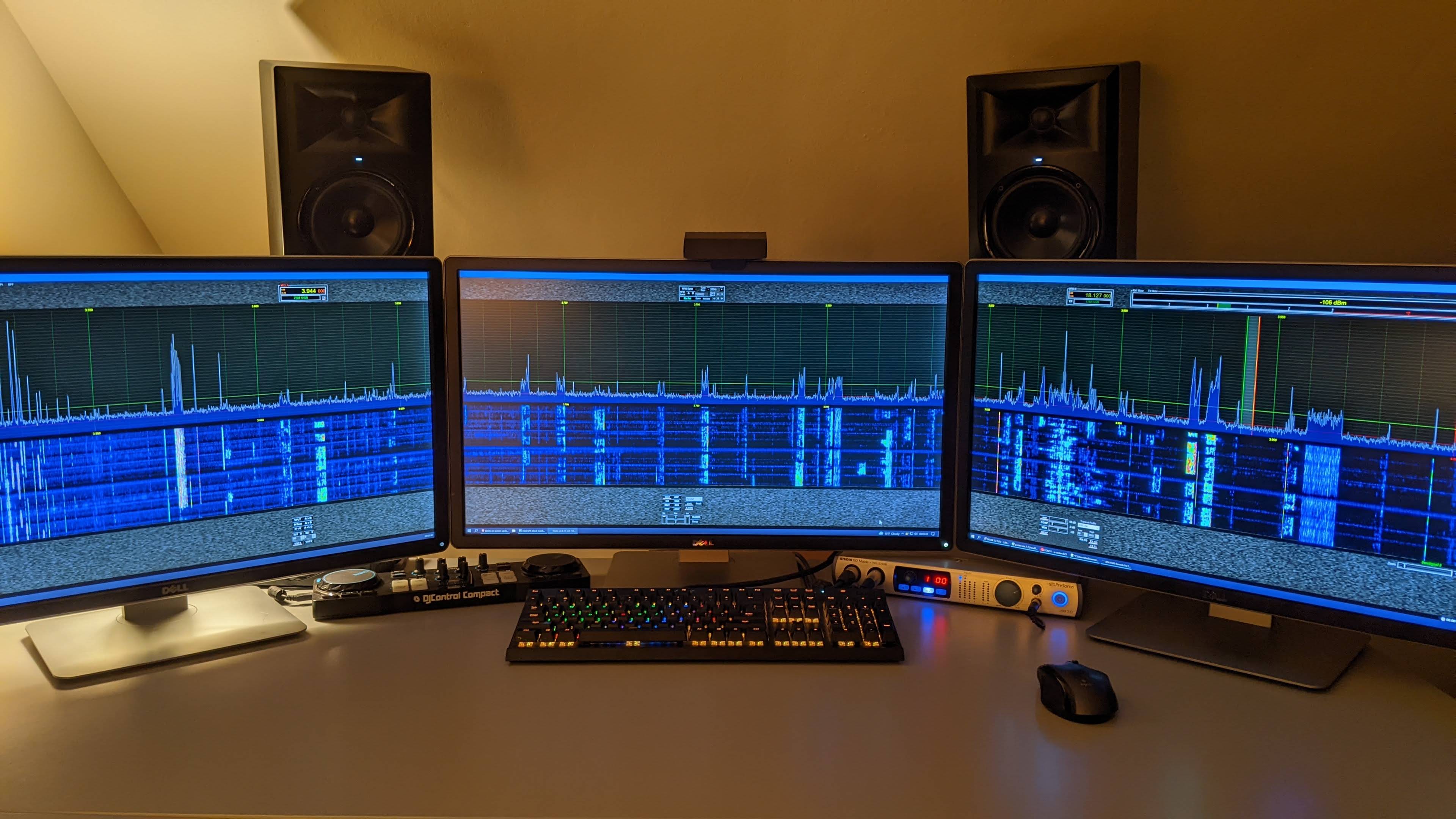

I am shocked that dual Quadros will not run the OP's desired configuration.
As a benchmark, I have an EVGA GeForce 1070 graphics card feeding triple Dell 30Hz, 4K monitors over three separate Displayport connections.
This configuration is by no means state of the art, but it has absolutely no problem keeping up with a 30Hz screen refresh over a 17+ million pixel area (rough estimate of spectral display area). I suspect it would have no problem even at 60Hz if I had faster 4K monitors. That's all of 80M at 768KHz sampling rate.

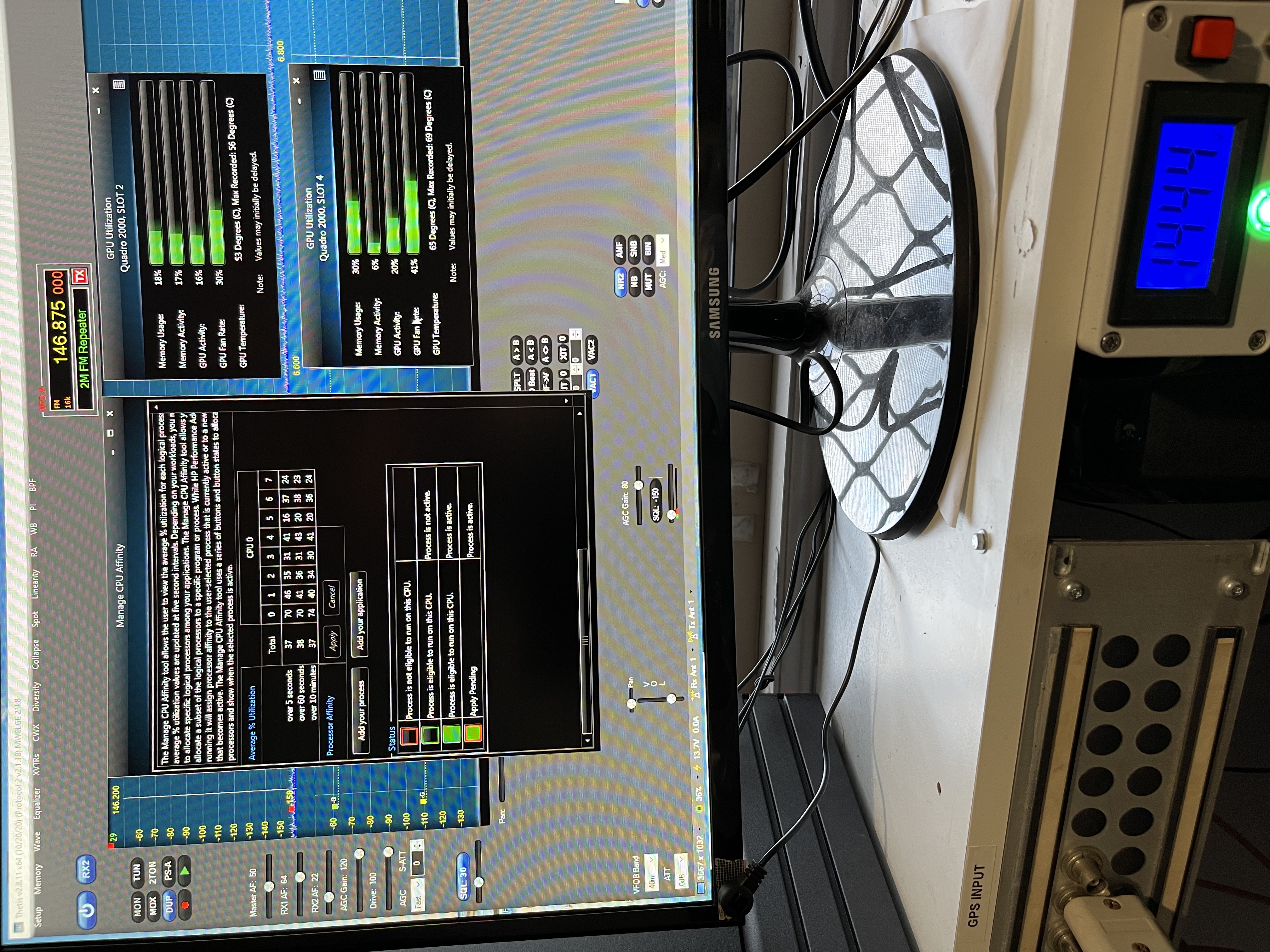

Hi with my sons help I found the HP monitor software and took this shot of RX! and RX2 on
The video cards don't look to be the problem.
also looked at the network transfer rate RX1 only ~80Mbyte/second add RX2 it goes to ~150 Mbyte/sec.
Regards Bob
Re: Limits on screen update rate
I'm running an i7-7700k. I pushed my RX1 and RX2 sample rates up to 1536KHz. Still no problem reaching a stable 30Hz update rate at ridiculous window sizes across triple 4K monitors. Using ResMon (built into Windows, just run it from the "run" box), Thetis shows approx. 150 Mbits/s (not bytes) receive, 11 Mbit/s transmit, for a total of 161 Mbit/s network utilization (rounded to nearest Mbit/s).
Something would seem to be bottlenecking your PC, which ought to be doing just fine.

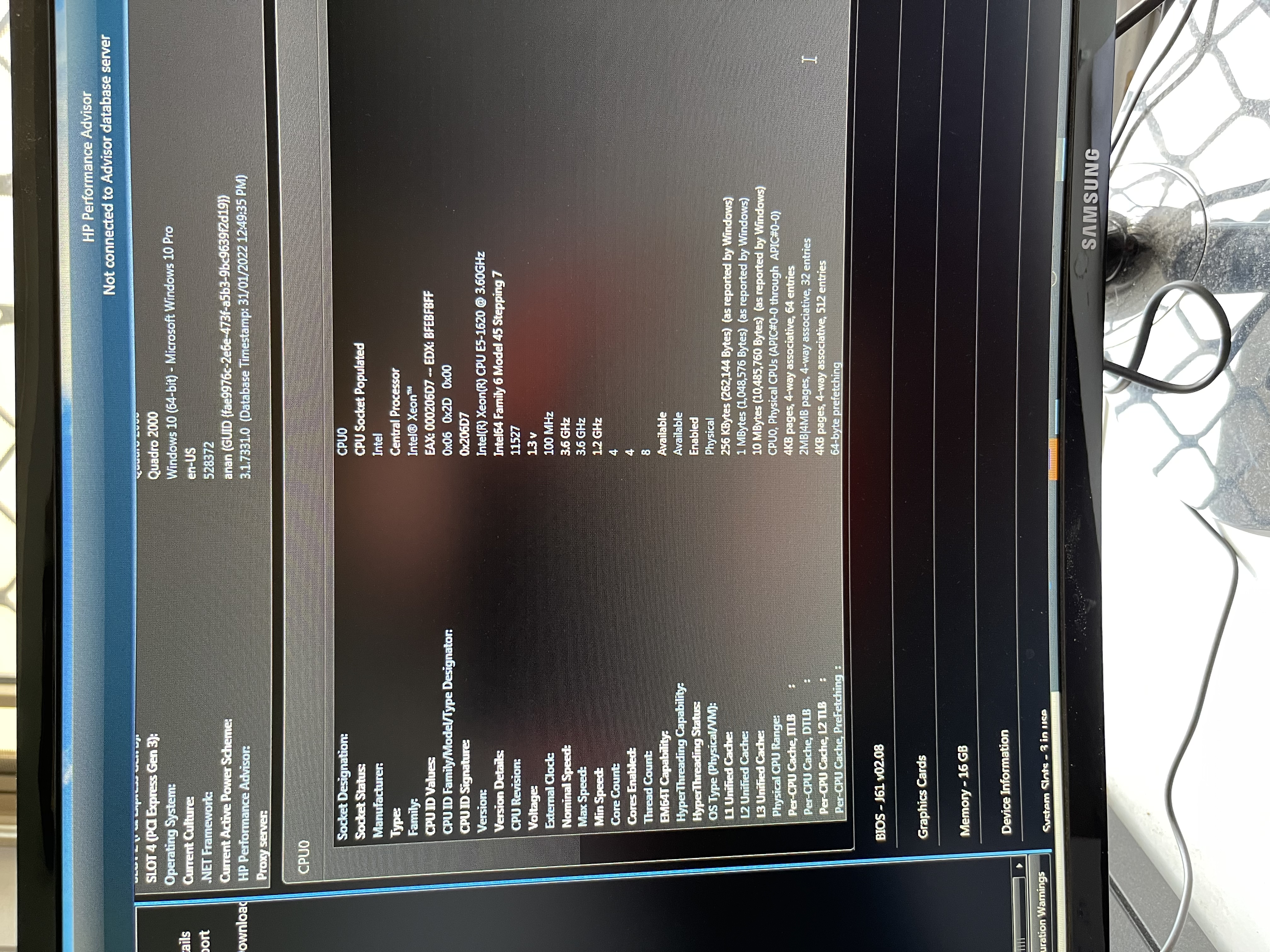

Not quite sure these days. I was told I had a good machine......but in relation to what ?
But this is what I have.
Regards Bob

So it's an E5, not an i7. If you compare my i7-7700 to your E5, (just Google it) the E5 you have is not that much less powerful. It should not be a problem.
