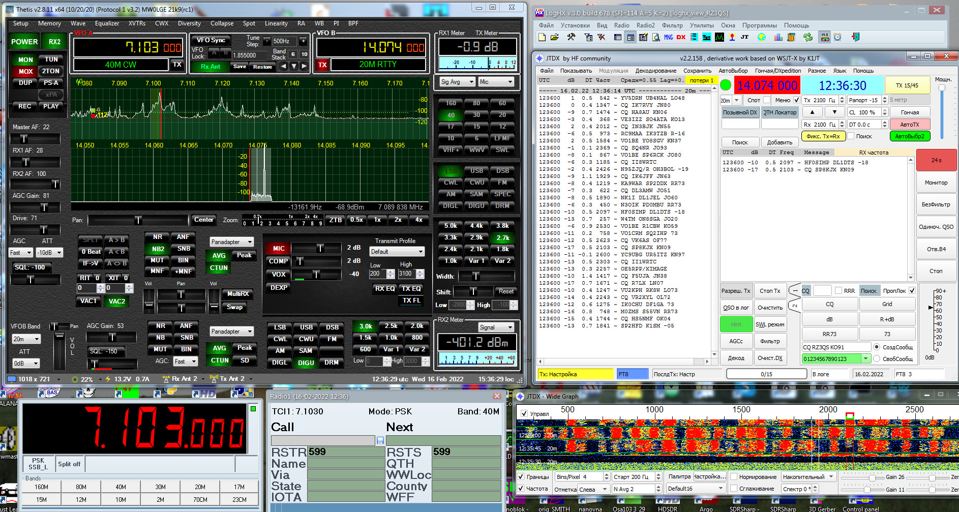

While the transmission on RX2 is with RX1 modulation.
- TCI_RX2.jpg (737.3 KiB) Viewed 23355 times
That is strange, as it was using vac2 for me, and I was using JTDX on Client 2 no problem. I did however have to reset my database to get the audio to work on vac2. I have not investigated why it happened as yet.Yevgeni wrote:While the transmission on RX2 is with RX1 modulation.
Try just using RX2 with voice from a PC mic device, and see if you can get that working. Ignore TCI.
EDIT: yes, seems to be an old issue. I think if you switch on the checkbox 'use vac2 on split' in setup , then click on TXA and then TXB in the VFO boxes it should work.
Thanks!ramdor wrote: EDIT: yes, seems to be an old issue. I think if you switch on the checkbox 'use vac2 on split' in setup , then click on TXA and then TXB in the VFO boxes it should work.
That's how it works.
- SSB_FT8_TCI_RX1_RX2.jpg (989.43 KiB) Viewed 23331 times
yep, a work around for now. It is fixed for rc2. That issue has been in there pre 2020.

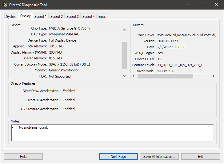

I updated my video card driver to the the latest on the nVidia website earlier this morning - no difference. About mouse driver, Logitech says on their website "all Logitech products work on generic drivers. They do not have specific drivers to install."ramdor wrote:Please could you check you have updated screen drivers and/or mouse drivers. Failing that please include screen grab from DxDiag related to the display in use (Display or Display1). Do you have any other hid/mouse devices attached to the machine? I wonder if anyone else has seen this?
Other than keyboard and mouse, no other HID devices. (Unless a MIDI controller counts as an HID device. I have two of them for controlling Thetis.)
Here's the DxDiag screen capture. 73, John

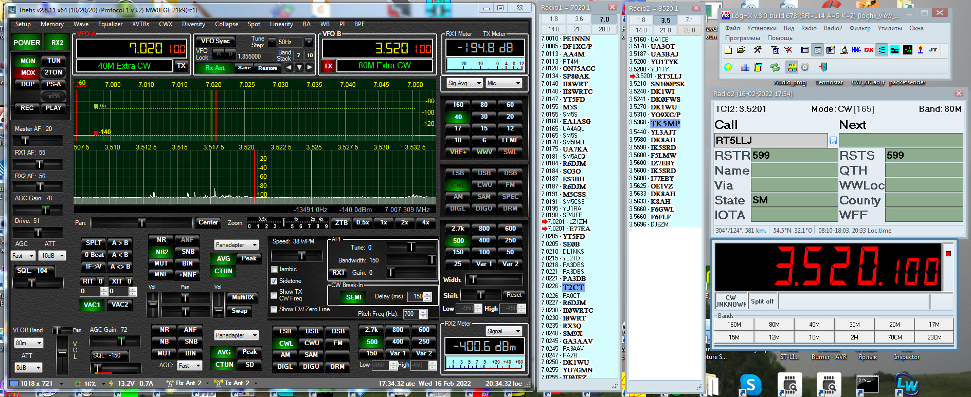

I work CW. Things are good. On spots there is a restructuring of the frequency RX1, RX2.
But, when there is a transmission of CW at the frequency RX2, then the panorama RX1 disappears. Reception of RX1 stations remains.
