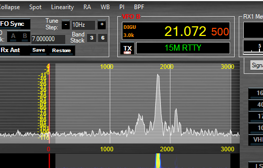

At some random time the transmit spectrum display starts showing wide-band behavior.
Here's an example of a normal transmission
Screenshot 2022-02-23 091537.png (75.92 KiB) Viewed 9960 times

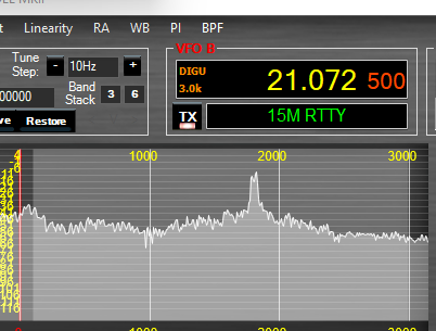

The at some point multiple times per day it will look like this...wiith wide-bad noise bouncing up and down and toggling the Power in Thetis fixes it.
Screenshot 2022-02-23 091752.png (52.67 KiB) Viewed 9960 times

not really seen that. I get the odd 'bounce' of the spectrum when in TX (dup on), which sometimes is related to a SEQ error, or some external signal/lightning. It doesn't stay 'stuck on' though requiring a stop/start.
