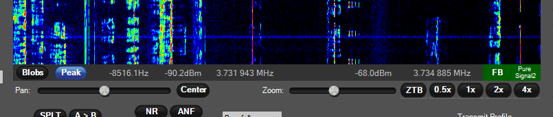

If I zoom way in so that my receive bandwidth fills most of the panadapter width, the cursor of course changes to the <o> cursor inside the bandwidth shading. This cursor never disappears when I move it within this bandwidth. A clue, perhaps?
@W1JA, Hi John , then it is something else that is causing flickering and the pointer vanishing.
Can you please make me a video, so I can visually see what is happening. A video will show me if you are crossing some things that might be causing the issue.
Thanks, Richie.

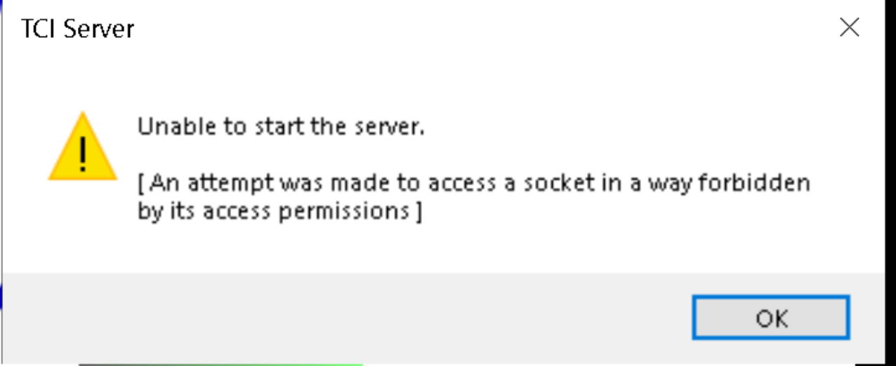

Is anyone else seeing this message on Thetis startup?
might be firewall or might be that port is in use by something else (which is most likely reason)
EA1DAV noticed that 50001 clashed with icom rsba, and anydesk.
Richiie.
Richiie.

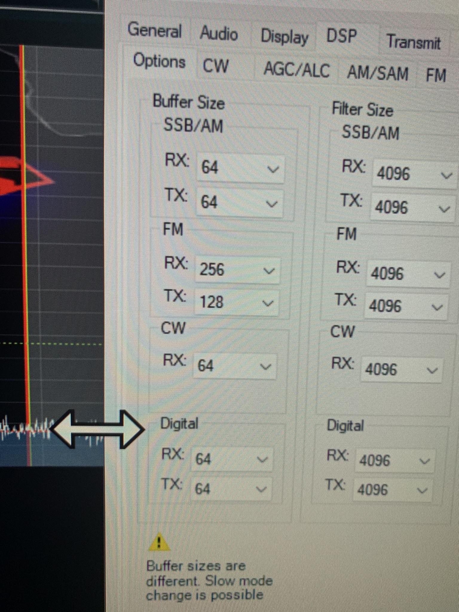

Hi Richie
I’ve been looking through some of the filter settings today and noticed this error, I’ve never noticed it before. Just wondering if I’ve got them set right cheers mate.
- DBE3E5E0-046D-4638-8BAE-2449BC1B71E1.jpeg (1.26 MiB) Viewed 25633 times
Thanks Richie,it does not happen on every start up and re starting Thetis fixes it. Only program I have that uses TCI is JTDX and that is not running when this happens. I've checked the windows firewall and Thetis is an allowed App. I'll un install anydesk as a test in case its doing stuff without being run.
ramdor wrote:might be firewall or might be that port is in use by something else (which is most likely reason)
Richiie.
try...
netstat -o | find "50001"

You have a different FM buffer size to the other modes, so it will take additional time to rebuild this when you switch into and out of FM from any other mode.

That command (with JTDX running) shows
C:\Users\ei7bm>netstat -o | find "50001"
TCP 127.0.0.1:50001 DESKTOP-3B6ADBP:50734 ESTABLISHED 18484
TCP 127.0.0.1:50734 DESKTOP-3B6ADBP:50001 ESTABLISHED 9948
I assume it is running ok atm? hmm.. let me see if i can find the flag to get the exe namesTony EI7BMB wrote:That command (with JTDX running) shows
ok...
tasklist /fi "pid eq 18484"
Will give you the exe name, where the number matches the number at the end of the line when you run
Yeah running fine ATM, just needed one re start of Thetis. Guess I need to run the commands again next time the error shows up. Thanks so much for the help
C:\Users\ei7bm>tasklist /fi "pid eq 18484"
Image Name PID Session Name Session# Mem Usage
Thetis.exe 18484 Console 1 281,948 K
ramdor wrote:I assume it is running ok atm? hmm.. let me see if i can find the flag to get the exe namesTony EI7BMB wrote:That command (with JTDX running) shows
Sorry for the confusion mate... I was referring to if my buffer size filters are correct as there is exclamation mark at the bottom which I haven't noticed before
Try setting all the buffer sizes to the same value and message should disappear.
m0cpy wrote:Hi Richie,

I have the same thing. If I change both values to 64, then Thetis goes haywire when I select FM mode.m0cpy wrote:Hi Richie,
I opted to leave it like that, it works.
