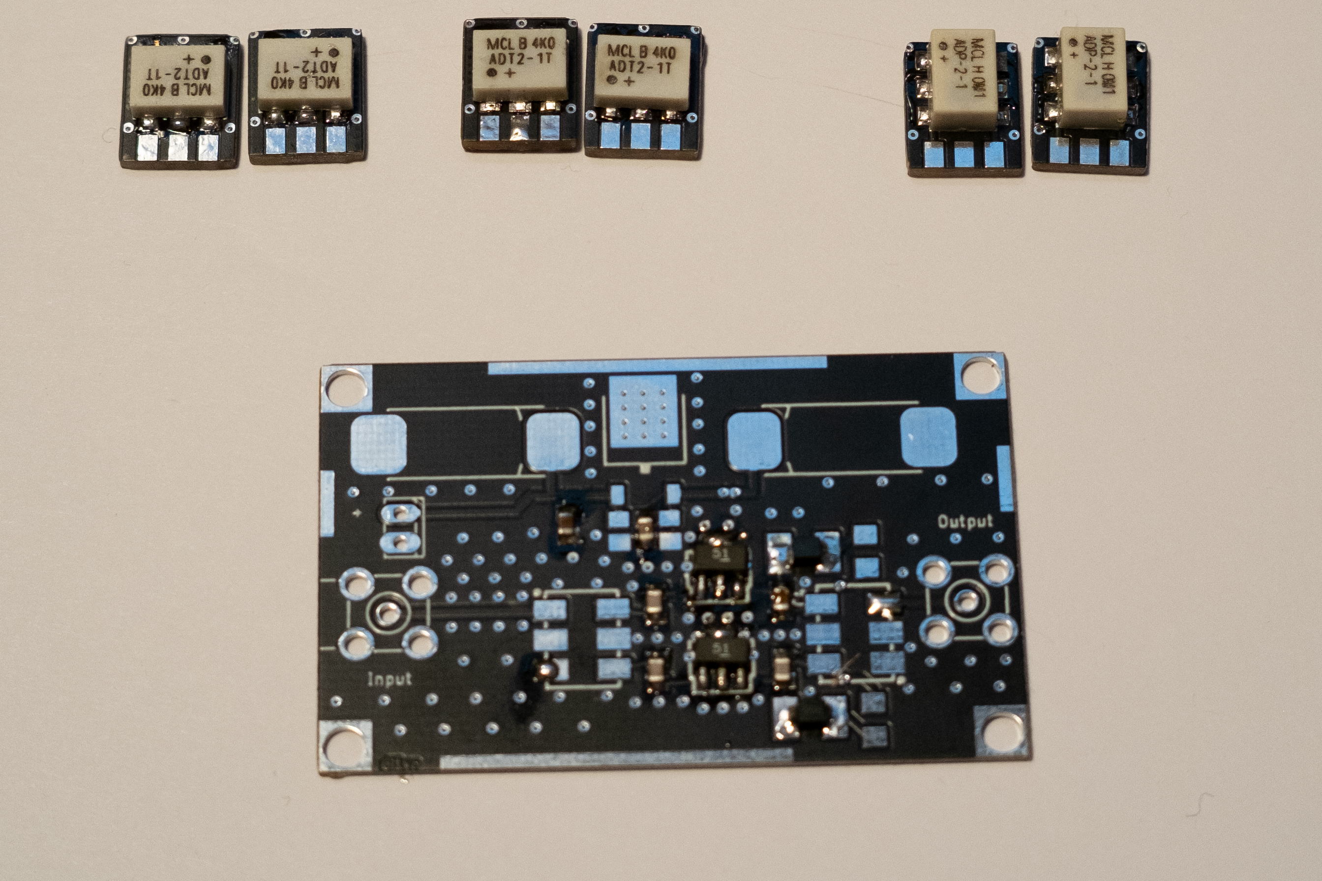

Hello,DL8LAQ wrote:Happy Easter!
Are there any news about this IMD thingy?
yes, I got my test boards, still waiting for some components, then I try to reproduce this behavior first.
If this succeeds reproducibly, I have made small adapter boards with which I can insert other transformers and attenuators.
These boards can then be used instead of the transformers.
I will also make a test with the MC Splitter/Combiner.
To the picture, left - correct mounting direction, center - as on Orion and right - splitter/combiner.
73' René

Apart from changing some coupling caps through substitution, I've been deathly afraid of modifying my Orion II with sub-boards. While a sub-board design may cure one problem, will it be offset by introducing another?dj1yr wrote: "...yes, I got my test boards, still waiting for some components, then I try to reproduce this behavior first. If this succeeds reproducibly, I have made small adapter boards with which I can insert other transformers and attenuators...."
I think any invasive change with outside material would require a litany of tests to ensure that the original performance isn't degraded in any way.

unfortunately I don't have much time at the moment, QRL, family, house..., all the components are with me, I have put the project in a box for now and will continue it when time allows.
Theoretically, nothing will change in the following stages, because the levels of the main signal will not increase, that's why there are attenuators on the small boards.
I don't know if this will lead to success in the end, but I have tried it.
73´ René
