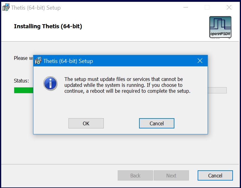

Posts: 6088
@ramdor
I'm getting this warning with the 2.9.0.1 installer. Is this right?
Cheers,
Posts: 1587
w-u-2-o wrote:@ramdor
Cheers,
I guess so. I have no experience of WiX installer. Looking through the script/xml it requires .net framework v4.8, c runtime v143, perhaps one of those can't be updated without a reboot as being used by something in the system, not sure.

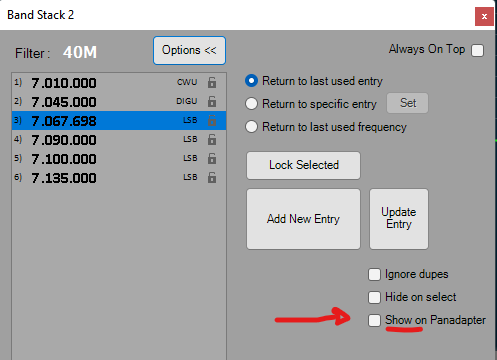

Posts: 1587
K1LSB wrote:Thank you for v2.9.0, Richie!
One small issue for me, I can't see any of my Band Stack "receiver stripes" anymore in the spectrum display. They're all still defined in the Band Stack but they aren't displayed. Is there a toggle to turn them on/off in the display?
Thanks again,
Hi Mark, I take it that setting didn't migrate? was it switched on in the previous version?

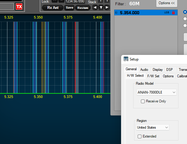

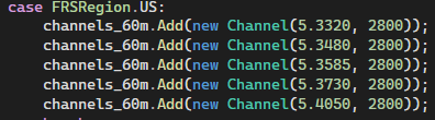

Posts: 1587
Jim wrote:
The 5 channelized frequencies for 60M didn't make it either. Shows 5.354 only. Set and locked them manually in Band Stack.
Did you have them set up previously in bandstack? The overlay (blue in my case) in the display is based on region and not linked to bandstack.
In fact, if you change region, it will reset all the bandstacks. This is what I see after changing to US.
Posts: 6088
Starting with a reset database, US region, no previous bandstack information, I also see the same behavior on 60M, and also redid the 60M bandstack to what I wanted.
Posts: 1587
w-u-2-o wrote:Starting with a reset database, US region, no previous bandstack information, I also see the same behavior on 60M, and also redid the 60M bandstack to what I wanted.
you dont see the blue bands?
