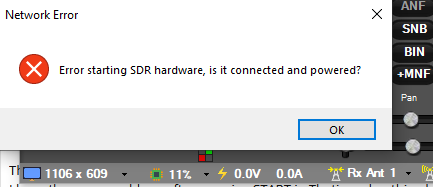

I have the same problem after pressing START in Thetis and nothing happens with the RADIO and finally I get the question ".....is it connected and powered". I quit this message 2-4 times and then the radio starts.kc2rgw wrote:Went from one of the k series pre-releases to 2.9.0.5, it needed a remove and a re-install, then no troubles. Symptom was, the radio just didn't "start", software powered up but nothing "running".
The power profiles are a great idea, thanks.
But this behavior is not reliable replicable.
I didn't find the reason for this.
Has any one an idea for this behavior?
73 Josef
this is a bug, and no, not a problem with the db, thanks for the report.dl5tt wrote: b) I can not increase the band width with the mouse wheel, if the "Low"-value is greater 0. Btw I am using this function in CW-mode starting with a filter width of 400 Hz.
Only if Low is 0, then the mouse wheel works in the upper direction. Is this a problem with my database?
re the connection issue. If this is intermittent then it could be any number of issues, from network, to hardware, to pc, to firewall, to other software running... etc...etc

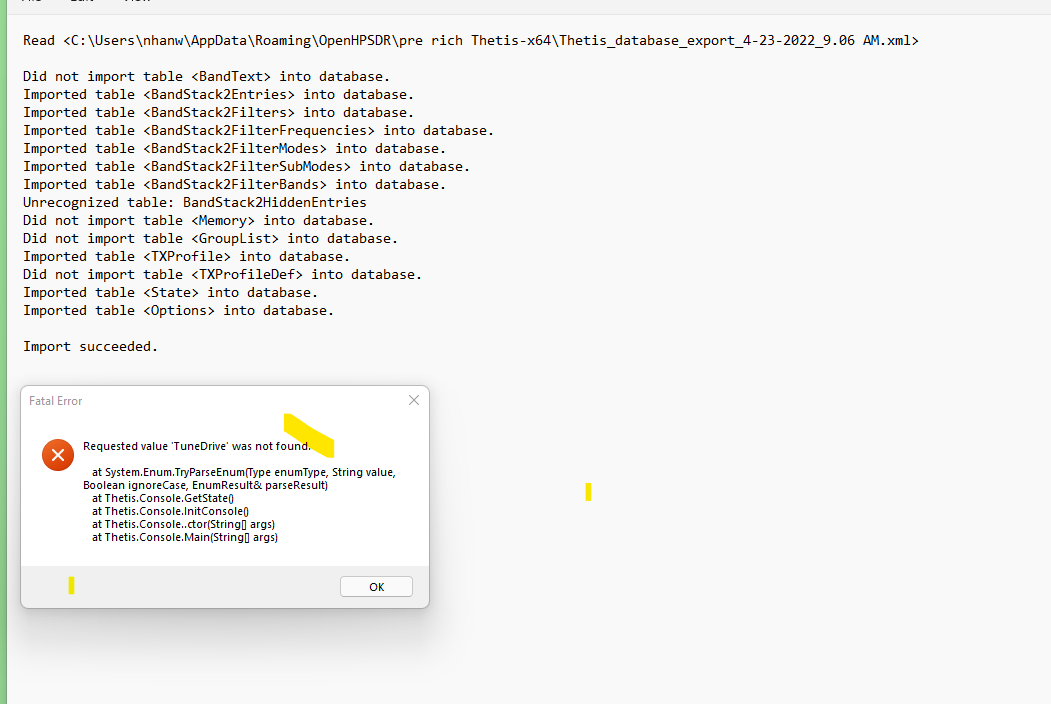

Downloaded the latest pre-release this morning, uninstalled previous version - directories gone and then installed latest pre release.
I get the following error message "requested value 'tuneDrive' was not found"
I then tried a totally clean install - by renaming data folder in Appdata
This time thetis loaded and ran but when I tried to import my old database file it again throws the same error after restart
Below is log file :-
Read <C:\Users\nhanw\AppData\Roaming\OpenHPSDR\pre rich Thetis-x64\Thetis_database_export_4-23-2022_9.06 AM.xml>
Did not import table <BandText> into database.

the install process has not put the exe on there that is required. You have at one stage had the correct version, but now you do not.
1) Run Thetis and/or Thetis x64 uninstall from add/remove programs
2) go to c:\program files\openhpsdr\thetis folder and remove any existing dll's/exe's
you should also check c:\program files x86\openhpsdr\thetis if you are running the x86 (32bit) verison
3) reinstall
try again

This is actually a bug, and I will need to re-release 2.9.0.5 by the looks of it. If anyone has had Tdrv selected as a button action this will error.vk6cpu wrote:Screen shot attached
Yes latest version
https://github.com/ramdor/Thetis-2.9.0/ ... .5.x64.msi
In the mean time, to get it working
1) edit your database.xml, and search for infoBar_button1
2) change <Value>Tdrv</Value> to <Value>Blobs</Value>
3) do the same for infoBar_button2
4) change <Value>Tdrv</Value> to <Value>Blobs</Value>
Sorry for this, somewhat of an oversight ! I will look at working a fix shortly.

Thanks - your latest release 2.9.0.6 solved my problem!
