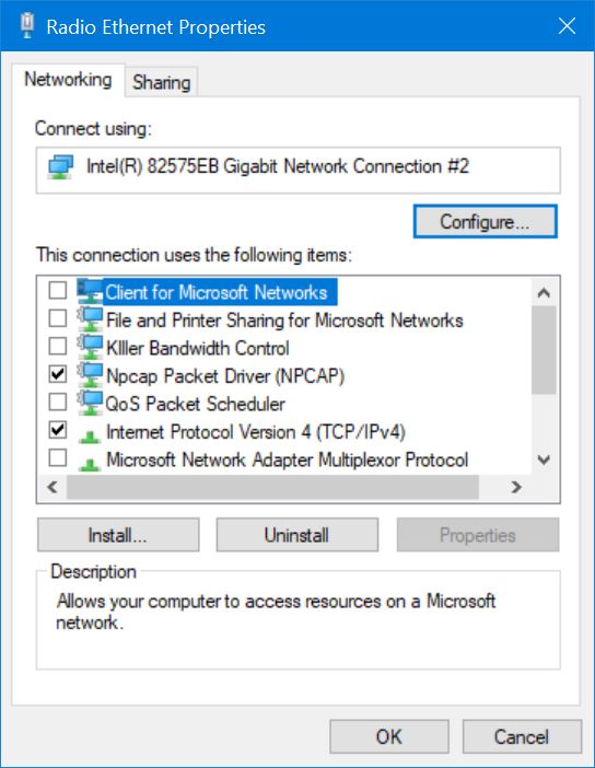

One of the great advantages of having a dedicated Ethernet interface is that you can disable all of the protocols you don't need on that specific port. I've got just two enabled:
Another great advantage is that you can tailor the interface advanced settings for maximum performance:
With the stuff you don't need disabled, advanced settings tailored (usually just a couple of small changes), and all the "normal" traffic being handled by the other Ethernet interface, everything seems to just work better.

1. Definitely set up static IP addresses on the second Ethernet interface and the ANAN. This makes the connection to the ANAN instant, there is no waiting for an APIPA address to sort itself out. This must be on a different subnet than the main interface. E.g. if the main interface is using 192.168.1.x the ANAN interface and the ANAN must use 192.168.2.x.
2. Make sure the network metric settings on the two interfaces favor the ANAN interface (smaller metric value on the ANAN interface). This might slow down web browsing a tiny bit, but again every advantage you give the ANAN interface helps.

Why do you enable TCP/IP on the radio-dedicated NIC?
Don't we use UDP/IP only?
w9mdb
Posts: 465
Re: Dedicated Eathernet Card
Post by w9mdb »
The TCP stack provides UDP.
It's not a separate selection.
No harm since TCP won't even wake up unless it's used.

This is kind of what I thought. Since I saw no issues up front I went back and reset everything to default except for the changes you suggested. Somewhere down the road I'd have an unexpected issue and would have completely forgot I had made changes to the NIC. I did have a previous dual port NIC that was flaky to begin with. I tried some of these changes and it didn't like any of them. Any change at all and it would completely quit working. The one I have now (I forget the brand) has been working well. I had also forgot those other tweaks existed until this topic popped up. I thought I'd just try them on this NIC. I knew there were tools , but had no experience with any of them.
Being retired now I'm constantly experimenting with different things. Both with the radio and. That's why I'm not reporting a lot of issues I have. I am normally creating my own problems.
