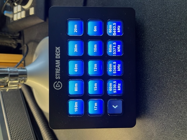

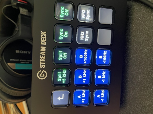

Photos attached. The camera angle distorts some of the labels.
The top image shows the home layer, followed by the VFO and Bands sub-layers. Gary created this hierarchy to get many more functions out of 15 buttons.
Anyway, this is a good start..
