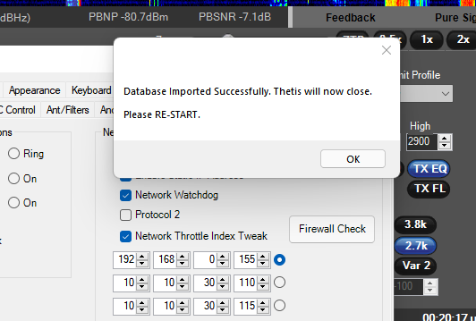

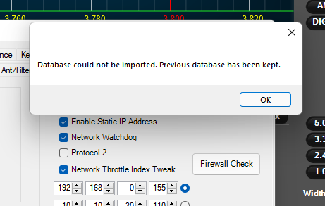

so you do not see in a popup window?
Database Imported Successfully. Thetis will now close. Please RE-START.
or
Database could not be imported. Previous database has been kept.
If not, the popup might be appearing behind setup window, or on another screen? Can you click setup or thetis when this happens? Or is it seemingly 'locked' and makes a beep sound ? If that is the case, then a new release at some point will see those msg boxes put 'on top'.
Works fine here fwiw.
or

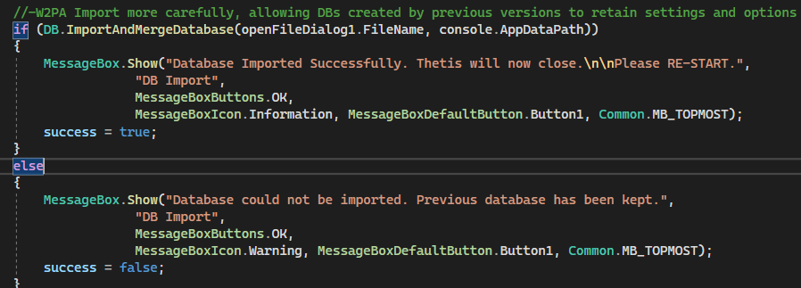

you will either see 'imported successfully' or 'could not be imported'
You will get one or the other, it is impossible not to get one of those as you can see from the code. I changed the code to always TOPMOST the message box in-case it was behind something which will be in the next release at some point. It may also be a read permission issue which is causing the openfile dialog box to fail.
