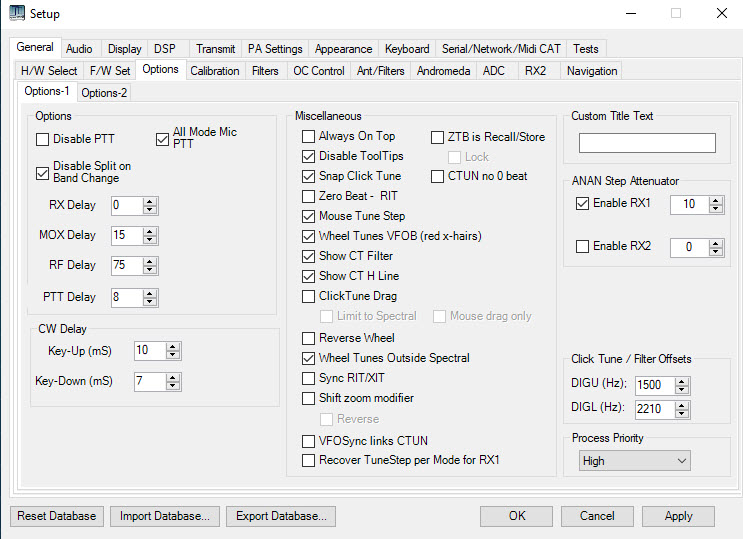

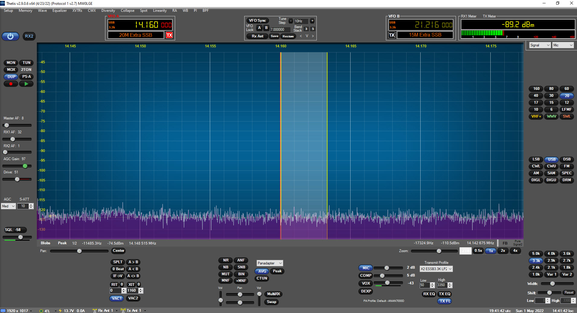

I am on Thetis 2.9.06 x64 and attempted to adjust TX bandwidth using my mouse but it didn't pan out. No doubt my settings aren't right.
Two screen-captures below for reference.
Setup Options.jpg (134.32 KiB) Viewed 9901 times
Screen capture May 1.jpg (410.16 KiB) Viewed 9901 times
What am I missing?
JJ

There is no interactive adjustment of the TX transmit bandwidth in the spectrum when in receive. It can only be done using the up/down number controls on the main gui (just above the TX FL button), or in setup in the Transmit tab (Transmit filter).
It can be adjusted with the mouse in the spectrum when in TX, however there are some issues with it which need to be fixed. I have never used it like that personally.
Remember, TX bandwidth is stored per TX profile, so adjustments you make will be temporary unless the TX profile is saved.

You tried while TX'ing? As Richie states it only works while in TX and even so there apparently are issue. Your screenshot shows you in receive so just wanted to make sure this was clear.

As Richie wrote, there are some issues with it. I can report that it doesn't work for me here, I.e. I cannot adjust the TX passband graphically when in transmit.
What I normally do is turn on the TXFL lines and then use the TX passband controls to adjust my TX bandwidth until the lines match up with the bandwidth of the others is the QSO.
Posts: 1596
Re: Can't adjust TX bandwidth using mouse
yeah it is totally broken atm. I will look at it at some point.
