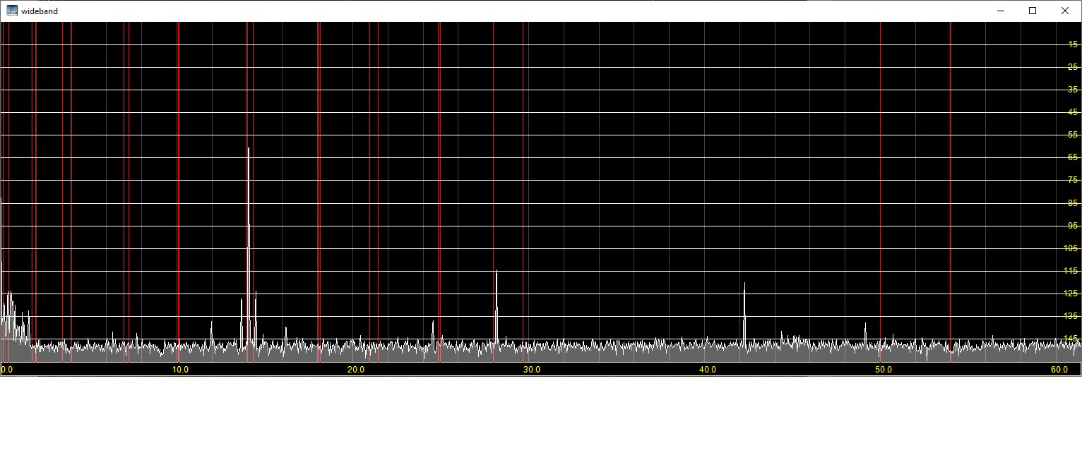

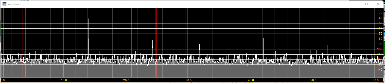

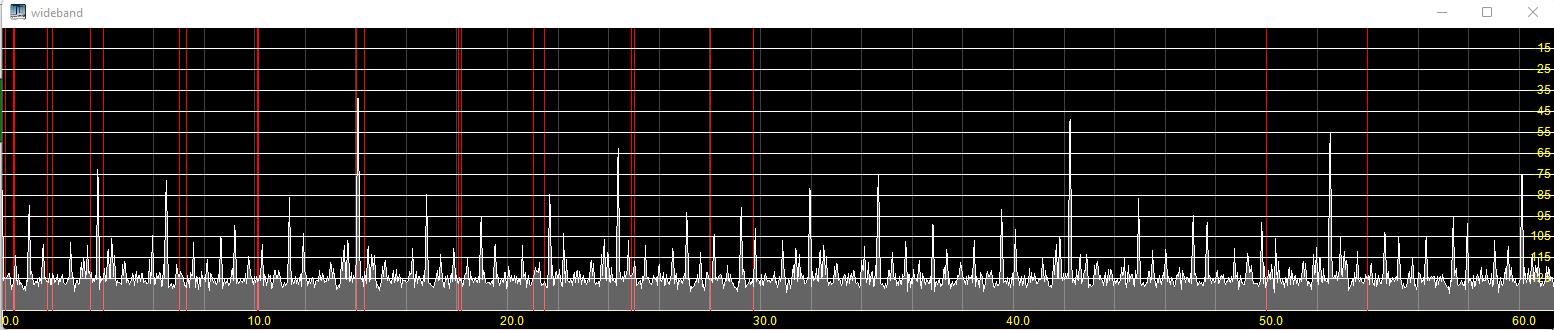

Does this look normal? 14.074 transmitting.....spurs are very inconsistent....biggest appears to be just above 42MHz and then around 53MHz on the 2nd biggest spur.

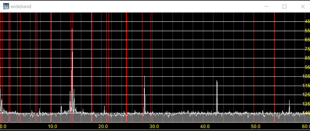

This is what mine looks like when transmitting on 14.074MHz: Conditions are an ANAN-8000DLE, KPA1500 amp at 1500W, PureSignal activated, feedback is from the KPA1500 internal coupler.
Yours looks like there is a serious problem somewhere. Under what conditions was it captured?

That was full power 100W out of the rig -- no amplifier -- into a dummy load.

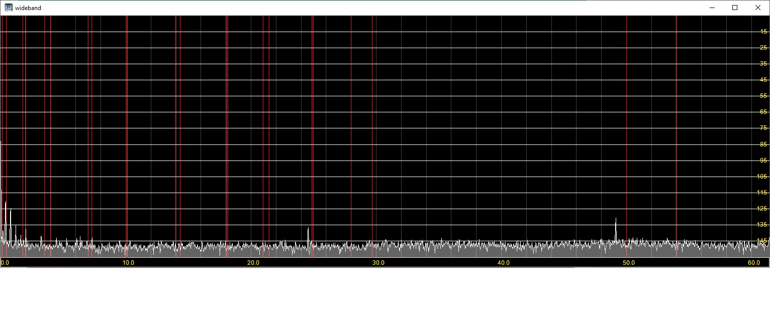

If I drop the output power to 4W I get this And at 6W the spurs suddenly jump up and look more like yours. The difference I see now is that at 6W Thetis is claiming ADC1 overload and at 4W the ADC1 overload goes away. And this is controlling power by using the volume slider in JTDX and not the drive in Thetis -- drive is at 100.

Something is badly wrong. None of those little spurs should be there. You should be seeing even numbered harmonics only.
The ADC overload indication is also a bad one.
What version of Thetis and what version of firmware are you running? I'm suspicious that the firmware is not closing timing properly on your hardware. If you are running 2.1.18 you might try 2.0b.

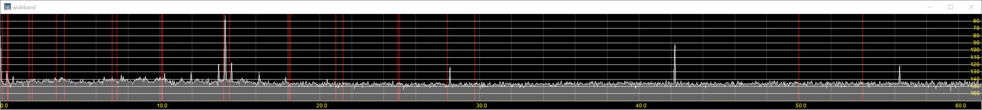

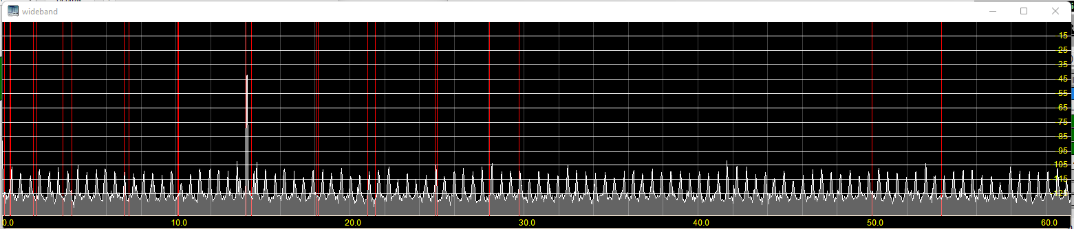

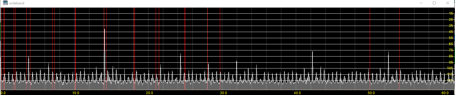

2.0b only slightly better. I was using the Tune from JTDX earlier -- this is with Thetis Tune button on a dummy load. 14.074Mhz (seems the same on all bands).
Spurs jump up from drive level 5 (4.9W) to drive level 6 (5.9W measured by my LP700) and about 15dB it appears.
At 4.9W looks like this At 5.9W looks like this -- where could the 24MHz spur be coming from? The 28MHz makes sense as the 2nd order harmonic.

Mike--are you running PureSignal while doing this or not? If not, please try it that way just to get a little more data. Also try two-tone so we can see what that looks like.

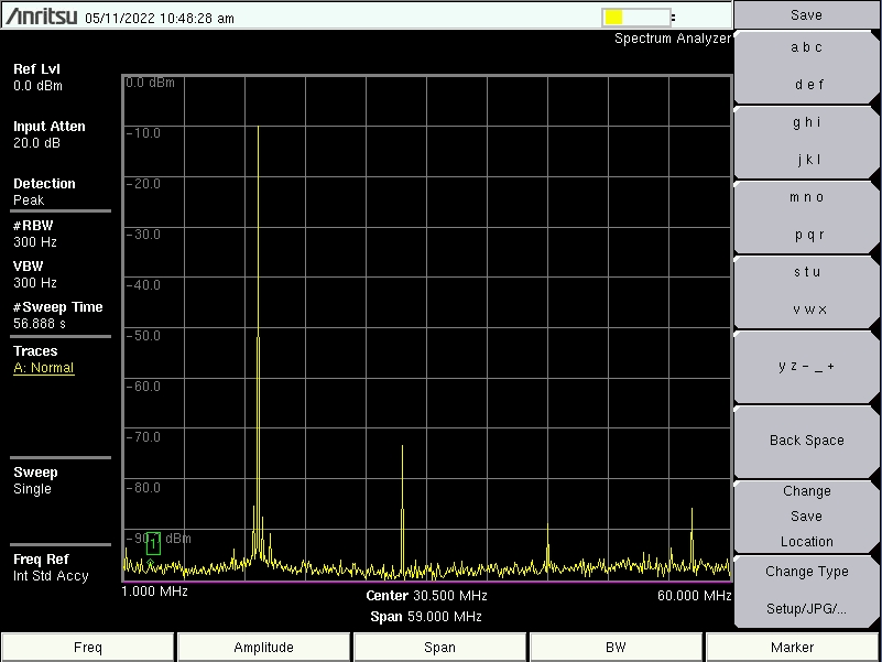

Just a measurement observation in response to Scott's earlier question and not relevant to W9MDB's issue...
Shown below is a 1-60 MHz transmit sweep measured with an Anritsu MS2721B analyzer. Test conditions:
ANAN 7000DLE with Orion MK II
5W WSJT-X carrier at 14090 kHz
RF sampled at dummy load with a Bird 4273 coupler
Analyzer set to 300 Hz RBW, 10 dB/div
The second harmonic is about 5-7 dB less than that shown in Thetis' BW sweep. I'm not sure if this difference is real or a level disparity between the BW and normal pan presentations in Thetis. So, it's inconclusive as to whether higher second harmonic content is truly measured in Thetis' WB display.
