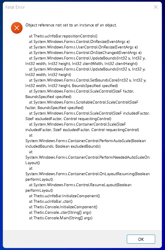

Out of the blue I seem to get this Fatal Error (Screen shot attached) when I try to open Thetis. I have uninstalled, reinstalled, uninstalled reinstalled latest version, same result. I can no longer get past this fatal error when trying to load.
Thoughts?

Try renaming the database in this location
C:\Users\[username]\AppData\Roaming\OpenHPSDR\Thetis-x64\DB_Archive
If that works attach the corrupted database file and maybe somebody can figure out a fix.

Appreciate the reply, however there was no database to rename as it never loads enough to create one. I thought this might have to do with the 2 video cards, however, that is now ruled out. This is a Windows 11 issue. It looks like the older Thetis and the new one both have same issue with Windows 11.
Same issue on 3 different windows 11 machines, no issues on a win 10 machine.

Sorry but I have to ask this, are all of your Windows 11 machines 100% W11 compatible (and W11 was installed by Microsoft's updater), or did you possibly sideload W11 on your own?
I ask because if there's not 100% CPU compatibility with W11 then that might explain the difference in behavior between the operating system versions.
Re: Fatal Error
In Windows Settings > Display, try changing your scaling factor to 100% if it isn't already.

Scalling was the issue. That messes me up in some other stuff, however I will find a way through it. Thanks and hoping that it can be addressed. 100% on a 4K 50 Inch display is literally a headache for the eyes.
Many thanks and yes, the machines are all Windows 11 compatible, no tricks, they are all relatively modern.

Looks like it should be an easy fix actually.
I'd take a look at it but 2.9.0.3 is the most current version in the git repository.

NI0Z wrote:Scalling was the issue. That messes me up in some other stuff, however I will find a way through it. Thanks and hoping that it can be addressed. 100% on a 4K 50 Inch display is literally a headache for the eyes.
Glad I guess right :)
I run triple, 28", 4K displays. I use 150% scaling with no problem at all. Does 150% work for you?
Re: Fatal Error
w9mdb wrote:Looks like it should be an easy fix actually.
You are looking at the wrong repository. Look to Richie's GitHub repo here: https://github.com/ramdor/Thetis-2.9.0/ ... g/v2.9.0.6. The source code is there for the taking.
You can also go to the top level of Richie's repo and see what else he is working on.
People would be very happy if you fixed this.

Here's a new executable which hopefully fixes the scaling problem.
https://www.dropbox.com/s/7e40ygtnz7uhx ... s.exe?dl=0
Re: Fatal Error
Did you submit that back to Richie via his Git repo? He would certainly appreciate it if you did.
w9mdb
Posts: 465
Re: Fatal Error
Post by w9mdb »
Pull request has been submitted
