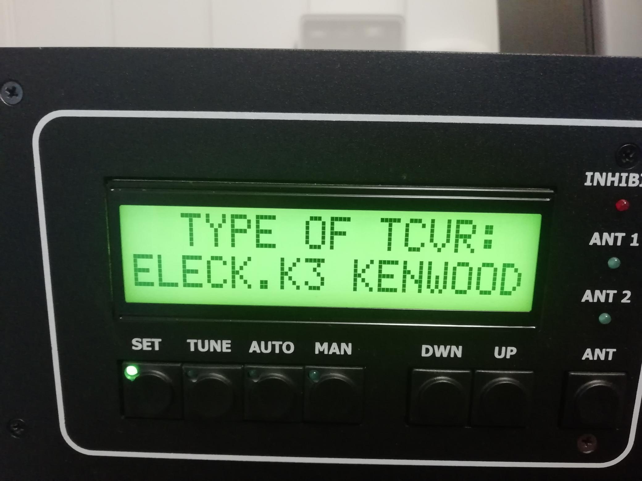

OM calls this setting "ELEC.K3 KENWOOD" as pictured below. Much like Thetis, the K3 supports Kenwood commands as part of the CAT interface. It's very likely that the OM is using the Kenwood FA, FB and FT commands to determine TX frequency.
19K2 in OM Cat Menu
Baud rate shouldn't matter as long as they are matched on both sides. What did you use for parity, data and stop bit settings in Thetis?
