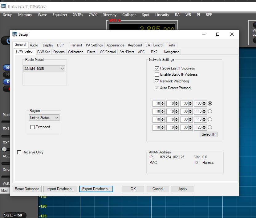

I have an accurate HP signal generator. The first time I fired the radio software up the signals were weak when compared to using thetis on another laptop and my 10-E. Same antenna and coax. I tried calibrating using my signal generator which only slightly changed the S meter and panadapter. The signal levels I am referring are not an s meter issue but a higher noise floor as opposed to signal levels, people are very hard to hear when compared to my 10-E and a little older version of Thetis. Here is the pic I tried to upload showing the issue with trying to downgrade to PowerSDR to see if I had the same issues using it.
wrong firmware delete.JPG (33.71 KiB) Viewed 17936 times
Posts: 6056
Re: New to me 100B signals lower than other radios.
cleanrf wrote:I have an accurate HP signal generator. The first time I fired the radio software up the signals were weak when compared to using thetis on another laptop and my 10-E. Same antenna and coax. I tried calibrating using my signal generator which only slightly changed the S meter and panadapter. The signal levels I am referring are not an s meter issue but a higher noise floor as opposed to signal levels, people are very hard to hear when compared to my 10-E and a little older version of Thetis.
Words are important: I'm assuming what you are saying here is that the signal levels are correct but the noise floor is high. Is that right? Because a high noise floor is a very different problem than "weak signals". A high noise floor is often indicative of something wrong with the firmware.
Please post a screen shot of the Thetis Setup > General > H/W Select screen so we can be absolutely sure of what firmware is being detected by Thetis.
That implies that something is wrong with the firmware as well.
It may be that you need to reload the firmware in this particular 100B.

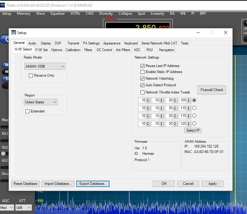

HW select screen delete 2.JPG (98.52 KiB) Viewed 17878 times
Posts: 6056
Thanks. Results confirm expectations, i.e. Protocol 1, version 1.5 firmware.
Any improvement or changes with 2.9.0.6?
Any actual measurements done with your signal generators? It is important to know if the signal levels are accurate and that this is a noise floor problem. If the signal levels are accurate then they are not "weaker".

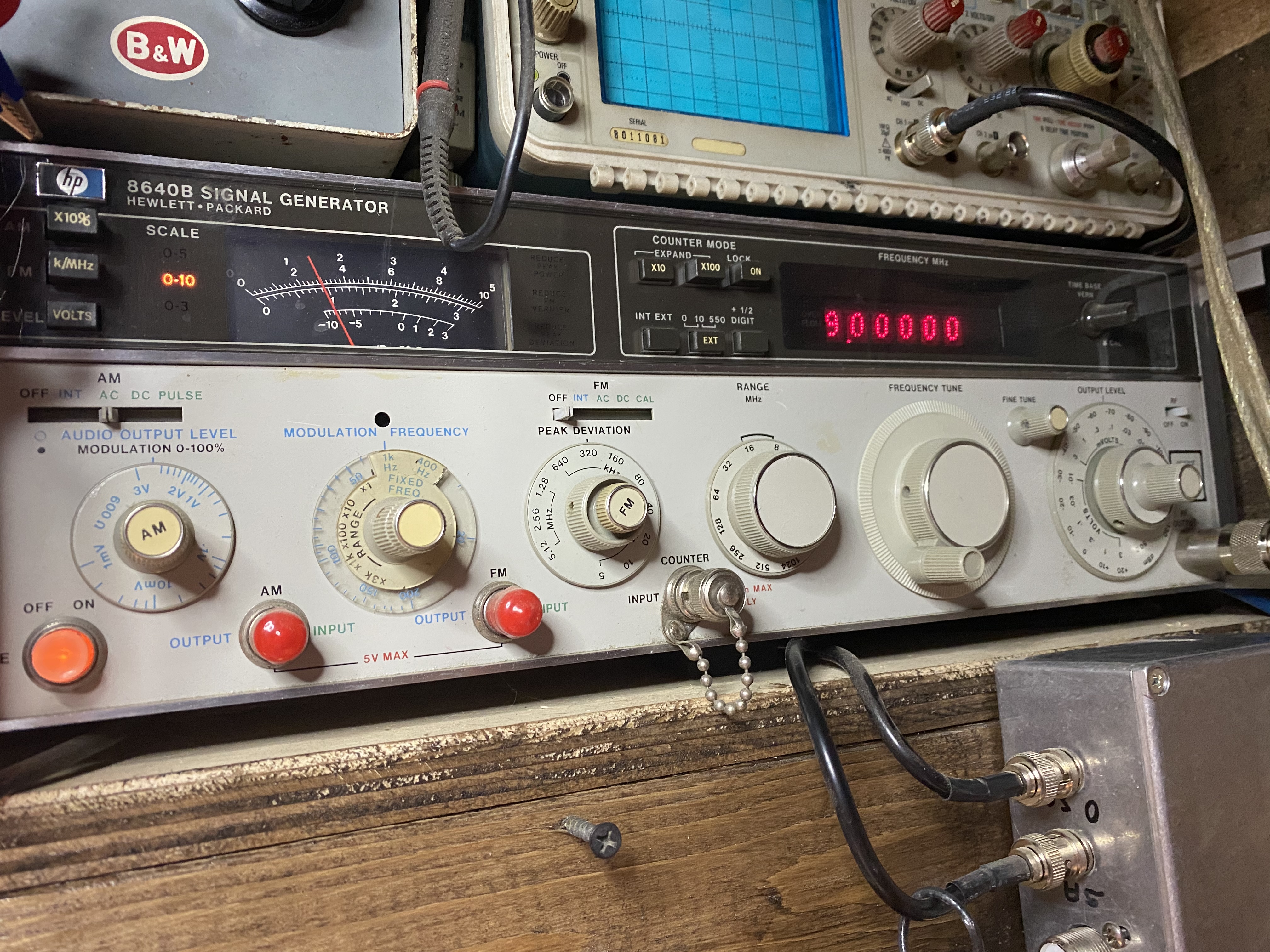

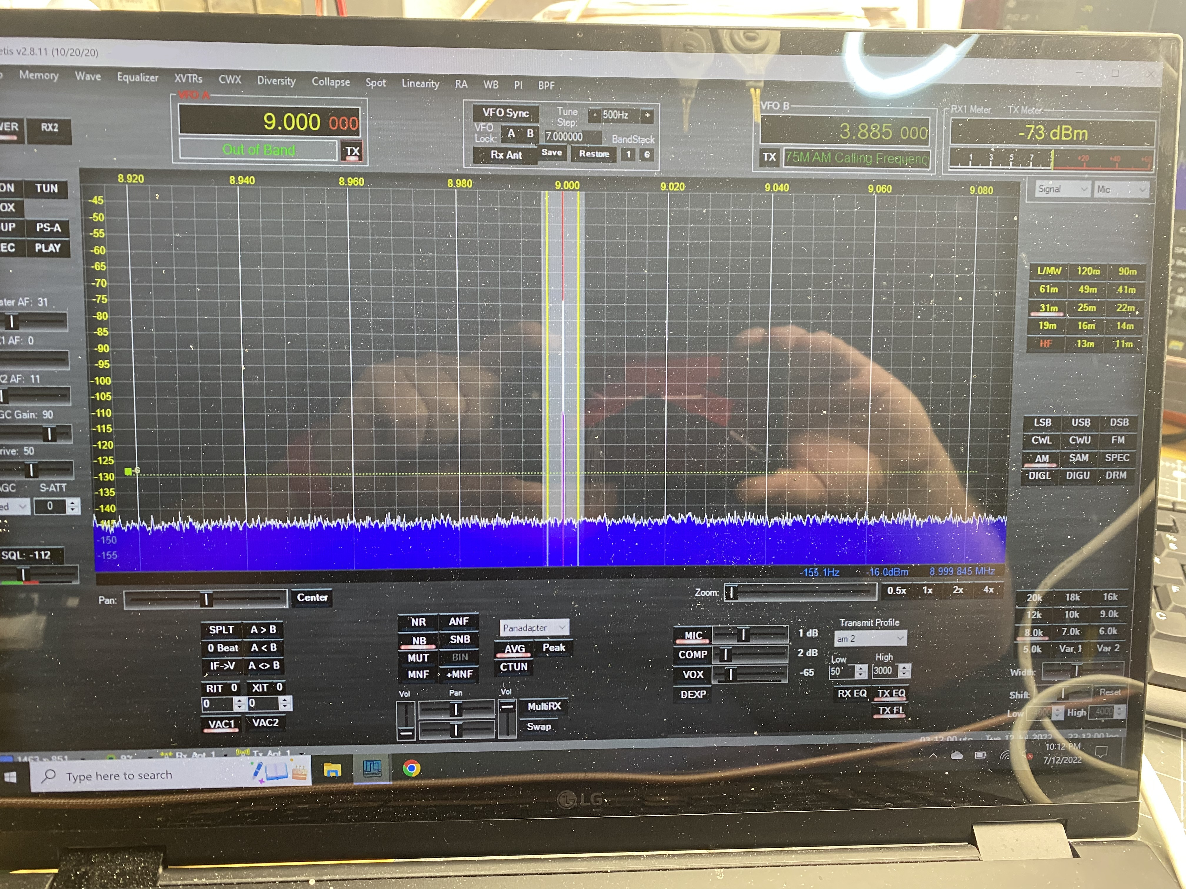

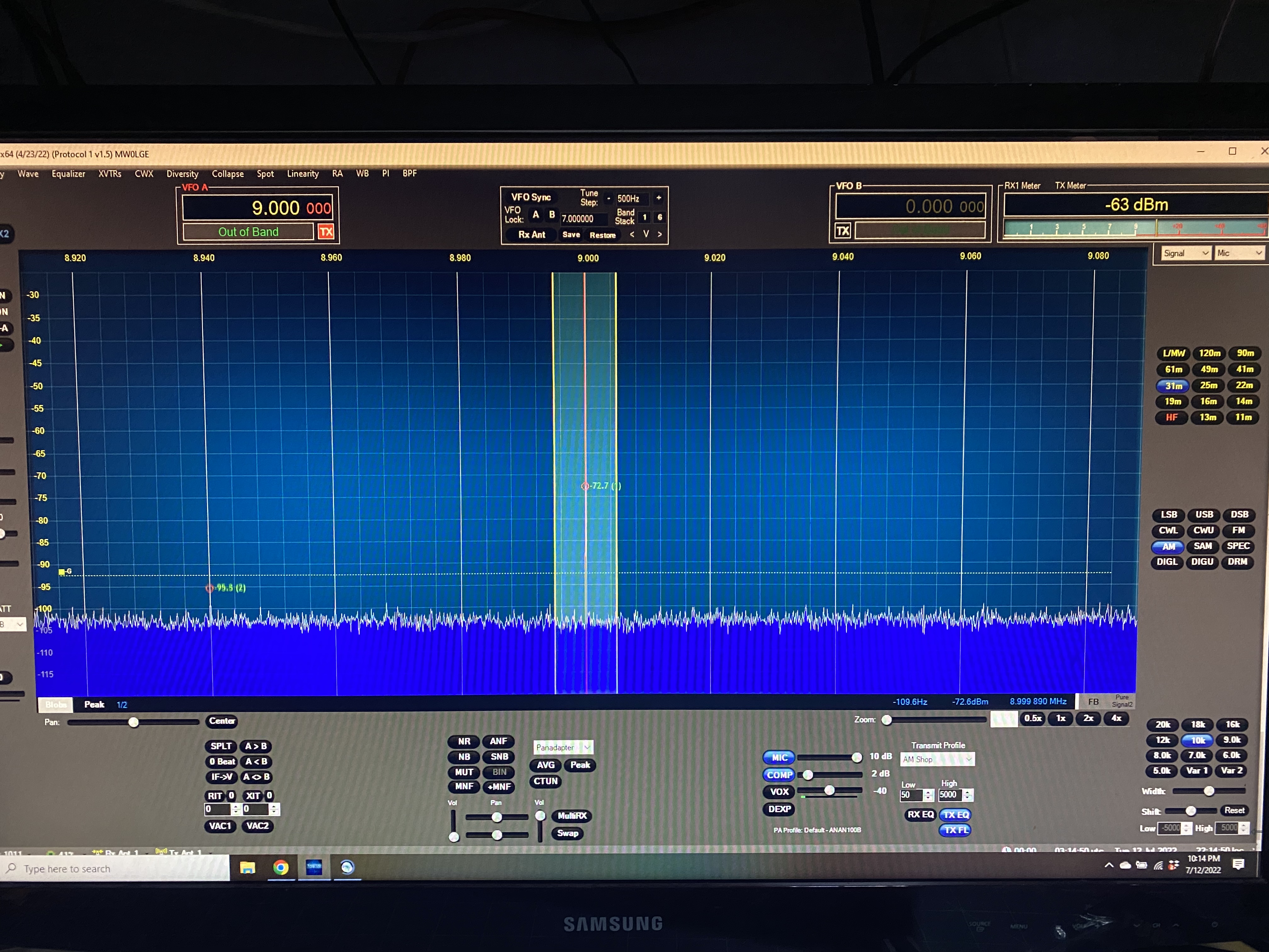

In the pictures below the 10e on a laptop and the 100b on a desktop are next to each other to perform the test. Signal from the sig gen is set at -73 dBm at 9.000 mHz and connects to each radio and the calibration was run. Below I’d the difference. The 10e shows -73 dBm with the noise floor around -145 dBm, the 100b shows -63 dBm with a noise floor at 102 dBm.

That doesn't make sense. If you calibrated both rigs from that signal generator, they should both read the same signal strength. Your signal generator is set to -77dbm, but if you ran the calibration in Thetis at -73 that's what the signal meter in Thetis should read.
I'd still try different firmware. If that solves anything you can go back to the latest and greatest to see if the issue comes back. Try the other antenna ports if you haven't already. Also make sure diversity is disabled on both rigs. The gain settings there can skew what you're seeing,

Your photos show a signal level of -73dBm on the panadapter in both cases. The S-meter on the affected system is showing -63dBm because -100dBm of noise at the panadapter resolution bandwidth integrated over the 8KHz passband the S-meter is looking at is approx. -63dBm. So it's not a "weak signal" problem, it's a high noise floor problem.
Try reloading the firmware on the affected system. Try also down rev'ing it to 1.3.

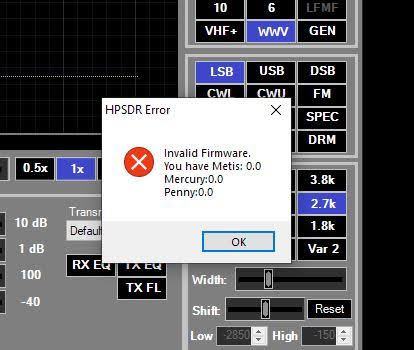

Scott, can you point me to a thread that explains how to do this? I tried following the instructions in this thread https://apache-labs.com/community/viewt ... =18&t=2333 and it when I attempt to start HPSDR Bootloader I get this error. Thanks

ea3aqr
Posts: 313
Location: BCN
Post by ea3aqr »
You have to install WinPcap or Npcap to solve the missing DLL problem:
WinPcap: https://www.winpcap.org/
Npcap: https://npcap.com/
