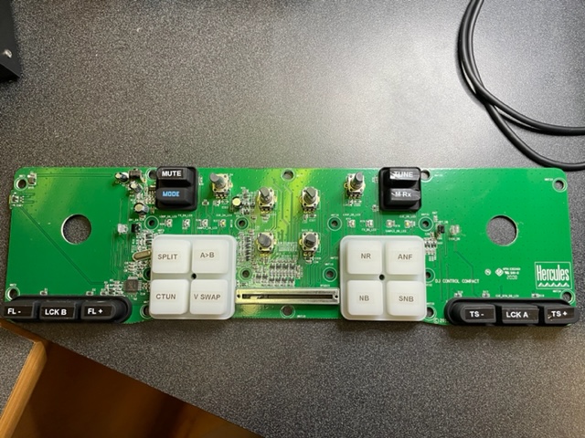

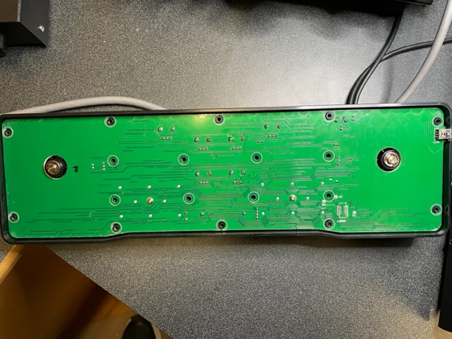

The images below show the DJC-Compact's internal PC board. Disassembly and board removal was easy and only took a few minutes.

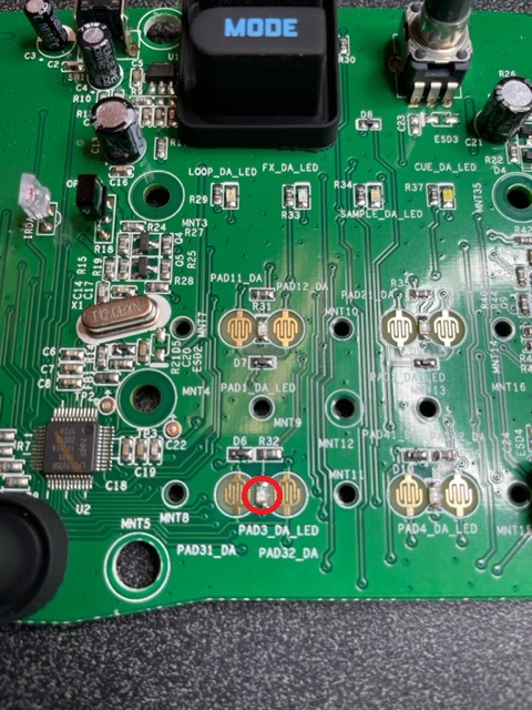

The first image shows a red circle highlighting the defective LED. Before removal, I verified that the series current limiting resistor had not changed in value; it measured identical to the other current-limiting resistors.
The LED was swapped with an alternate on the board that's only pulsed periodically. It's a temporary fix until some industrial-grade LEDs are received from Mouser. The blue LEDs are standard 1206 SMD/SMT. I'll report back with the Mouser P/N after replacing all affected LEDs.
I'm not sure why these LEDs are failing apart from manufacturing defects. They're operating well within a normal forward current range.

Follow-up...
I ordered three different types of blue SMD LEDs, each with a different luminous intensity (mcd) spec. I tried 72, 100 and 120 mcd. True to specs, the light output does change relative to the mcd value. The 120 mcd LED produces a blue light intensity closest to the original. It's a Dialight 598-8291-107F.
https://www.mouser.com/ProductDetail/Di ... 26JA%3D%3D
You may not experience the same LED failure with your DJControl Compact MIDI controller. But if you do, the Dialight brand is a good choice; they're highly regarded in the electronics industry.
