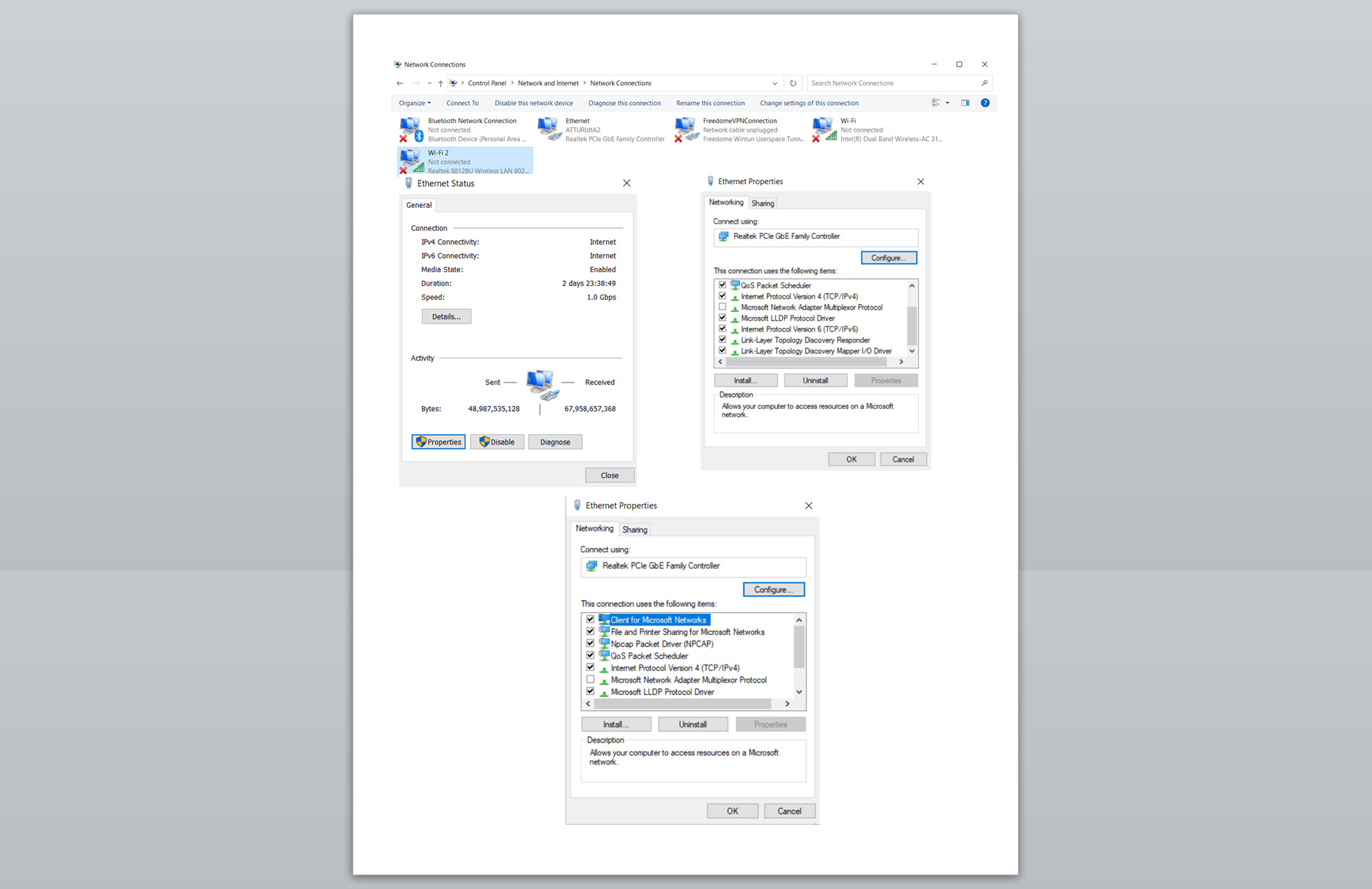

1. Have you properly set your network metric settings? See steps 6 and 7 at this link: http://www.w1aex.com/anan/anan.html#network
2. Strip out all the unnecessary protocols from your Ethernet interface to the ANAN. See an example of all I stripped out at this post here: viewtopic.php?f=22&t=4342#p21860

Not that I have any real serious issue with "superfluous" Ethernet connections, but there are some unnecessary connections that I may want to strip.
On the Ethernet LAN, there are no connections (all cables terminate in an unmanaged T switch) other than:
1. CAT 8 cable from the modem
2. CAT 8 cable from PC
3. CAT 8 cable from ANAN 7000 DLE MKII
4. CAT 8 cable from RS2K-S SSPA
My PC has two WiFi radios, one that is built-in and the other is extra, external one that I have plugged into a HUB hub.
I don't really need any WiFi functionality (I have another PC on another desk that I can use) so I would imagine that keeping those switched off is fine.
Don't fix it if it ain't broke is a good principle to go by, but perhaps I should make some changes to the current configuration. At least, if they help with getting the ANAN to work even better.
Below, see a few images.
