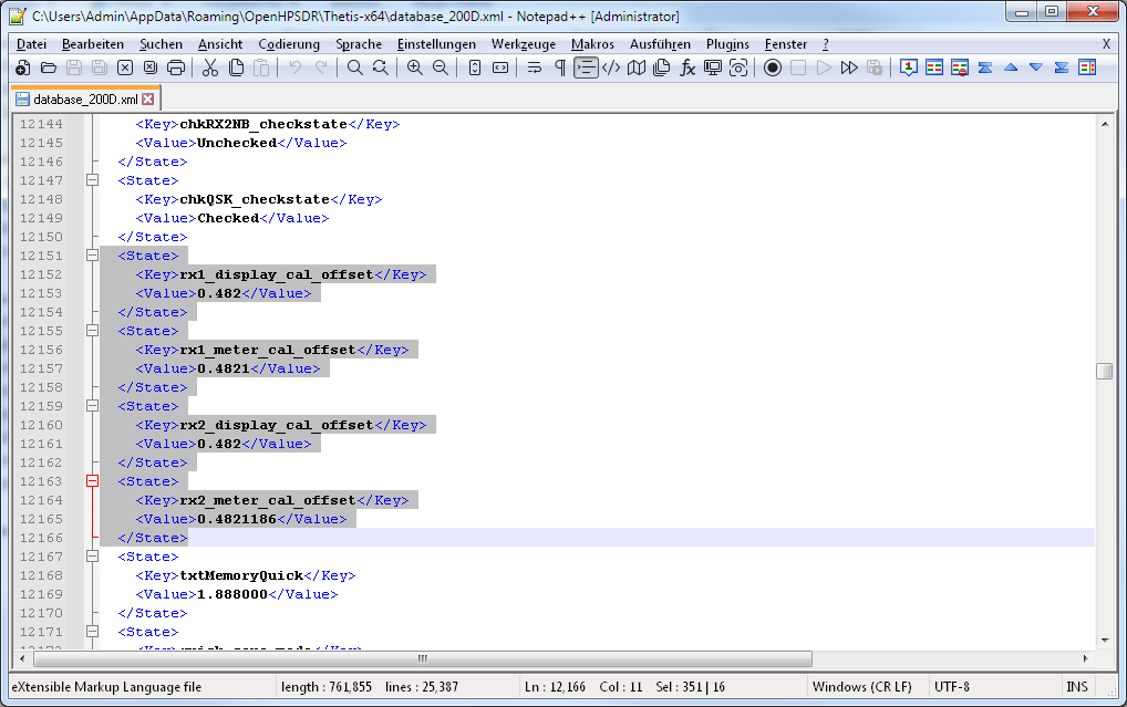

Post by DL2XY »
Or you may try to patch the database directly.
Setting the values to zero would reset the calibration.
Database RX Calibration.png (69.18 KiB) Viewed 11412 times

IIRC, there are many, many more places in the database than those that are touched by the calibration routine.
