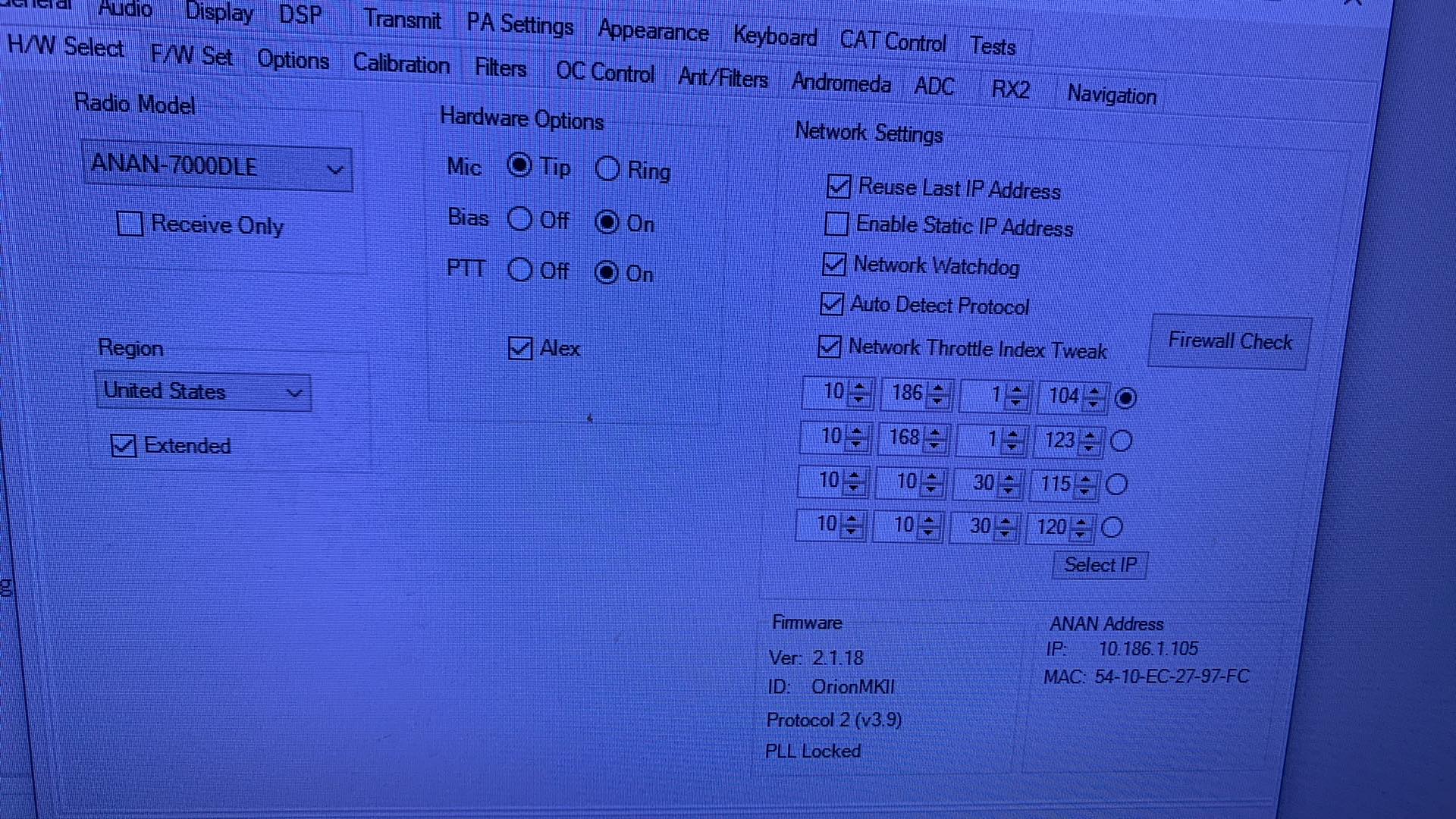

What sort of mic, how is the mic connector wired, and what are your settings in Thetis for mic, bias and PTT?

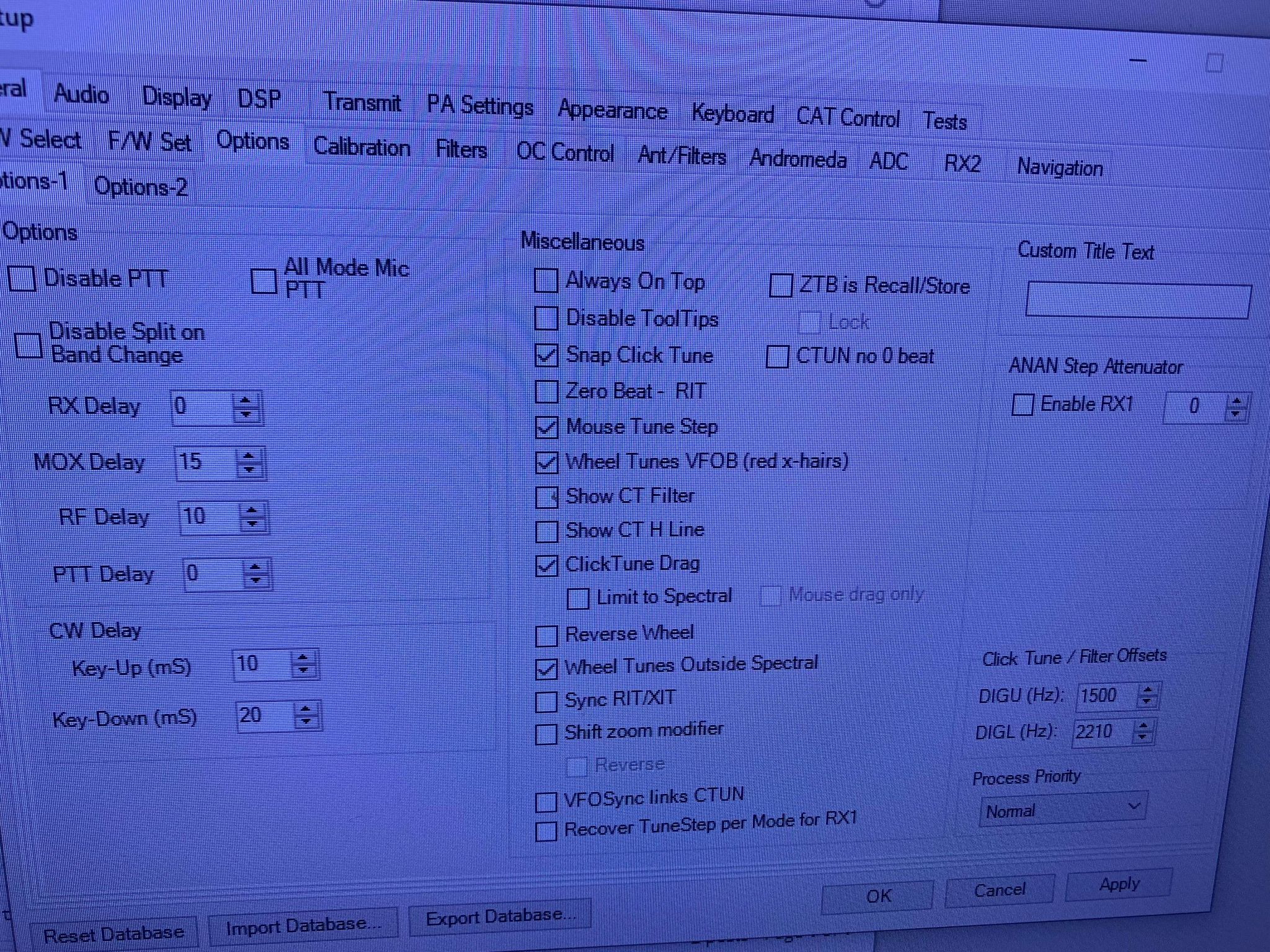

1) In the H/W Select tab the Hardware Bias Option should be Off for a dynamic mic.
2) In the Options-1 tab the All Mode Mic PTT is Enabled in my setup (not sure whether that matters).

Unfortunately you did not fully answer my questions.
How is the mic wired to the mic TRS connector? It is almost certainly wired wrong and is being shorted out when you use the hardware PTT switch. The PTT connection on the rear panel is electrically connected to the mic connector. With the settings you have the PTT signal is present on the ring terminal of the mic TRS connector. When you activate PTT the ring terminal will be shorted to ground.
