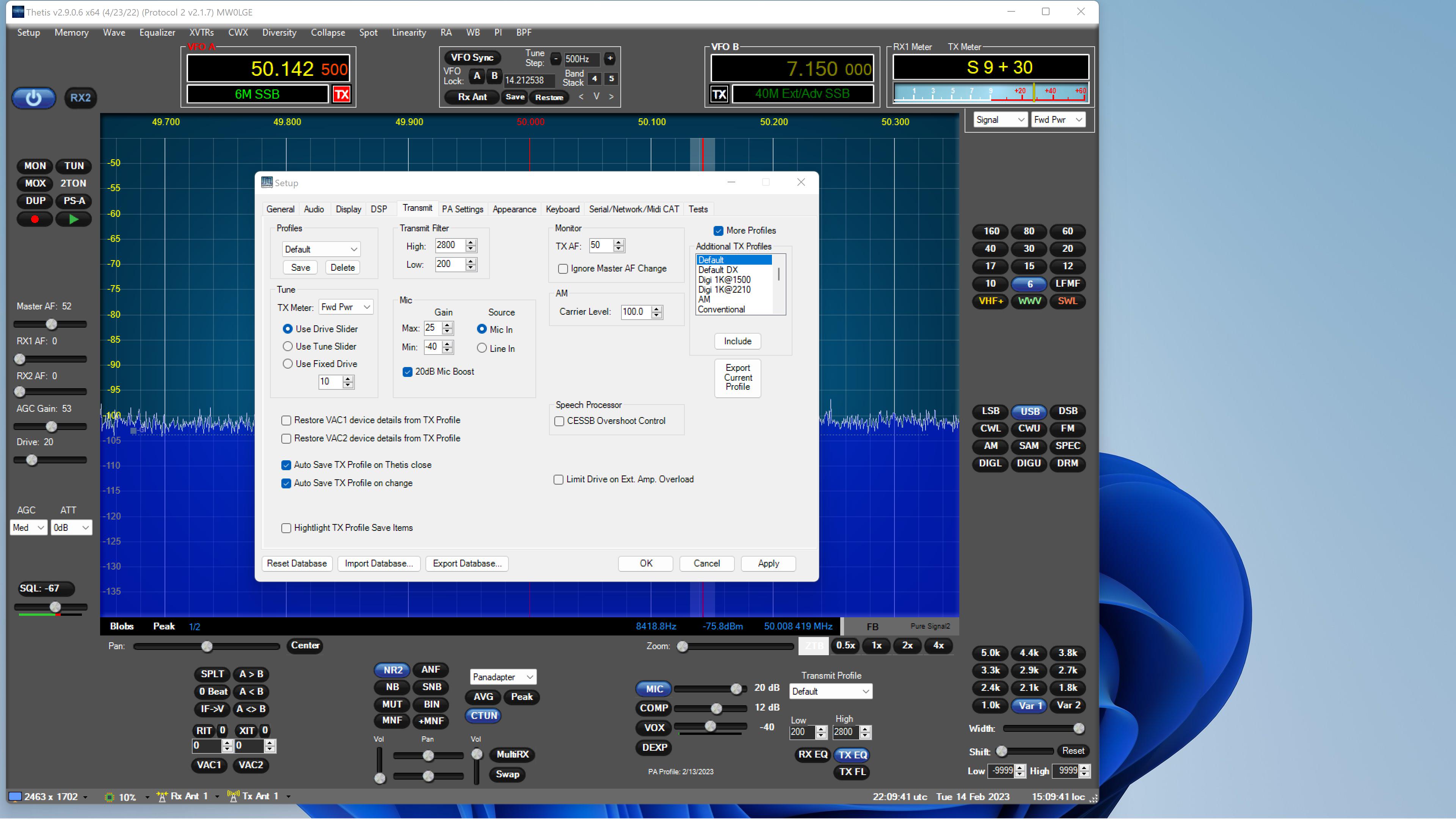

Third, are you using the same Transmit Profile for SSB on all bands? If not, you might not be getting the same audio drive on each band. Make sure the transmit profile is set the same on all bands.

I am using the default Tx driver, I didn't know you can use a different driver for each band. I'm also using the Drive Slider.
transmit driver
transmit driver
Screenshot (13).png (915.3 KiB) Viewed 12777 times
