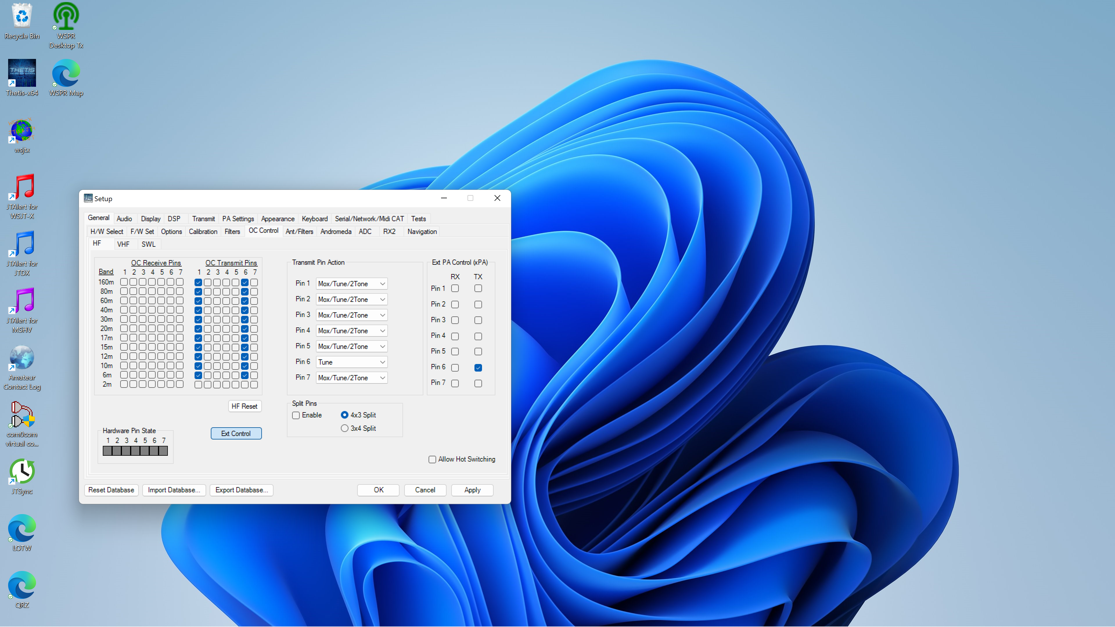

I am trying to set OC control to pull to ground on pin 6. I have clicked XPa on, but when I click TUN on nothing happens on pin 6.

I did just what you suggested above. And the OC settings in the screen shot. The OC pin 6 did not pull to ground.

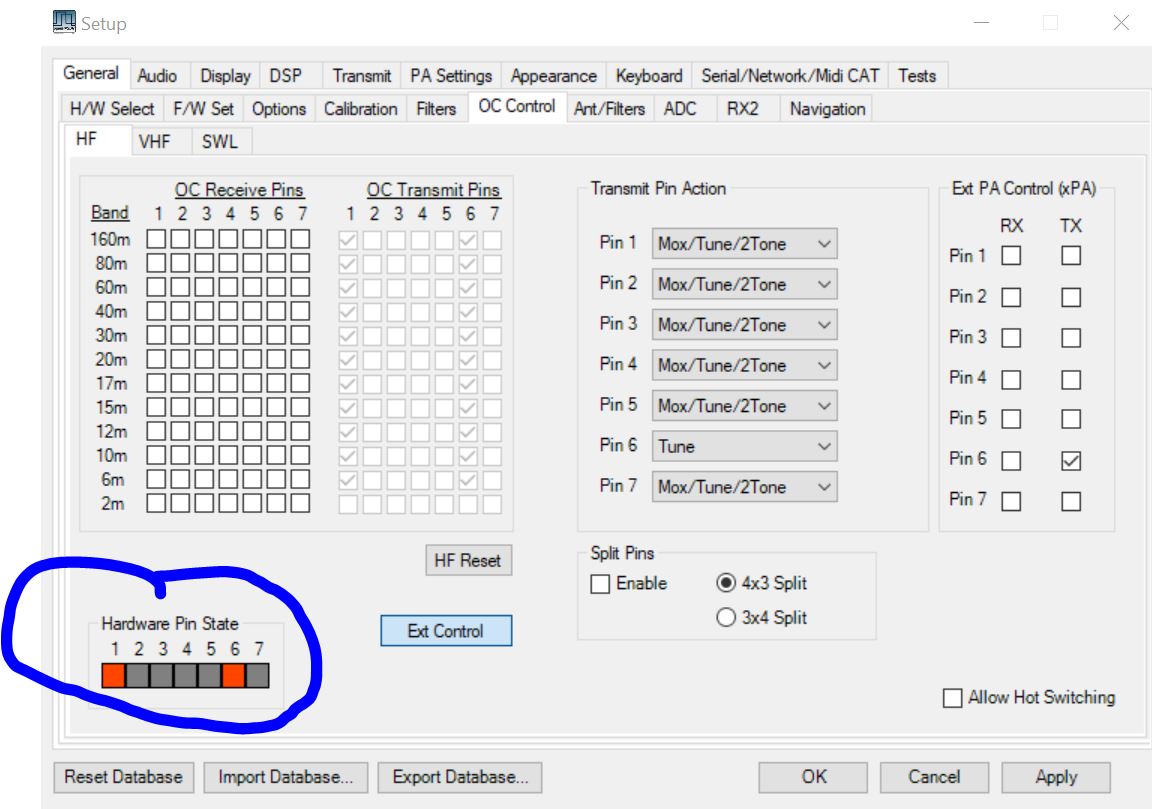

Re: OC setup for Tune
With TUN and xPA asserted
and the OC settings the same as yours, I get the hardware pin state shown as circled below
Do you get that same state shown? If so, then perhaps your wiring is not correct on the OC outputs?
Yes, I get the same hardware pin state as yours. I will double check the wiring.

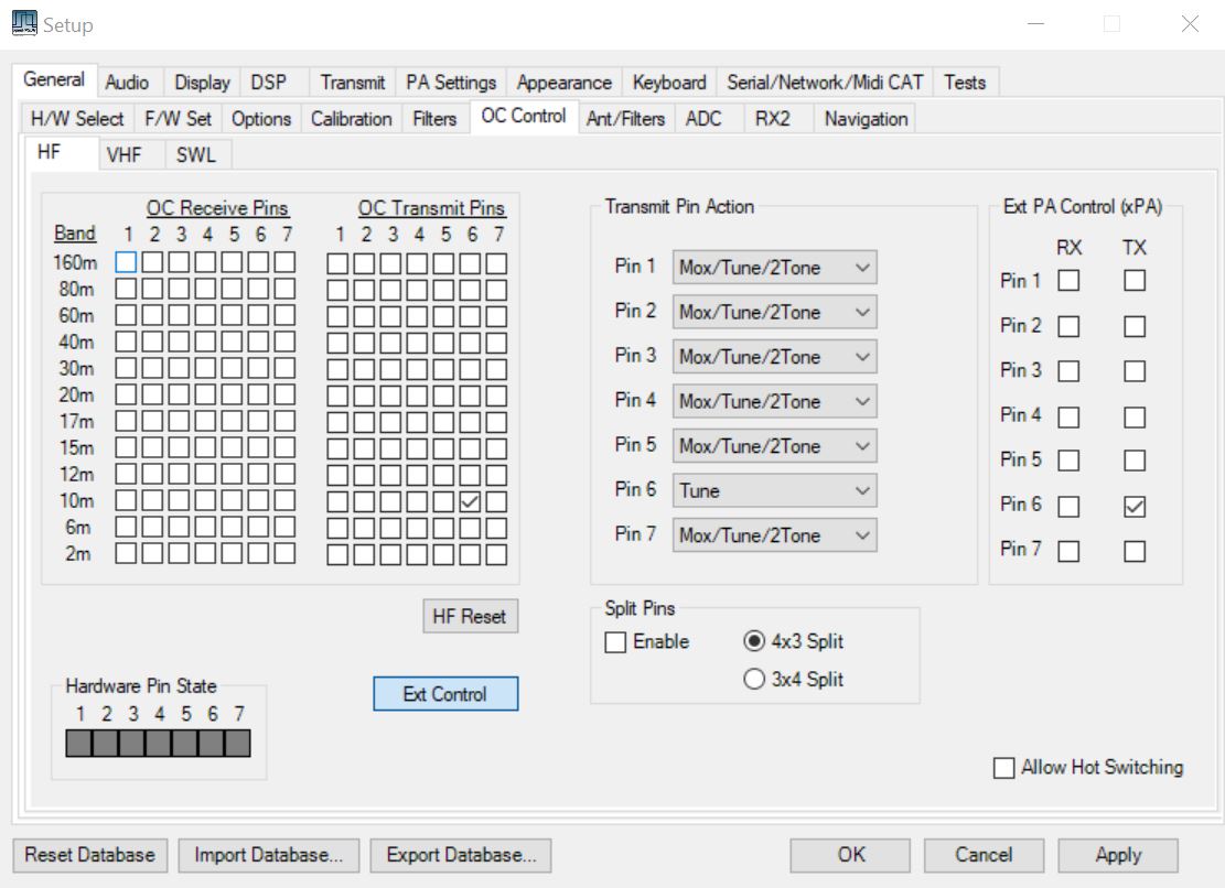

OK, I've checked the wiring, and it is all OK. But on further experimenting I found that when I change OC transmit pins to 4 then pin 6 goes to ground when I tick TUN. I also found out that while I have Transmit pin action pin 6 set to only TUN, if I tick MON or 2TON they also cause pin 6 to go to GND. And they all go to GND even if I untick xPA. Something is screwed up, or I am not doing something correct.

It sounds like there are two different sets of issues going on.
First, there seems to be some confusion about how to set up a pin to only assert itself on TUN.
When I have things set up as shown (just on 10M to save a lot of clicking), in the Hardware Pin State display pin 6 only asserts when TUN is asserted when xPA is turned on. With any other action: MOX, Two Tone, PTT, pin 6 does not assert. With xPA turned off, pin 6 never asserts.
Second, there seems to be some confusion about the physical pin. Unfortunately I'm not in a good position to investigate this because I operate from a second floor office and my hardware is located two floors below in a rack in the basement. If you can find the pin that works, just use that pin even if it is the wrong one (although it would be nice to know what's really going on).
I can't duplicate your problem. Using pin 6 for example...There is still a little glitch in Thetis. If I don't check TX corresponding to the pin I want in the "Ext PA Control", and I press TUN, that pin will pull to Gnd. and the "Hardware Pin State" pin will light. If I do check TX and turn on xPA and press TUN then the pin will pull to ground also. It seems like xPA is not doing anything.
Case 1: OC Transmit Pin 6 checked, Transmit Pin Action "Tune", Ext PA Control TX unchecked.
In this case obviously there is no xPA button shown on the main UI. The pin functions as desired, i.e. it is asserted (pulled to ground) only on TUN.
Case 2: OC Transmit Pin 6 checked, Transmit Pin Action "Tune", Ext PA Control TX Pin 6 checked.
With the xPA button off nothing happens. With the xPA button on the pin functions as desired.
I changed my attachment a little, it may be easier to understand. Pin 1 does go to ground. I don't know if pin 2 is OCRef, in my schematic it goes to the output of a Darlington circuit, so it may be.
Does anyone else notice a discrepancy in the Thetis OC callout in relationship to there DB-9 pins?
Now that you've changed your attachment it matches perfectly with the documentation your reference, and the links I posted above. There are no discrepancies.JeffH wrote:I changed my attachment a little, it may be easier to understand. Pin 1 does go to ground. I don't know if pin 2 is OCRef, in my schematic it goes to the output of a Darlington circuit, so it may be.
