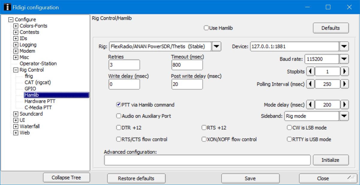

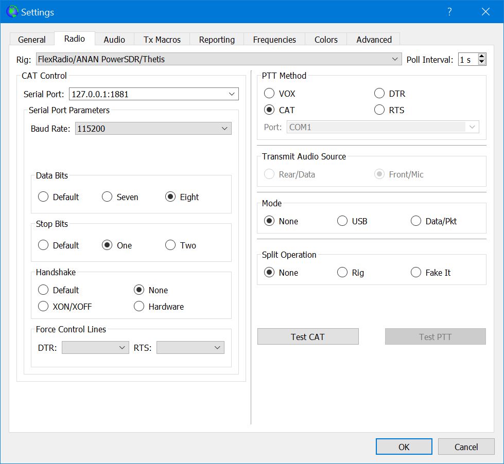

Today I went all-in on setting up my commonly used app's to use TCP/IP. Anything with Hamlib works great. You just have to know the secret squirrel stuff, which is to type into the port setting box IP:port, e.g. "127.0.0.1:1800", or whatever you've got Thetis set to. So right where it says "COM10" or the like, just type right over the top of it.
So far I have tested this with:
- Fldigi (you do have to select Hamlib as the method)
- WSJT-X
- JS8Call

Examples (Thetis is running on the same PC so IP is "localhost", i.e. 127.0.0.1, and I've set my port to 1881 in Thetis):

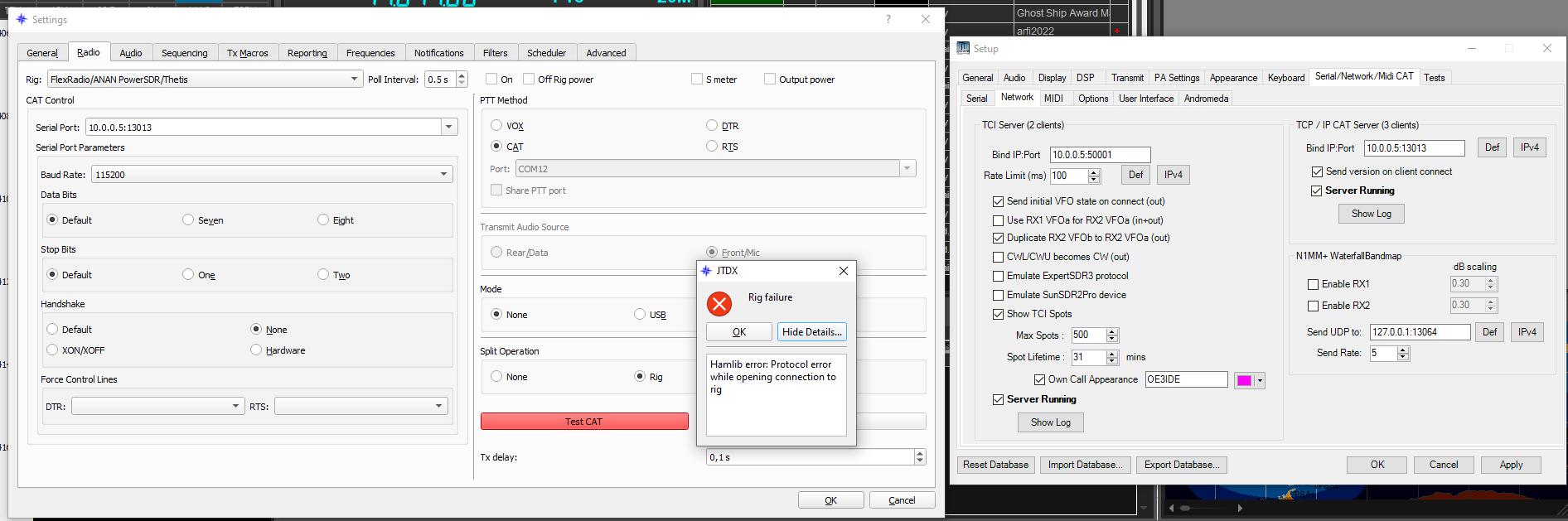

Hey,
just tried it in JTDX (2.2.160-rc1) with no luck (see screenshot below).
Any ideas?
Any ideas?

Try using 127.0.0.1 instead of 10.0.0.5
Re: Hamlib enabled app's can now use TCP/IP (WSJT-X, Fldigi & others)
That does not work for me unless I set this also in Thetis.
I need 10.0.0.5 because I am accessing Thetis also from other PCs in the network.
I just installed JTDX 2.2.159 64 bit (16 bit audio) on Windows 10.
It worked fine with both 127.0.0.1 and 192.168.1.xx addresses, depending on how I had Thetis set up.
Ernst: perhaps take a look at the firewall settings on all of the involved PCs.
Very strange. Just tested 127.0.0.1 (127.0.0.1:13013 in Thetis and jtdx) => same error msg
Tests without success so far:
Selecting TS2000 instead of Flexradio/Anan-PowerSDR/Thetis has done the trick
That's not making a lot of sense. My tests were with the Flex/Anan/Thetis rig type.oe3ide wrote:Very strange. Just tested 127.0.0.1 (127.0.0.1:13013 in Thetis and jtdx) => same error msg
Tests without success so far:EDIT:
- reverting back to jtdx-2.2.159-win64
starting jtdx with an empty data-dir
Selecting TS2000 instead of Flexradio/Anan-PowerSDR/Thetis has done the trick![]()
Are you certain you are running with TCP/IP? It's easy to accidentally run with COM ports. The only way to be sure is to disable them in Thetis.
Yes, I know it makes no sense
But these are the settings in the ini:
As soon as I stop the TCP/IP-Cat server in Thetis, I get the cat-error msg in JTDX. So its definitive connected via TCP/IP-CAT.
It works with TS-2000 and TS-480. But does not work with Flexradio6xxx or Flexsdr 1000 or Flexradio/Anan powersdr/Thetis
There is a setting to turn off the startup message. I’ll check when I get home.
Turn off the "Send version on client connect".
