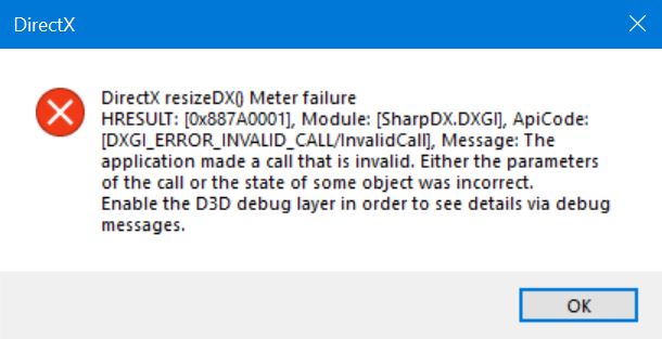

Getting a directx resize error
- direct xerror.png (40.58 KiB) Viewed 69620 times
Re: Thetis v2.9.0.8 - meters and then some more
Tony, can you try something quickly.Tony EI7BMB wrote:Getting a directx resize error
1) shut down thetis
2) rename Meter folder in C:\Users\<user>\AppData\Roaming\OpenHPSDR to Meter2 or something
Hi Richie, tried that. It adds the meter ok but when I try to re size the error message appears.
ramdor wrote:Tony, can you try something quickly.Tony EI7BMB wrote:Getting a directx resize error
1) shut down thetis
3) start up thetis and try adding a signal strength meter
ok, you can rename that folder back to Meters. I wont be able to do anymore until Monday/Tuesday unfortunately Tony. I will have to get you a test build so I can get log some values out of that resizeDX() function. Out of curiosity, are you using embeded cpu gpu, or external graphics card like an nvidia or amd, what model? Also are your gfx drivers updated?Tony EI7BMB wrote:Hi Richie, tried that. It adds the meter ok but when I try to re size the error message appears.

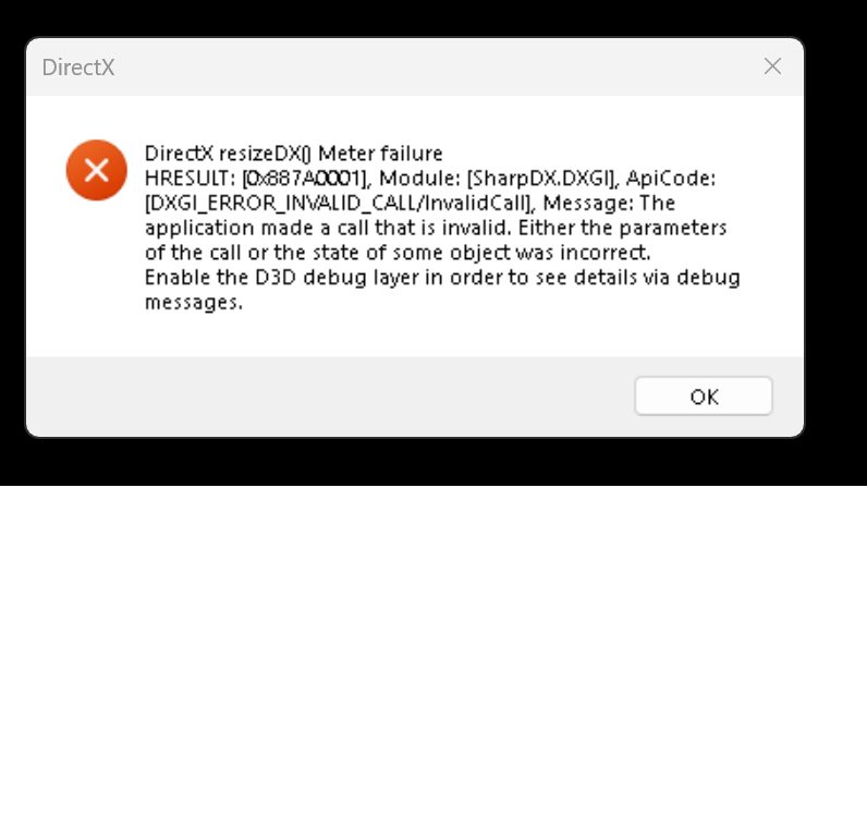

Not working at all for me here, I'm afraid
Compared to the version I built from source (back on 25 Feb to give some idea of what might have changed):
- A meter container does not maintain it's aspect ratio. You can resize it in ways that make the meters highly distorted.
- A meter container cannot be vertically resized to remove empty space.
- Setting up a container causes random error pop ups that look like Tony's.
- While manipulating a meter container Thetis randomly crashes or the UI locks up (but the spectral display and audio continue to run).
- Most interestingly, I'm seeing the failure to render in time red square warning occasionally, something that has never happened before on any version of Thetis with that feature.
Please let me know what I can do to help debug.
This appears to be all DirectX related. DxDiag output attached.
- DxDiag.txt
- (158.55 KiB) Downloaded 1204 times
@scott, if you have been using other versions, can you try with a fresh db? probably wont help, but just a stab in dark atm. In about an hour I am away from here, so will have to wait until next week to track this resizing issue down.
Adding to the above...
Starting from a reset database does not help.
With a meter container already defined sometimes Thetis will freeze at startup and then ultimately quit.
And here's another warning I saw in addition to the one Tony posted:
This was all working beautifully on 25 Feb. However it is worth noting that Microsoft pushed a .NET update to Windows 10 machines after that. Not sure that matters, just dredging up all available info.
No worries about schedule, Richie!

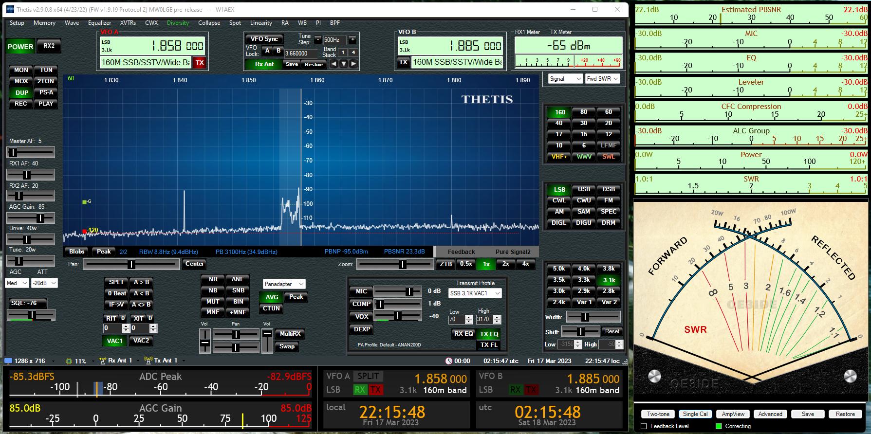

A beautiful software release Richie! Thank you for all your work on developing the meter interface and all the scaling that had to be done for this massive project. Also kudos to Ernst for all the time invested in developing the beautiful graphics for the cross meter, the assortment of analog Kenwood meter skins, and the magic tuning eye skins. Definitely NOT a trivial piece of work there!

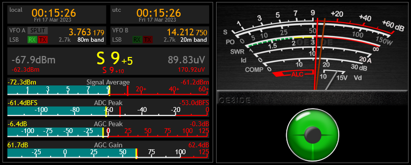

With the little time I've spent with the update this morning, the only suggestion I have for consideration is a dockable container option, vertical edge meter option, and possibly an option to automatically hide metering functions that don't apply to a specific operating mode.
Just a quick comment about the 6E5 "magic eye" tube emulation. I own a ca. 1954 Central Electronics 20A transmitter that uses a 6E5 tube to assist with making adjustments to maximize transmit output level. With the flip of a switch, it also functions as a carrier null indicator in SSB mode. The 20A was one of the first commercial SSB transmitters to use the quadrature phasing method of producing a suppressed-carrier sideband transmission.
I noticed Thetis' magic eye emulation works the same way: for example, with S-meter signal strength greater than S9, the bottom portion of the eye overlaps onto itself with the overlap being a higher intensity green color.
Anyway, great job in making the magic eye function work so well.
