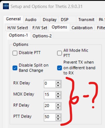

What do these settings look like?
Screenshot 2023-06-11 200910.jpg (37.67 KiB) Viewed 4169 times

I tried your settings. Then rebooted Thetis. Clink appears to be gone. We'll see if it stays that way.
Thank you!

My settings were not the end all and be all, but work for me in the way I run my station. You may need to tweak. I think you were hearing a few mS of RX and TX overlap and thus feedback.

I have been having the same problem. I was able to get the problem to repeat itself fairly consistently. The first fix was to cycle the power tab on Thetis. Finally, under Setup>General>Options>Option-1, I adjusted RX Delay until the problem went away. I could shorten the delay and the problem would reappear. I finally settled on 40 for the delay.
