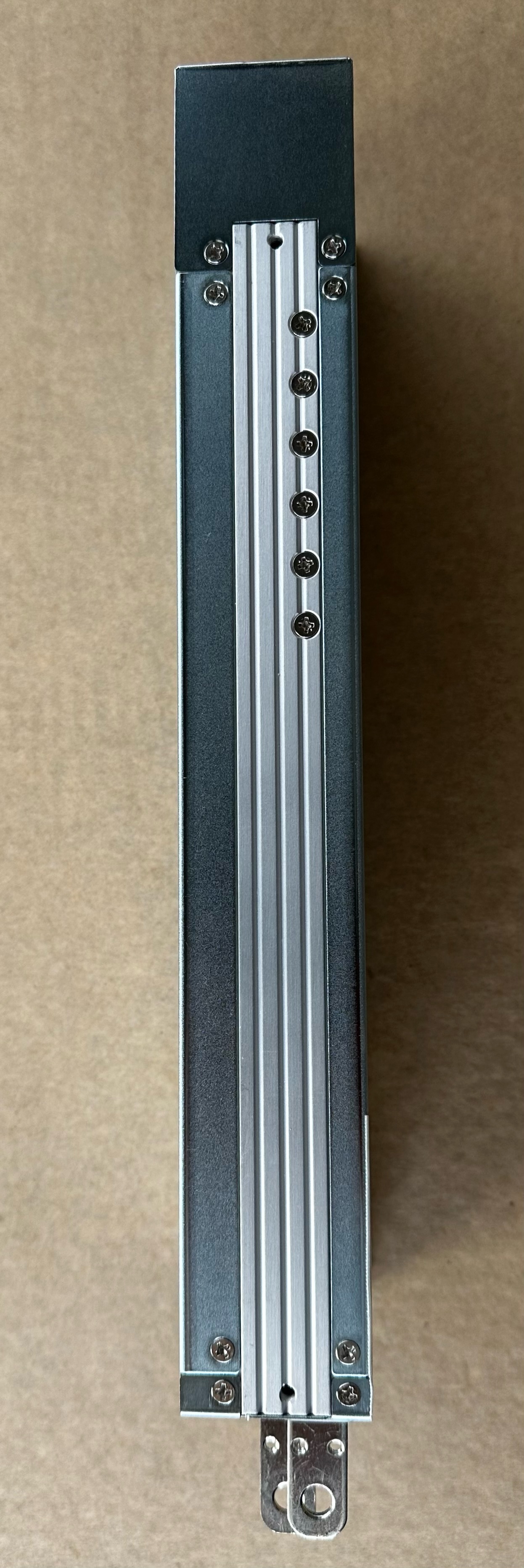

I got some more information.
The dimensions are 30cm L x 8.5cm W x 4 cm H
Fans are temperature controlled.
It's a non-standard Meanwell supply with modifications to make it RF quiet and quieter fans.

Thank you again for your prompt response with photos and dimensions.

Of course the modifications are already made.
The power supply is designed to handle full power -- 48V at 40A is 1,920 watts and Meanwell power supplies are very efficient at around 90% so plenty of power. The 1000W on the rig is only for CW or Voice -- not FT8 for example which is limited to 500W so doesn't push the power supply in either mode. Since the power supply is rated for 48V/40A that should mean it can do that 100% duty cycle -- though the fans will have to work a lot harder. It's just that the rig itself can't do 100% duty cycle at 1000W.
I don't see why would need a 2nd supply.
