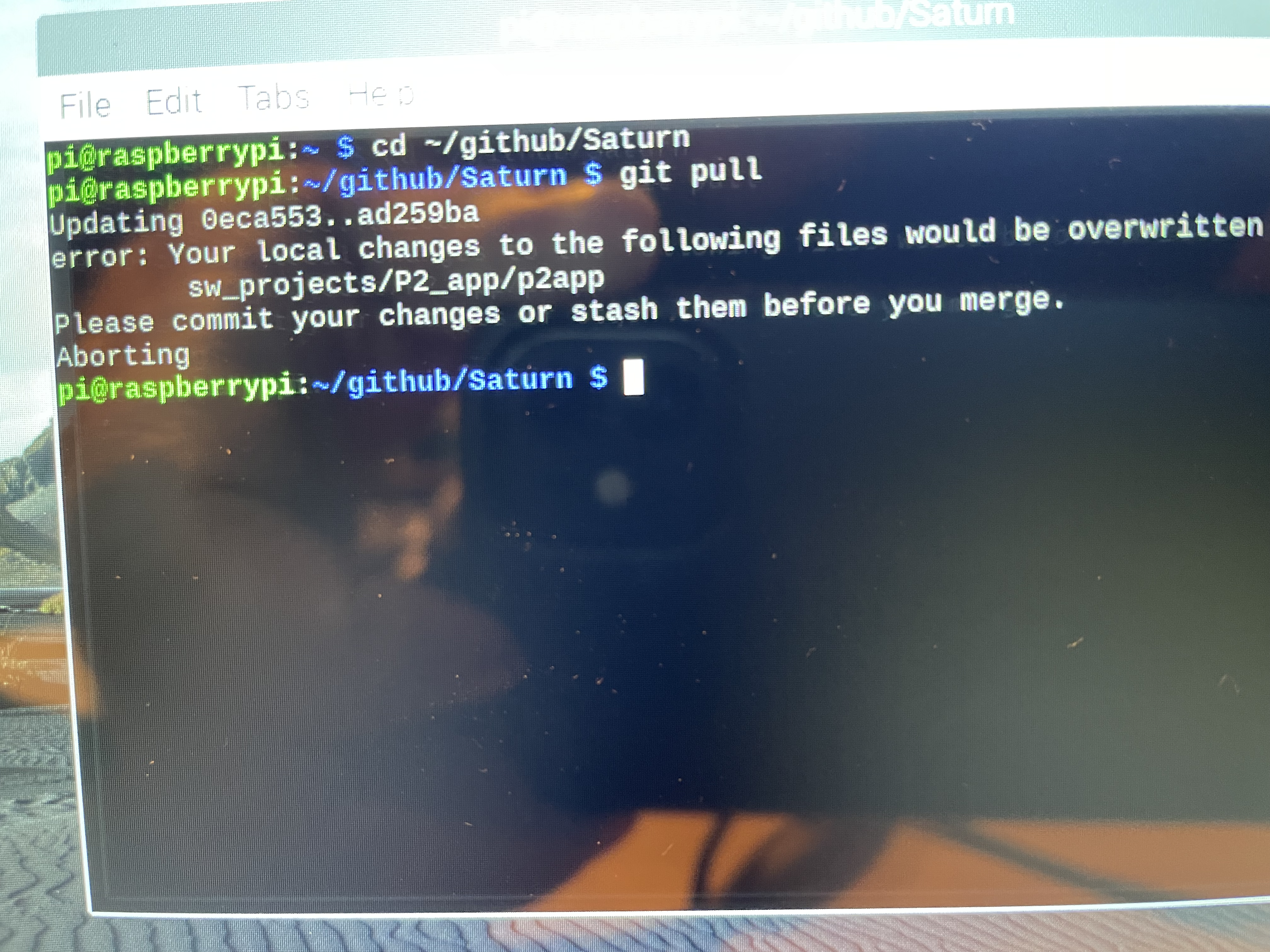

Re: G2 Software and Firmware Updates 27 Aug 2023
I managed to update manually, deleting the files that weren't needed. I have FW 8 now, and WDSP 1.23. I was getting merge issues. Isn't "make clean" supposed to take care of that?
John
N2KBE
John
N2KBE
Make clean removes files created in the build process. The merge issues suggest there are files in the folder that aren't the same as was in the git repository. normally there is a hidden file ".gitignore" that tells git to ignore build files but it's possible that isn't ignoring everything.
doing make clean first then git pull might have a different result?

download/file.php?mode=view&id=3730
yesterday my piHPSDR update was succesfull, but git pull of Saturn FW/p2app failes due to this attached error. Any idea?
TNX
Volker
TNX
Volker

laurencebarker
- Posts: 335
I suspect you have done a git pull, built the code (creating a new p2app executable) then done a git pull again.
delete p2app executable and re-do git pull
laurencebarker wrote:I suspect you have done a git pull, built the code (creating a new p2app executable) then done a git pull again.
Thanks from me Laurence, realized I had same error as Volker, I just renamed it and everything fell into place.
Thanks again for you help!
Richard
Hi Volker,dl4zbg wrote:https://community.apache-labs.com/download/file.php?mode=view&id=3730
TNX
Volker
In this case you can perform a 'git stash' before the 'git pull' to save your current directory.
Use git stash when you want to record the current state of the working directory and the index, but want to go back to a clean working directory. The command saves your local modifications away and reverts the working directory to match the HEAD commit.
73 Bernhard , DL1OF
Right now, my screen looks like your screen save of the error.KI4P wrote:laurencebarker wrote:I suspect you have done a git pull, built the code (creating a new p2app executable) then done a git pull again.
Richard
Please clarify what you mean by "I just renamed it and everything fell into place". What did you rename?
Tnx Torrey N9PY
I just went into the folder that had the p2app executable in it and renamed that one file. And gitpull didn't see it and got the new file
Richard - KI4P
