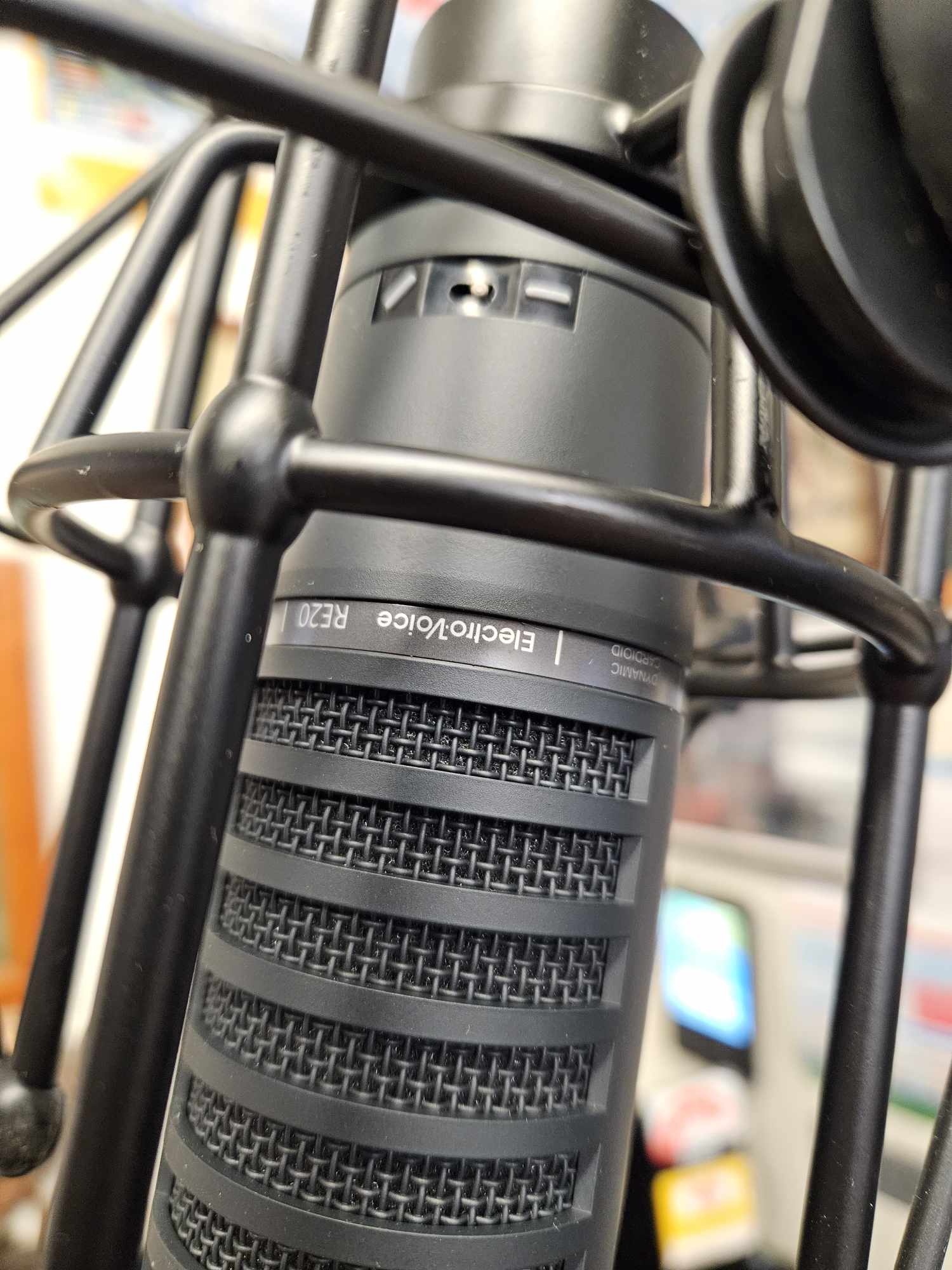

That's a hell of a microphone!
The reason you have to turn down the mic gain so much is because you are feeding the output of a mic preamp into another mic preamp.
You might consider just using a 48V phantom injector by itself. If you are hard over on using the tube preamp then consider using a direct box (transformer) to feed the line in input.

Audio Test App G2 with face,but slight echo on transmittion.
Reminder those that have the G2 with face you need to exit piHSDR before you can do the Audio test using the App.This rig has a very small card and computer and can get bogged down, if you load up too much it can freeze.My audio was perfect on the test but a small echo on transmitting , Ive tried new shielded Mike leads with chokes and checked many leads and unplugged to locate rf but no luck yet.Not using amp until sorted.The upgrade firmware and P2 App went well.Anyone out there have the G2 with face,I would like to hear from you as to your experience.I believe no one in Vk has one with face,the few with out face are using Thesis,I decided to explore the stand alone capabilities first,Its got great receive.
