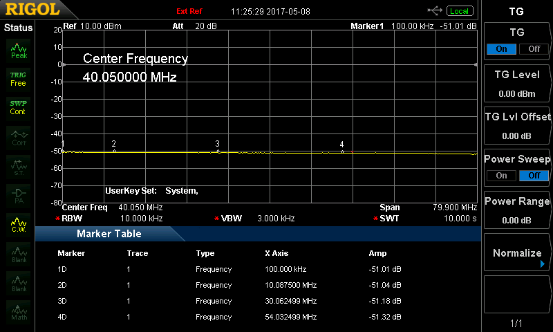

I'm currently testing a sampler based on the one described by VK1HW. I use an Amidon FT 50-43 toroïd with
32 turns of 0.4 mm enameled wire and same resistor divider (10/39 ohms)
The test on an almost breadboard assembled piece gave the following result on my spectrum analyser;
between 100 kHz and 80 MHz it is pretty flat. Of course this to be tested under a full kilowatt to make sure core
saturation does not degrade the caracteristics. SWR is max 1.1 at 54 MHz and insertion loss is 0.12 db @ 54 MHz.
This test is with simple RG58CU coax. I ordered some feet of RG142 m17/60 coax (cost me an arm) to test it at high power.
See photo
- Sampler 51 dB 500 kHz to 80 MHz.png (55.62 KiB) Viewed 17555 times
