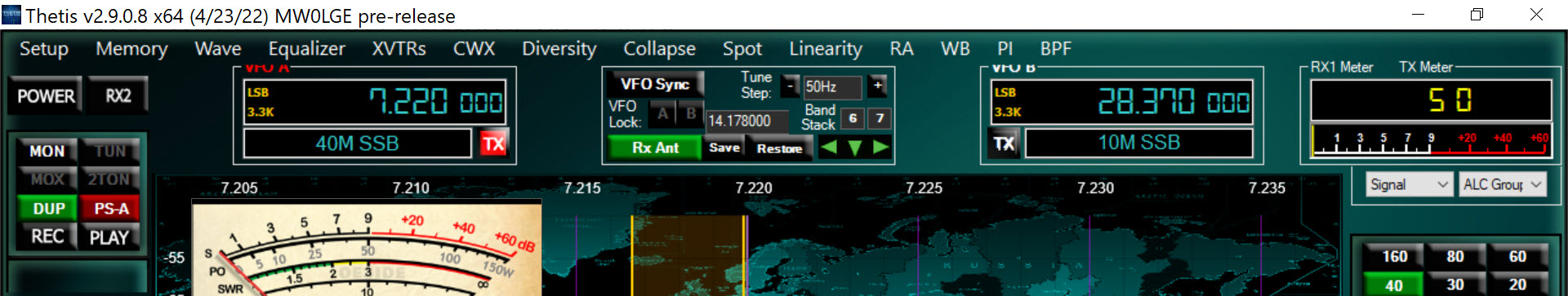

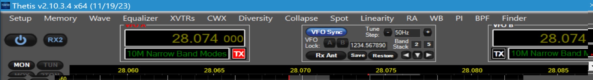

I noticed just now that VFOA and VFOB windows aren't showing correctly. Not sure why I see this only now (it has been there all along), but I wonder what causes this? See image below.
Re: VFOA and VFOB windows not showing correctly

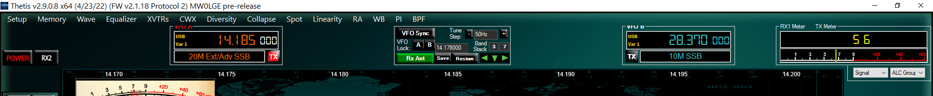

No problems here.JJ4SDR wrote:I noticed just now that VFOA and VFOB windows aren't showing correctly. Not sure why I see this only now (it has been there all along), but I wonder what causes this? See image below.

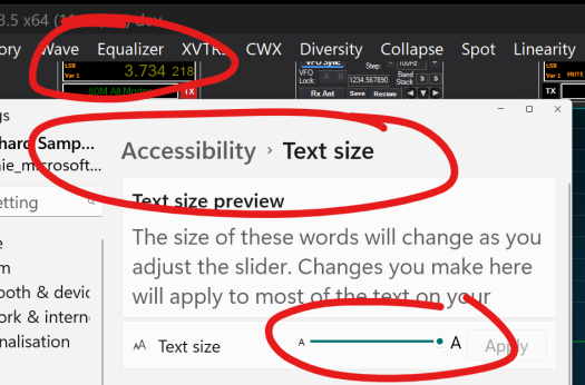

I guess this Windows setting is involved:
Start > Settings > Accessibility. Select Text size

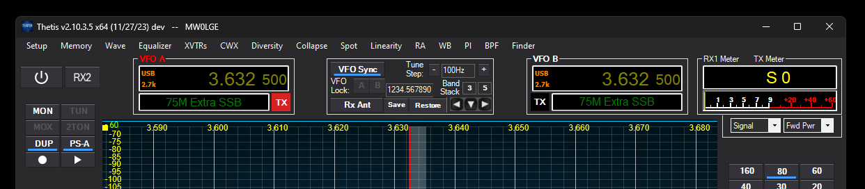

Screen capture this area and post image. Include the window title bar, menu bar, and vfo boxes
Well here is mine if it is any help.
Terry. GW4NNO
Terry. GW4NNO
- Untitled.jpg (113.31 KiB) Viewed 34360 times

Hello Richie!
Sure appreciate and value the video.
I have been on Windows 10 for over 2 years and never had this issue before. Tried scaling at 150% and it didn't really remedy the glitch, but Thank you again for taking time to put together this video
! Below, see image.
Cheers!

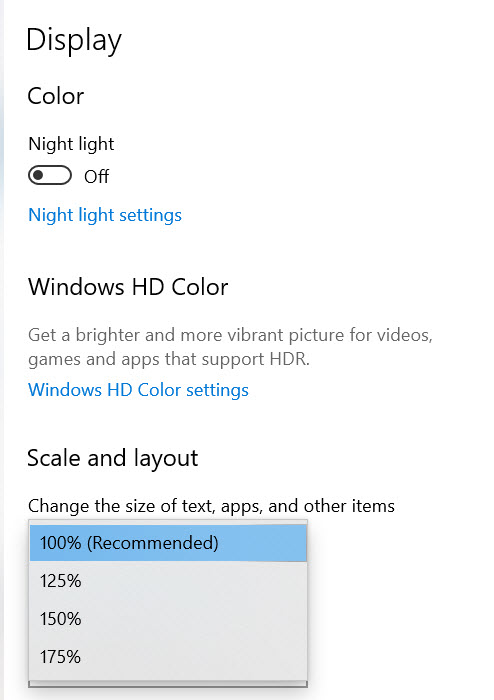

what scaling are you changing? show me the setting + slider you are setting to 150%.
I guess Windows 10 doesn't have such a slider.....
In that image you are probably changing display scaling, not just the text size.
In windows 10, go to start button, select settings, ease of access, display. Use slider Make text bigger. There is another slider that 'Makes everything bigger', ignore that one.
https://youtu.be/01pzenMJiQw
