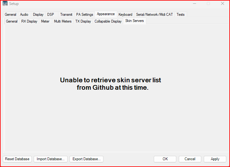

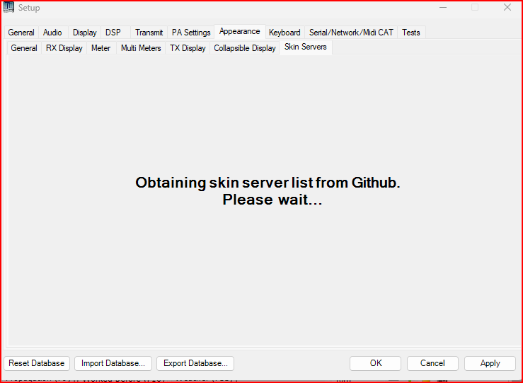

I am running Thetis V2.10.3.4 X64 and cannot access the skin server on my desktop and laptop.
When I go to setup and skin servers after the initial msg "Obtaining skin server list from GitHub" it waits 30-45 seconds and I get the "Unable to retrieve skin server list" msg.
Here are the screenshots
Please suggest if I am doing something wrong.
Thetis skin server obtaining.png (18.32 KiB) Viewed 16432 times

Thetis skin server unable.png (16.61 KiB) Viewed 16432 times

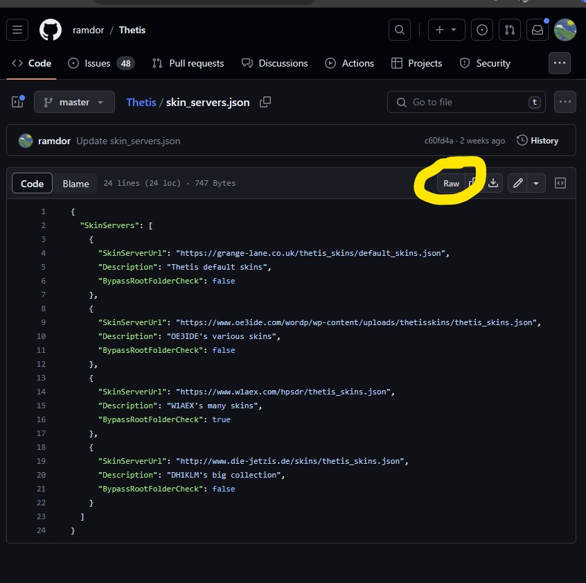

I can see the skin server raw file here
https://github.com/ramdor/Thetis/
skin_servers.json
When I click on it I can see the raw file. I don't get what to do with this file.
Do I need to put the URL somewhere?

what happens when you access the RAW in github by clicking the button circled :
