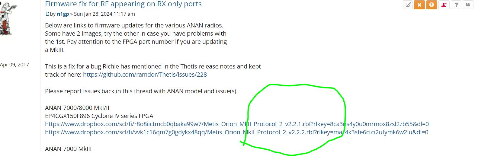

I just update my ANAN-7000DLE MKII to the new firmware "Firmware Ver: 2.2.2"
and no communication with the radio.
Any help Please
Nir
4X1FK

Did you use the right firmware? What FPGA is inside your 7000 (you can tell by what version firmware was in their before)? See these links for reference:
viewtopic.php?f=32&t=4462
viewtopic.php?f=32&t=4972
Assuming you did load the correct firmware, other common errors/problems include:
- Leaving the bootloader switch in the wrong position
- Failing to power cycle the unit after moving the bootloader switch
- Intermittent Ethernet cable that went bad after moving it
