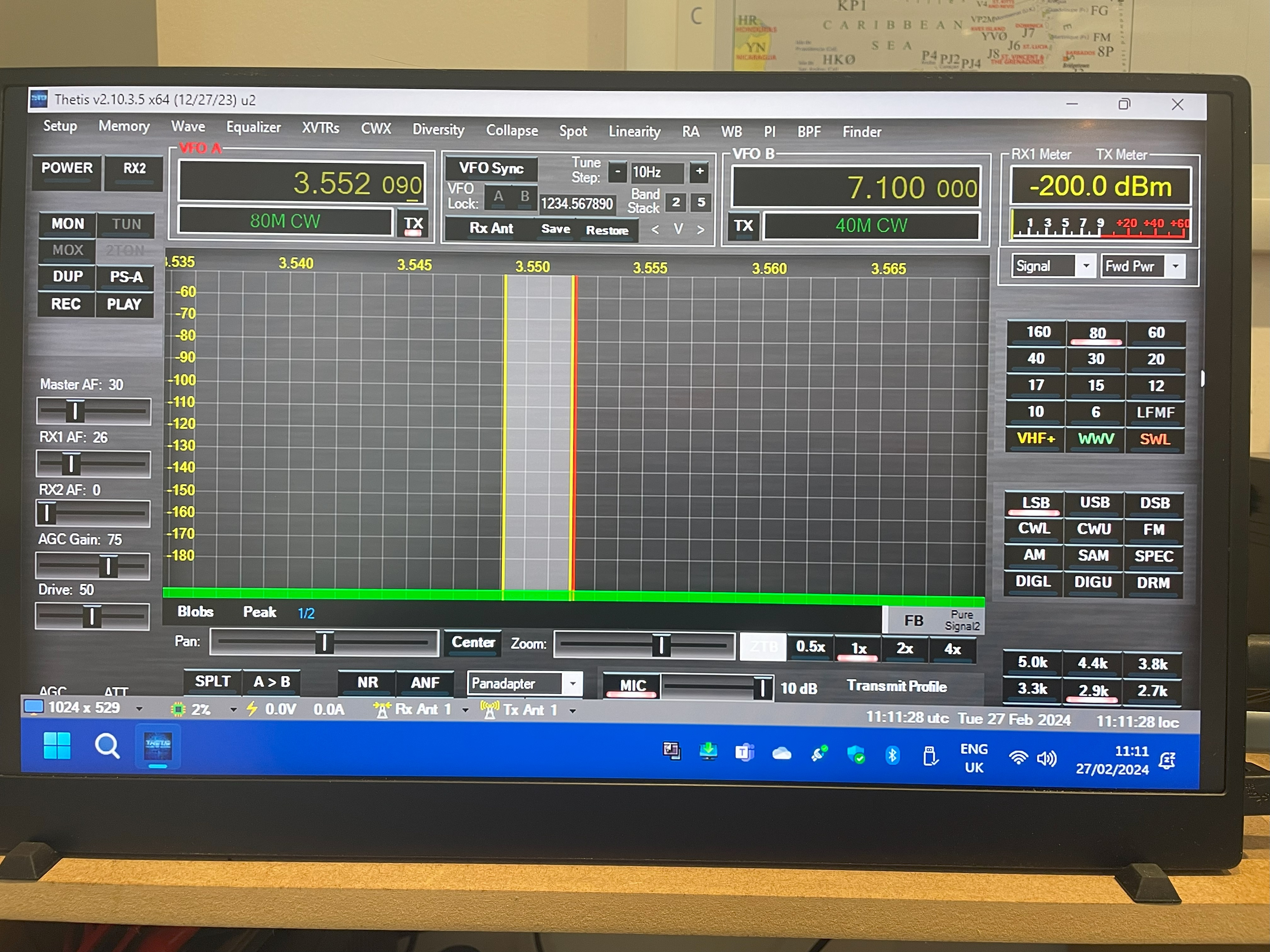

I am working on a new SDR transceiver project I call it 'Hermes Heavy' it is based upon a 16bit Hermes board see pictures attached.
The single board computer is https://www.lattepanda.com/lattepanda-sigma
The 7 inch display in the case is https://www.waveshare.com/product/displ ... 024600.htm
The 15 inch second display is 15.6 inch 4K monitor (seeedstudio.com)
While doing initial tests with the SBC and the displays I have noticed that the Thetis display is truncated and the bottom on both displays 7 and 15 inch.
I have tried changing the display resolution on the Thetis status bar and the display resolution and % size in windows but cannot get the full Thetis display on these smaller monitors.
My friend G4URH has also done tests on his 10 inch monitors using Thetis and has seen the same effect with no way of achieving a full screen?
I think we may be missing something but we do not know what! After all some of the Anan products have 7 inch displays and as yet we have not seen any issues raised in respect of the above.
Have any of you seen this issue before?

Right Click on the Task Bar ( Windows) and select Taskbar settings. Under actions, select "Auto Hide Taskbar ". Exit out of the settings and when you run Thetis the Taskbar should disappear until you put your cursor on the bottom of the screen. Then it will pop-up if needed.
Re: Thetis and display truncation
The minimum allowable size of a Thetis window is 1018 x 609 pixels. If your display cannot provide that much screen real estate then you are out of luck. James' idea is a good one to obtain more space but it appears that the 7" display you chose will still not meet the requirements since it is a 1024 x 600 display, whereas the 7" screen that Apache chose is, IIRC, 1024 x 768.
On the 4K display the problem is most likely that you have the Windows scale and layout settings set incorrectly. Go to Settings > Display in Windows and make the appropriate adjustments. Note that a lot of folks have trouble with scaling set to 125%. On my 4K display I have it set to 150% and that seems to work fine.
You can use the Thetis collapsed mode. That works on a 7" 1024x600 display.
The Andromeda display was 1024x600. You can have a single screen display at that size, but only in "collapsed" mode.w-u-2-o wrote:The minimum allowable size of a Thetis window is 1018 x 609 pixels. If your display cannot provide that much screen real estate then you are out of luck. James' idea is a good one to obtain more space but it appears that the 7" display you chose will still not meet the requirements since it is a 1024 x 600 display, whereas the 7" screen that Apache chose is, IIRC, 1024 x 768.
The attached picture shows the display on Andromeda's 1024x600 display in collapsed mode. The Andromeda top and bottom bars are selected.
