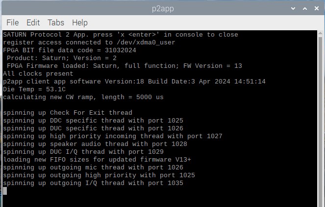

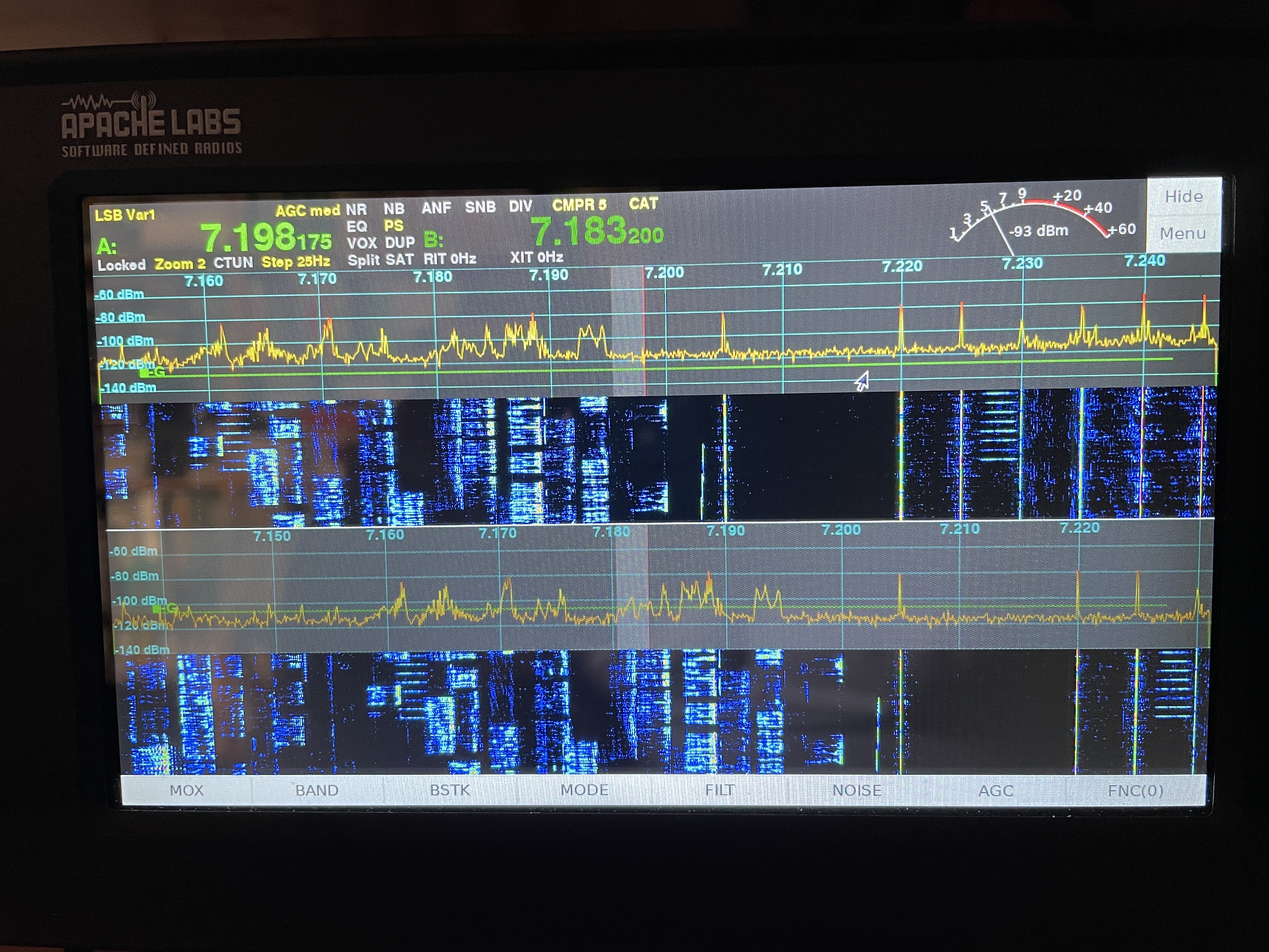

I just tried using the 2nd rx, but didn't get spectrum, waterfall or audio. All I got are grey and black fields below rx one. Will later try pihpsdr on M1 Mac too.
Running Saturn f/w 13 and pihpsdr build from 2024-04-03.

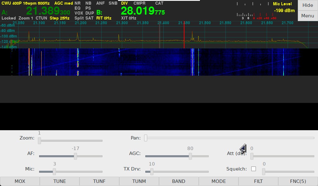

I am using built 2024-01-26. I can run 2 receivers at 192000 without problems. Second RX is assigned to VFO B. you can change to RX2 (activate) by clicking on the spectrum. The S-meter and headphone audio are always related to the active RX. Split is working as well.

Disable Diversity!

Diversity was enabled. Why? I never enabled diversity! Problem solved :-)
