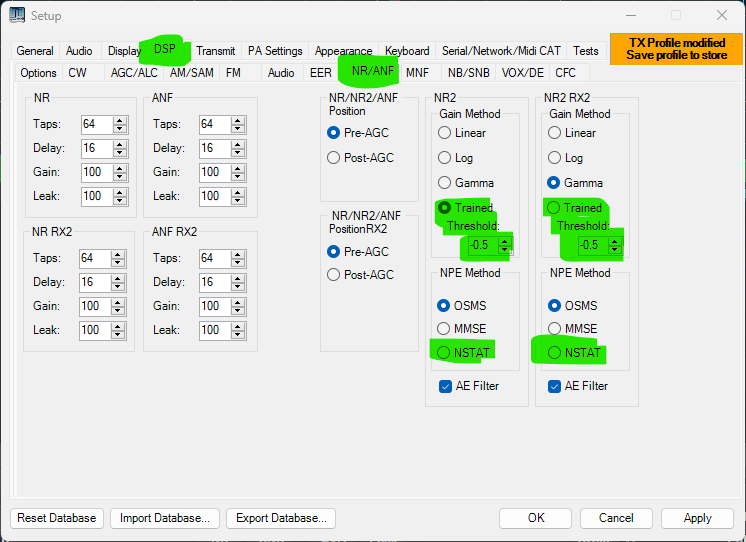

I changed the settings in this screen and it seemed the audio was a bit clearer. But, I had to raise the AGC level because I could still hear background hiss in the audio.
I will keep trying different settings just in case there is something I have missed.

I have found that by using the Trained Threshold (at the default -0.5), any noise is reduced even when setting the AGC threshold down well below the noise. Using Gamma at that AGC threshold always resulted in some noise.
Currently running the trained threshold and NSTAT method, seems to be OK.

If you haven't yet tried the Trained Threshold version of NR2, make time and do so. You'll be amazed. I haven't tinkered with the Threshold setting much yet, but with the default at -0.5 it is - well, I already said it - amazing.
Setup-DSP-NR/ANF tab - click the radio button for Trained Threshold in the NR2 panel.

After playing some more, I have dropped the trained threshold to -3.0, which is adequate to remove just about all noise, but will allow for very low signals to still come through. In addition, the Auto AGC is not set to 3, which is much lower than I could run before. This also helps with low signals, and you can get away with it all the time with the improvement in NR2 performance.
Doug
