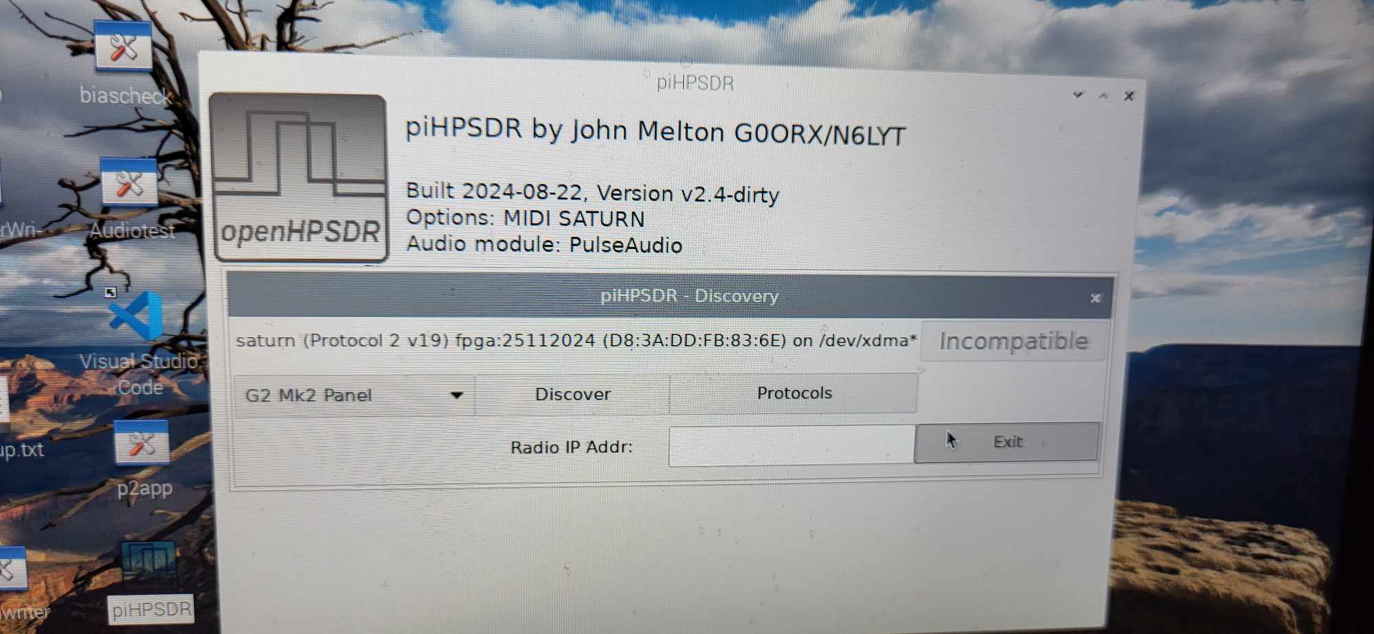

Even if i use my G2 ULTRA with Thetis I just find out that PiHPSDR can't be start anymore after i have update PiApp Firmware from V10 into V19.
Curious ???
Apparently i'm not alone having this problem .
73's Michel VE2XK
PiHPSDR not compatible with PiApp firmware V19

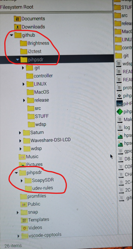

VE2XK-Michel
- Posts: 16
- Joined: Wed Nov 27, 2024 10:52 pm
Re: PiHPSDR not compatible with PiApp firmware V19
Hello Laurence,
After i have email Christoph DL1YCF . apparently Appache Lab have very probable make some miss take by instaling the software on my G2 Ultra and even on the one from TF1A and probable other too .
Miss take from the factory ???
Why ? There is apparently 2 directory or folder where PiPHSDR is to see and to find and it is probable wrong .
That will also explain why the Firmware apprear to not be compatible because a update of PiHPSDR are probable not made on the right place .
On my G2 Ultra i can find PiHPSDR under the following path or route :
home/pi/github/pihpsdr
and the other :
/home/pi/pihpsdr
So go figure why that don't work and what i can do . The procedure i have try several time like describled don't work for some reasons and bring
alway incompatible PiHPSDR with my new lastest firmware .
The question is how to fixe that ?
See picture
73's Michel VE2XK
Hi Michel,
I ran into the same issue, so here is the (simple) process to make it work:
1. Update the firmware to the latest version (19)
2. Shut down the radio - completely. This means pushing the power button for 5 sec after Linux has shut down.
3. Restart the G2 Ultra
4. Now get the PiHPSDR manual from Christop's repository
5. Update PiHPSDR as per the manual. The script pretty much takes care of everything, but it takes a while to complete.
Don't worry about the two PiHPSDR directories. The install script will only use one of the directories and it will place an icon on the desktop. Double clicking on the icom selects the right directory and you should see PiHPSDR starting up.
Note that the P2app should not be running when you start PiHPSDR. The P2app is currently only used with Thetis.
I had it running very well here, but I have to send the radio down to Doug because of a couple of problems likely with the FPGA.
73 de va7qi, ....Erik.

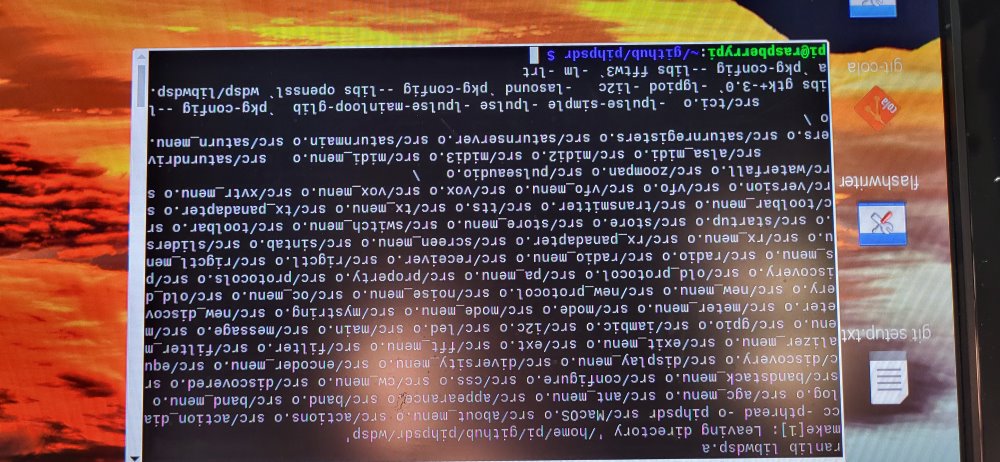

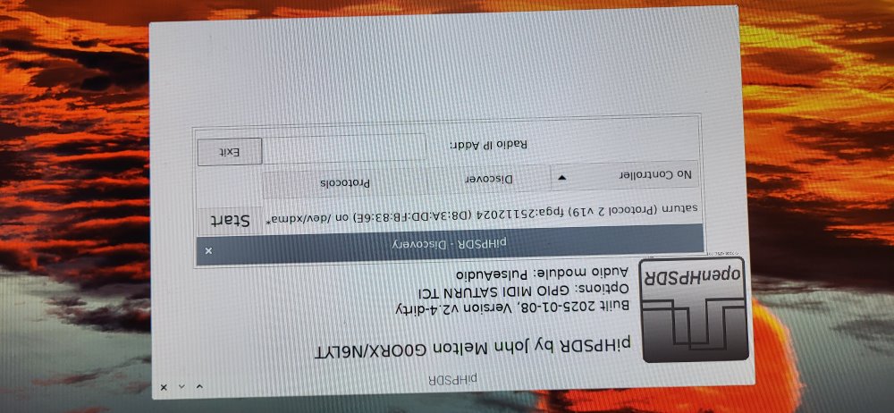

Hello guys,
I just want to let you know that I finally solved the PiHPSDR update problem with the help of Christoph and his new script.
This problem have bring a big discussion because the script specified in any manual was apparently not adequate to update PiHPSDR to the latest new version for the G2 ULTRA.
First problem fixed . Finaly .
73's Michel VE2XK
73's Michel VE2XK
