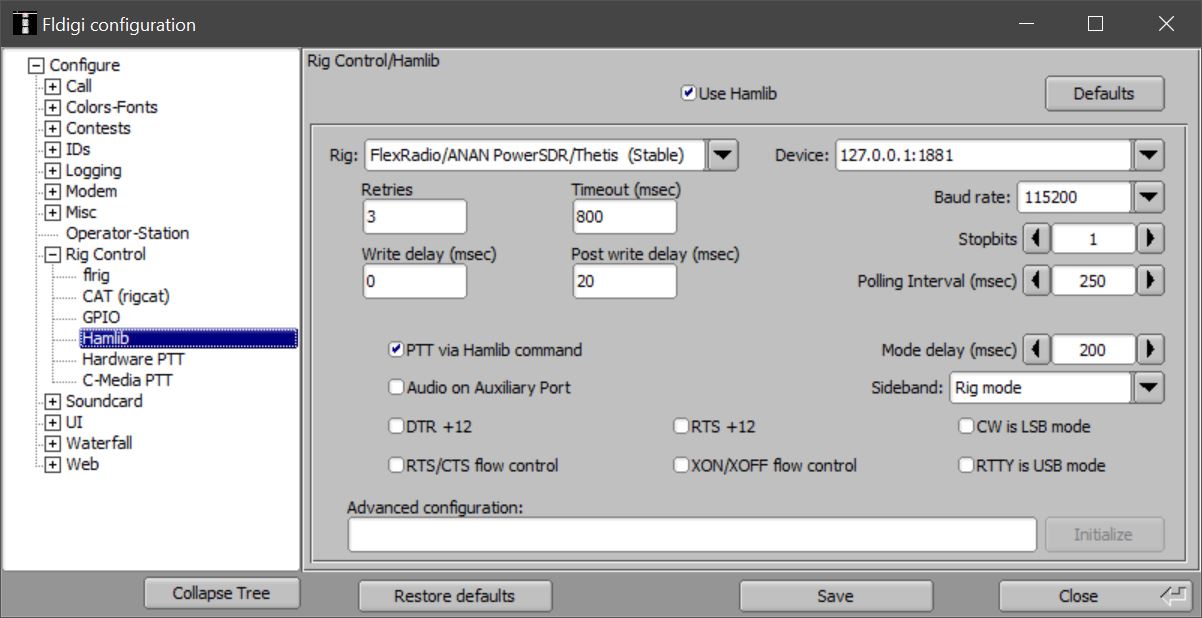

Ruben--I just upgraded my version of Fldigi to 4.2.0.6 (the release version, no .17 on the end). I can't duplicate your problem. However I may be setup differently from you. In particular I don't know what "Fldigi UDP" is.
In Fldigi I have rig control set up as follows:
Rig type "FlexRadio/ANAN PowerSDR/Thetis (Stable)
Device 127.0.0.1:1881
PTT via Hamlib command
Sideband Rig mode
The rest of it doesn't matter.
In Thetis I have the TCP/IP CAT server enabled with a bind port of 127.0.0.1:1881
You can, of course, use the default port number, there is no magic about using 1881.
Note that all app's that use a recent version of Hamlib can be set up this way, there's no longer any need for virtual serial ports.

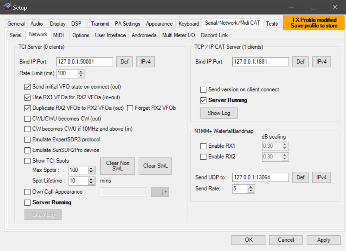

You may have configured it wrong, or maybe there is a Windows firewall issue. Here are some screenshots from my setup.
The hamlib page does support TCP/IP. All app's that use hamlib support TCP/IP as long as they use a version of hamlib newer than June 2022. See this topic: https://community.apache-labs.com/viewtopic. ... 49&p=28188 (thank you Mike, W9MDB!)

Fldigi offers a choice of flrig, hamlib, and rigcat. Here's my setup in Fldigi.

Oh I see and understand. That being said I see in your previous captures the Thetis page for configuring the IP address. Where is the second capture from?w-u-2-o wrote:Hamlib is a software library that can be used by app developers to enable CAT comm's with a huge list of radios. It is not a separate app. Hamlib is used by Fldigi, WSJT-X and numerous other digi and logging app's.

I posted screenshots from Thetis, WSJT-X, and Fldigi.
