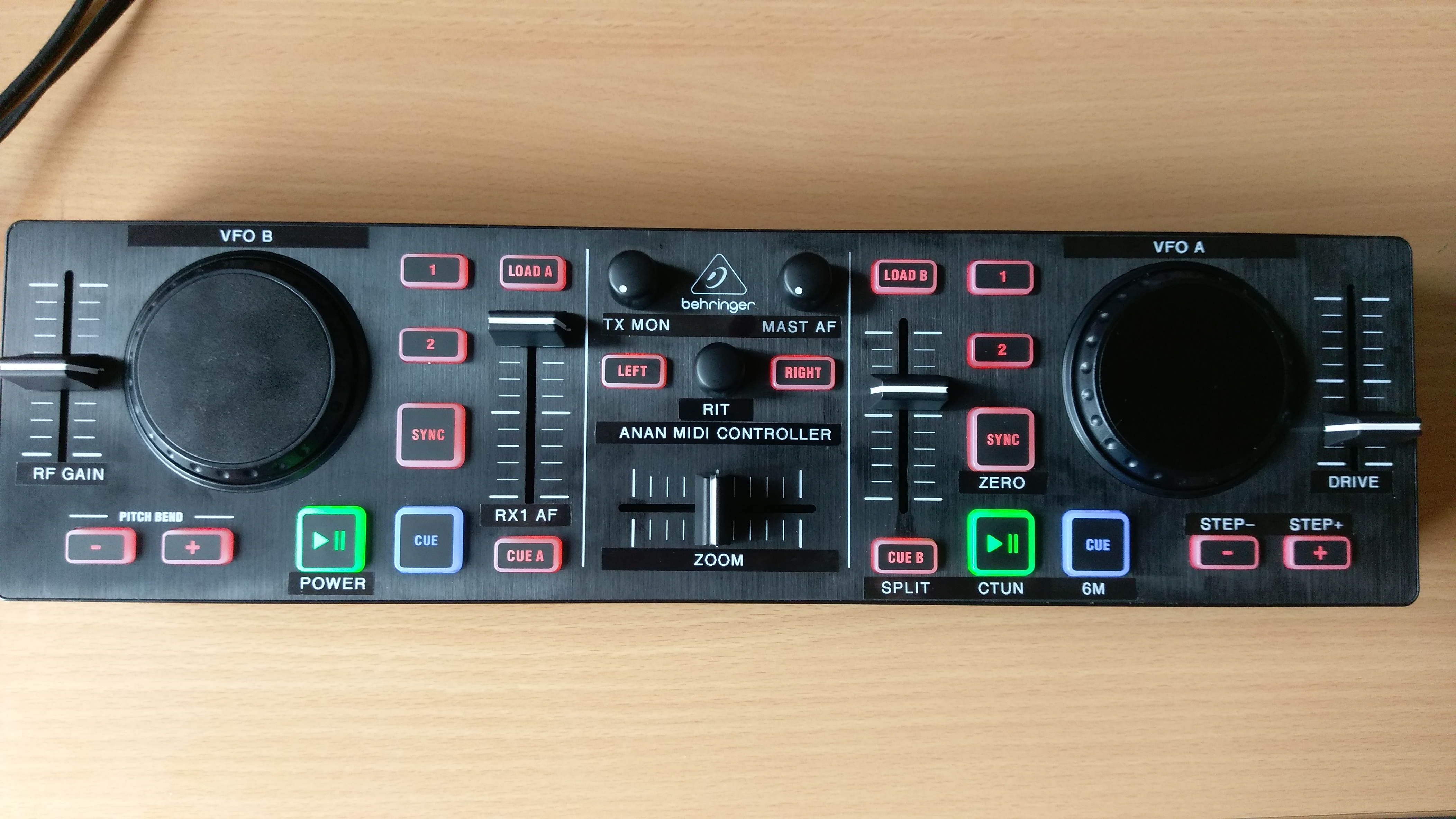

I have been using this for a while now and the multi speed VFO tuning is excellent, thanks Chris. Took me a while to get the correct white on black labeling and I've attached a photo to show how it looks so far.

Very nice, neat and clean labeling job, Tony!
Question: why not put the labels directly on top of the buttons, thereby hiding their original markings? (That's what I do
Re: Behringer CMD Micro installed
Hi Scott , I had thought originally about doing it that way but the "Step + " was just slightly too long and labels for sliders have to go below anyway so decided to keep it as consistent as possible. The label will not get worn out either with my constant finger pressing . Going below the button allows you to have one label across 2 or more buttons which makes lining up that bit easier with less cutting. All down to personal preference and experimentation I guess

Tony, very nice.

Sorry for the delayed response but it looks great, Tony. I chose to put the labels on top of the buttons and find it works fine, but of course blocks the existing lit-up label. This is fine for me and avoids confusing dual labeling. The one exception is I kept the "Sync" button as-is and mapped to the VFO sync function.

Thanks Chris , great idea on the sync button, I'll map the one on the left hand side to do that.
